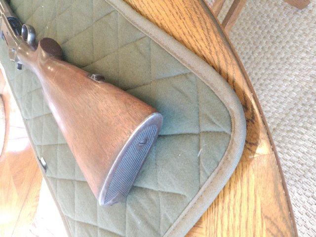

Some pictures. It does have the "E" prefix in the SN.
It looks like someone attached a Weaver choke to it and it looks like something else was previously attached (picture #4 a good view of the attachment points on the barrel).
Robert

My assumption is the attachment points in pictures #4 and #5 were where the bayonet lug and heat shield on the top were attached.
Robert
Correct, a sure sign that a trench gun bayonet mount was originally installed on the barrel, and that the gun was not originally made as a riot gun. It's a shame in this case that the barrel was modified to take the brake/compensator. These guns were not seen as being particularly valuable immediately after their military service, and modifications were common. Unmodified barrels and bayonet mounts are unfortunately impossible to find. There are some nice repro mounts available out there.

Robert, I think it was at one point a Trench Gun but it was converted sometime in its life to a sporter. It certainly looks reblued which I think they probably buffed off the flaming bomb. The stock set is incorrect (both the butt stock and the fore arm), as is the butt plate. Is that compensator threaded or soldered on? Is the hole in the end of the barrel for the front sight? Whats the length of the barrel? Im wondering if they cut it down. Unfortunately it would be a very difficult and costly restoration. Edited by Kilroy
