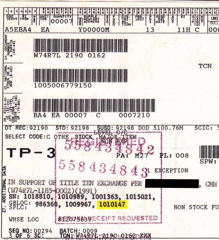

TSMGguy Posted November 7, 2020 Report Share Posted November 7, 2020 (edited) I've seen two Winchester shotgun receipts from the Title X sales conduced by the Anniston Army Depot in 1991. Wish I'd thought to download these, but I didn't. I noticed that the paperwork listed only the serial numbers, not the models. The configuration, trench or riot, was not listed that I recall. Edit: Here's one. Thanks, P.W.Browning: Edited November 7, 2020 by TSMGguy Link to comment Share on other sites More sharing options...
