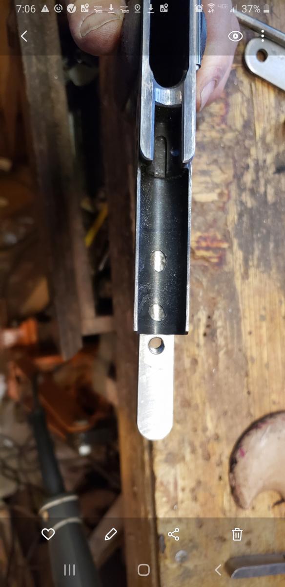

My suggestion is to fabricate a mechanical joint rather than weld one to the frame for many reasons. The radius of the outside forward extension of the 1911 grip frame is easy to duplicate to make and fit a grip bracket for a forward grip. The bracket can be screwed to the bottom of the frame extension through the bottom with two or three screws properly countersunk for the screw heads. The rear spring guide keeps the spring off the bottom of the extension so the screws have a bit of room to be proud of the inside radius. You can make the grip mounting tongue on the bracket as long or short as you want to accommodate the length of the top of the pistol grip. The depth of the bracket will assure a solid connection for the screws and if the tongue is as thick as or thicker than that of the Thompson brackets, the forward grip can be affixed in the same manner as the Thompson. FWIW Edited by Black River Militaria CII
OK so to clarify, the screws used for attachment are going down from inside of the frame into the tapped mount with the head inside the frame?
or going up through the mount and threaded into the frame with the heads countersunk into the bottom side of the mount?
Thanks deerslayer, I just feel like weld might be stronger for handling, with the long front grip providing lots of leverage, over a long term / time of use,
As a NFA Item, I would like the piece to last generations if possible. Appreciate the pictures too.
Any choice of attachment to the frame extension should go from the top down to the bracket. Plug welding is a fine option but must be done correctly for good penetration through the hole into the bracket. I'm old school and prefer the craftsmanship of mechanical solutions. I do a lot of welding for repair of vintage MGs and it has it's place, of course, and in this application my preference would be mechanical.
