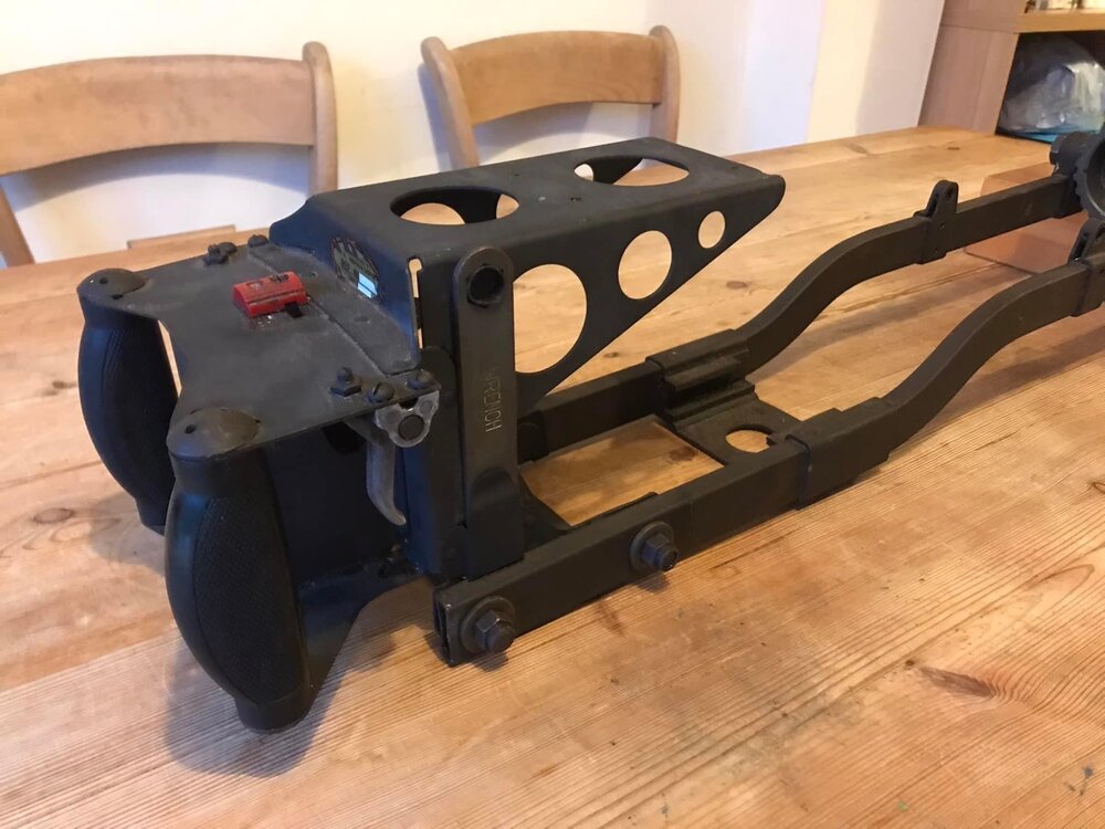

Turrets to toothbrushes Posted November 21, 2023 Report Share Posted November 21, 2023 Hi, sorry to resurrect this old post but I was wondering do you still have this sight and would you be willing to sell it? it’s exactly what I need! I have an E-11 recoil adapter for my .50cal. It’s quite a specific type of sight that only goes on the E11 and the E12 adapters. Here is a picture of my E-12 cradle. Link to comment Share on other sites More sharing options...
