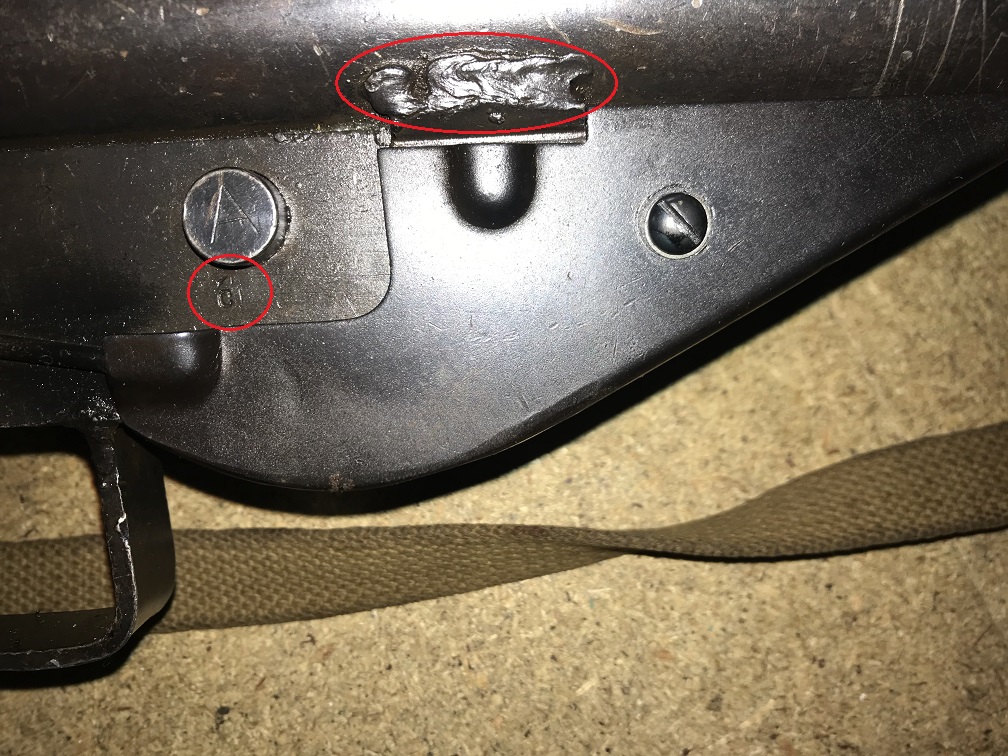

DZelenka Posted August 13, 2018 Author Report Share Posted August 13, 2018 The C Arrow with 2 letters underneath is an inspectors mark, Ill try and get photos of my Faz today with the same marks. With regards to the barrel, at some point in its rotation, you should find the grouping in vertical line with the sights and either high or low. There were numbered forsights to compensate for height and if you cut the weld there is some lateral movement. If the grouping doesnt move around the centre line as the barrel rotates, it could indicate the barrel seat isnt installed correctly and thats a big fix. It also could indicate a tube gun as the originals were jigged at assembly.I rotated the barrel and it did not move the point of impact sufficiently to center up the point of impact right to left. How do I tell if the seat is installed correctly or not? Can i indicate it in a lathe somehow? (I personally would not be doing it.) The only other thing I can think of is maybe changing barrels and barrel nuts. The possibility of it being a tube gun had already crossed my mind. I looked all over the tube and cannot find any markings whatsoever. The Form 3 (eForm) that I received lists the manufacturer as "STEN" and the model as "STENMKII". It also uses the correct FF serial number found on the magazine well. What other indication of origin can I rely on? I emailed a FOIA request this morning; however, that will likely take a while to sort out. If it is C&R, it will likely be either amnesty registered or an importation form (6?), correct? Dan Link to comment Share on other sites More sharing options...

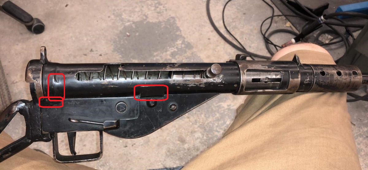

DZelenka Posted August 14, 2018 Author Report Share Posted August 14, 2018 My seller had this Form 4 from an earlier transfer. Given the date, I am thinking that it isn't likely a tube gun. Thoughts? Link to comment Share on other sites More sharing options...

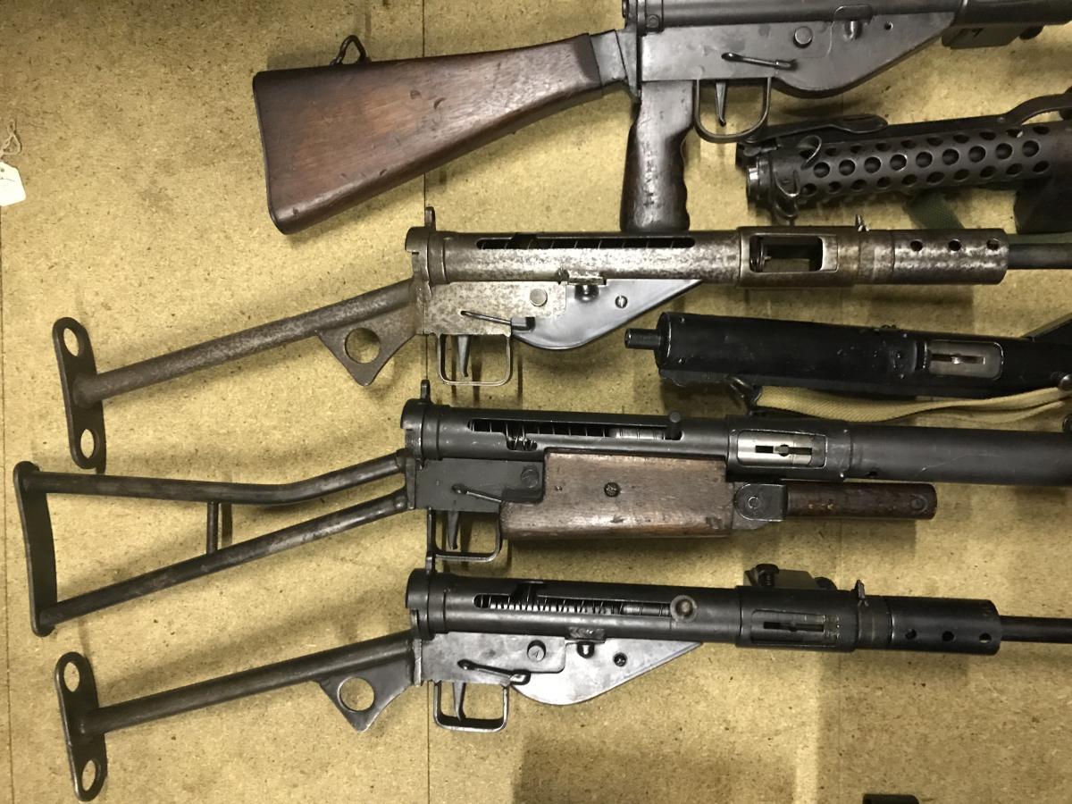

m3bobby Posted August 14, 2018 Report Share Posted August 14, 2018 Hopefully some of these may make useful reference photos. This ones an assortment of some of the collection. Comparison of welds from an original finish Faz Mk2 and a Fin refurb Faz Mk2. You can see the welds on the head here, yours has extra welding around the head which may be to reinforce a week weld or one that's been ground down to far. Close up of the welds and the CF arrow marking Fin cocking handle, this one is from the Fin Mk2 shown above but I removed the handle as I intend to refinish it at some point. Link to comment Share on other sites More sharing options...

johnsonlmg41 Posted August 16, 2018 Report Share Posted August 16, 2018 (edited) I'd think it's an original gun. In 73' there was zero demand for sten tube guns since originals were cheap. Ideally if it were a tube gun, the tube would have been marked with the makers info, but rules were more lax then so that's not 100% and home builder form 1 guns were even more lax. My C+R's are only marked on the mag well, even though it's again, a fairly small sample. We do know for sure it's C+R by 2023 at the least. So I just looked at your pictures on the first page and it looks like there was weld in the chamber cleaned up? If so, I'd think pre-68 dewat, so definitely C+R. In one of the pics the barrel looks crooked, but it may be the photo angle. You'd have to strip it and chuck up the barrel and turn it on a drill press or lathe, or a piece of rod through the barrel to see if it's straight to the receiver. The rod just needs to be long and straight, not necessarily close to the bore dimension as long as you can gauge the distance off the receiver walls as you rotate it by hand it will give you a rough idea? HTH Edited August 16, 2018 by johnsonlmg41 Link to comment Share on other sites More sharing options...
michaelkih Posted August 16, 2018 Report Share Posted August 16, 2018 (edited) The welds on my C&R Faz Sten look exactly the same, and I know it was an amnesty registered bring back. I bought it strait from the family. So..... Also, in the Collector Grade Sten book it shows Faz magwell welds looking exactly like this, so I think it's fine. One thing, mine does have the safety hole, but it is a FL and not an FF gun. Edited August 16, 2018 by michaelkih Link to comment Share on other sites More sharing options...
michaelkih Posted August 16, 2018 Report Share Posted August 16, 2018 Mine for comparison. Old picture I just found online, but you get the idea.http://i658.photobucket.com/albums/uu302/michaelkih/DSC01972_zpsd39a0602.jpg http://i658.photobucket.com/albums/uu302/michaelkih/DSC01963_zpsf600cfda.jpg Link to comment Share on other sites More sharing options...
m3bobby Posted August 16, 2018 Report Share Posted August 16, 2018 Its not the mag well welds I see issue with (Not that any of the welds are really an issue), its the welding on the head and the side plates to tube that have been ground smooth. The only large scale grinding was done by the Finns who smoothed all of theres during refurb. The assembly plants never bothered grinding welds down however some component contractors did to varying degrees, mag wells being an example, TMH covers being another. The additional welding on the head suggests some one, possibly an armourer in service or a post war owner has strengthened a week or loose head. This isn't a problem and it's just an extra part to it's history. Link to comment Share on other sites More sharing options...

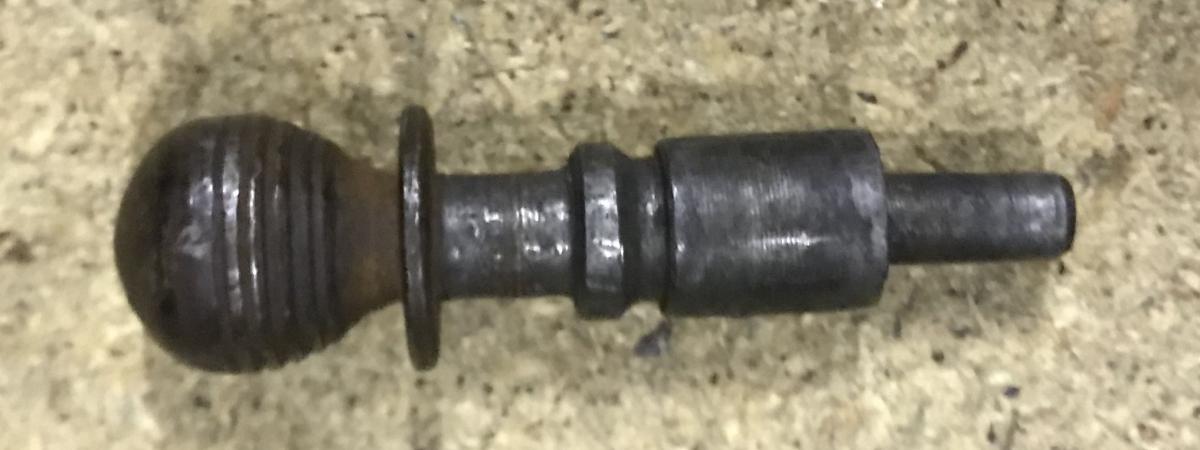

Robert Henley Posted December 4, 2019 Report Share Posted December 4, 2019 I remembered Dan's post, so bringing to the top for a couple of reasons. First, my C&R STEN doesn't have the little hole in the left side of the receiver (there's some history in the above thread). Is this like the MP40 where the German's modified the receiver and bolt handle to lock the bolt in place to prevent an accidental discharge? My C&R BNZ 41 MP40 has the original curved charging handle with no such modification, which I personally like better. I use the strap discussed in other posts but it's more for show because I don't carry it around with a loaded magazine in the mag well (except at the range when shooting it). FWIW, I have 10 original MP40 magazines and they all fit in the mag well fine (discussion about MP40 magazines in other post). I guess the German's were more precise. Robert Link to comment Share on other sites More sharing options...

m3bobby Posted December 7, 2019 Report Share Posted December 7, 2019 The small hole you refer to is a 1944 onwards modification for the Mk5 cocking handle. As you say, it locks the breech block forward so that a bang or knock couldnt move the block rearwards, picking up a round on the way forward from the magazine and cause an ND. Link to comment Share on other sites More sharing options...

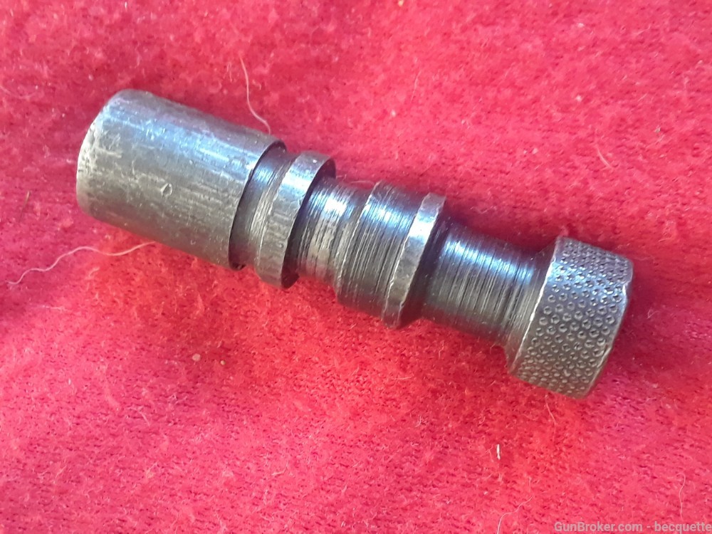

Robert Henley Posted September 22, 2020 Report Share Posted September 22, 2020 What cocking bolt is this one? I didn't see one like it in the above posts. Not one that locks into the receiver I assume. I understand it is an "early" one. Robert Link to comment Share on other sites More sharing options...
BillyDixon Posted September 23, 2020 Report Share Posted September 23, 2020 when i got a load of the mk3 stens that came from finland they all had this style bolt handle, kinda crude with poor knurling, some kinda finnish after mkt bolt handle, just sayn 1 Link to comment Share on other sites More sharing options...
m3bobby Posted November 16, 2020 Report Share Posted November 16, 2020 It’s a Mk3 handle. Link to comment Share on other sites More sharing options...
