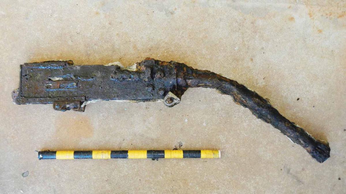

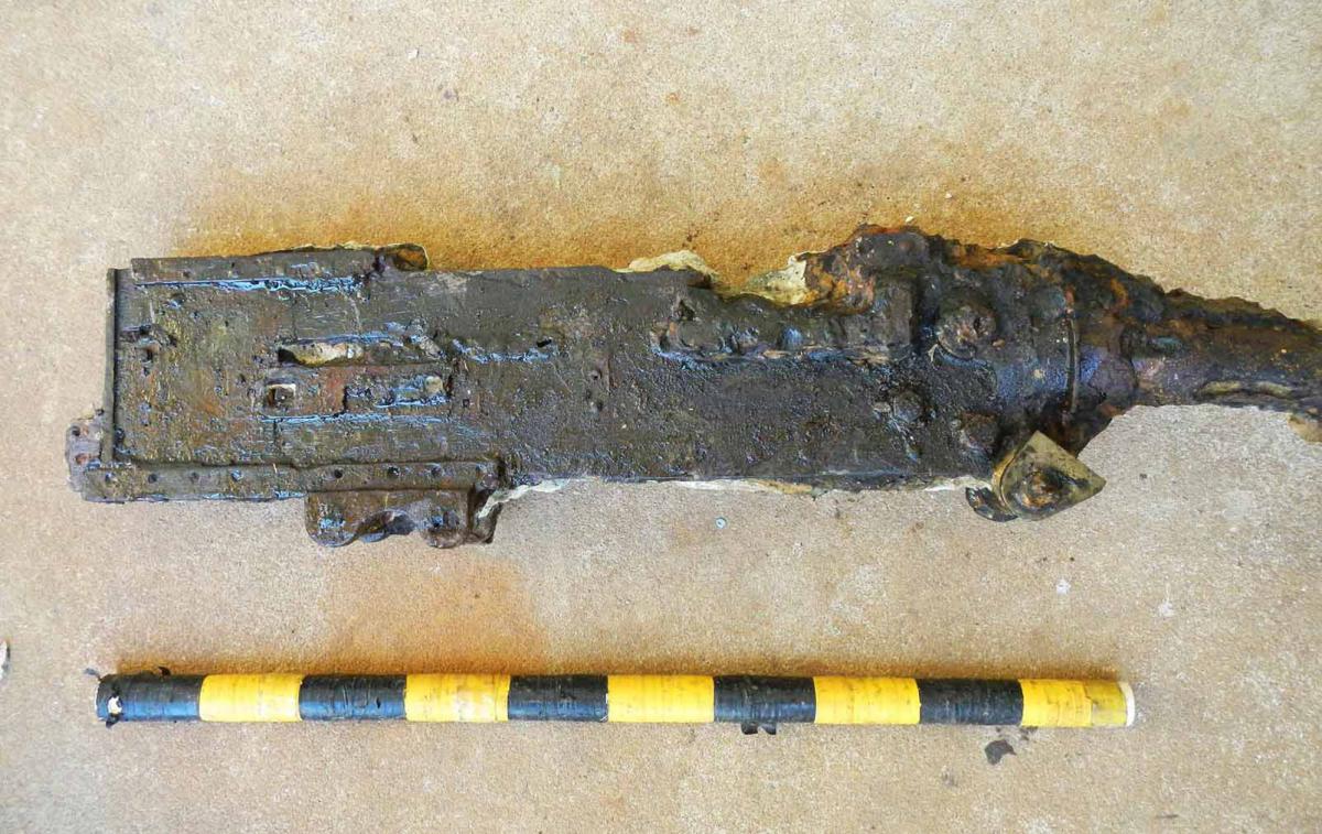

Hiya,
I'm an archaeologist working on a collection of dumped WWII materiel associated with a RAAF base in Darwin Harbour, Northern Territory.  We've recovered a couple of machine guns that I'm almost certain are aircraft version Browning .303 MKII.  My knowledge of machine guns is fairly limited though (!) and I'd love to be able to have ID confirmation from an expert.  (And please forgive any massively ignorant questions from me!).  I have managed to get serial numbers off both of them though - MK II / B 136.752 / B on one and MK II B 868.881 / B on other.
I'd also very much appreciate any thoughts or insight into these guns and whether there's any way to narrow down what type of aircraft they may have come from based on fittings and mounts.  One has been largely stripped, is missing back plate and breech cover and has had the barrel / cooling jacket bent, so doesn't give much info except for the mounting lugs and brackets, I'd guess.  The second has several fittings still attached, has a different cooling jacket arrangement and has spade grips (so I'm figuring it must be from a flexible mount?).  I'm also unfamiliar with some of the fittings; it seems to have a feed chute of some type that I've never seen before.
Unfortunately, both have been in the water for around 60 years and aren't in great condition.  They were also both heavily covered in marine growth and concretion and I've only been able to remove some areas of concretion without breaking things.
I've attached a few photos of both guns.  I'd very much appreciate any thoughts, advice or suggestions for research.
Thank you very much.

While I am not an "expert" - I do own one now and have had several . They all appear to to be MK II 303 Brownings and would have been mounted in the Spitfire, and Lancaster bombers in power turrets and multiple gun mounts.  Perhaps others as well, since these were the "standard" for turret and flex mounts.  There is not a lot of info on the guns but there are several books that have a little information.   Based on the photos, it would appear that the guns are all slightly different. Some appear to have parts removed prior to dumping, some have what appear to be spade grips (making them flexible mounted) and others were fixed mounted ini a wing type mount.  Serial numbers/ model  given are typical of these  guns.  If you want to contact me directly, I can provide more info  based on each photo, and reference photos of my gun for your information.

Those are Browning Mark II .303 Aircraft Machine Guns.  I'd bet they were mounted on Lancasters, based on the spade grips.  I have an original manual in my collection for this weapon, and also own a live U.S. version. (ANM2 .30)

One tidbit of trivia about these guns...In the first photo, the machine gun has a fluted muzzle booster.  These are very sought after parts today...Sought after by Star Wars fans.  In the original Star Wars movie, the light sabers used by Obi Wan Kenobi and Luke Skywalker were made using a Browning MK II muzzle booster.  I had 2 of the boosters in my spare parts, and sold them for $200 each several years ago.  There's even someone who makes an exact reproduction of the muzzle booster, because originals are scarce.

I doubt they were on Lancasters, that type did not operate in the Pacific Theater, most likely on any variety of patrol bombers operating out of the Darwin area such as the Lockheed Hudson or Consolidated PBY both types were fairly common in the RAAF.

Good point...I've always associated these guns with Lancasters, but I guess they were a General Purpose MG for Commonwealth aircraft, and if Lancasters didn't serve in Australia, then that makes sense.

Brittain initially contracted with Colt to buy half a dozen Colt MG40s in .303 in the middle 1930s. These guns had the distinctive spade grips common to all US AMN-2 coaxial LMGs as later also made by Brown-Lipe-Chapin and Buffalo Arms, etc in .30-06. Eventually Colt provided about 1600 plus further Mg40s to GB and then Vickers-Armstrong and BSA undertook production of the Brit version of the guns. The Brit guns were often used in a cradle in singles or twins when employed as co-axial MGs in non-fixed applications. The use of remote, fixed MKIIs was widespread early in fighters, arrayed In the wings providing exceptional firepower during the Battle of Brittain. It is said that this single aspect, the superior firepower of the Brit fighters using eight wing mounted MKIIs gave them an advantage and. allowed them to prevail over better trained and superior aircraft of the Luftwaffe. However, the Luftwaffe were comparatively less well equipped with fewer wing guns and a single 20mm cannon. Use in reconnaissance aircraft, light and heavy bombers, and many other aircraft applications, these Mgs were a cornerstone of Brit armament throughout the war. The Brit versions did not use the spade grips for co-axial use, but employed an add-on pistol grip with a distinctive adjustable trigger mechanism.
The gun in one of the pics of the six in the OP's array appears to be a Colt MG40 due to the spade grips evident from the tops of the grips of the frame that is showing. The others in this group appear to be Brit versions, but they are so corroded that it is very difficult to say.
I have downloaded the other post with the multiple pics and will look at these later to see what they have found. very interesting find.

Very good historical information.  The only caveat is that based on Caroline having recovered the serial numbers off both guns, which are apparently Mk II serials, I don't believe either one is an MG40.  On my MG40, the spade grips are not as high as they are on this one.  This looks like it has a cradle attachment, which is consistent with a Mk II Browning, in order to activate its sear mechanism.
The single gun cradle has grips, and the entire cradle is a separate piece that attaches to the Mk II.  I believe that is what is seen in the photo of the second gun above.  I have one of the cradles in my collection.  I'll take a photo of it and post it here.

For reference, taken from a .303 Browning I have examined:
MK. II*
BS. 195570
SD
Front trunnion has an inspectors marking dated '41
The British manufactured over 550,000 of these guns by the end of WWII
Richard
