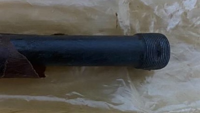

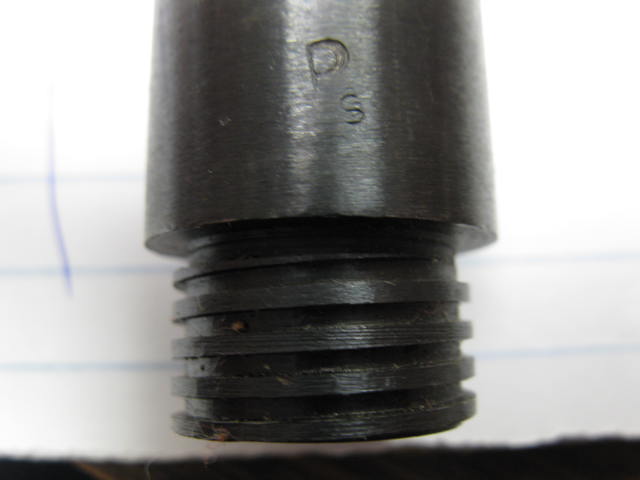

No offense, but we need some perspective here. The barrel you are selling is not
MINT/New Old Stock. It is a USED barrel that somehow ended up dipped in cosmolene
and wrapped. Who knows when or by whom. Why do I say it is used? 1) the boss of the
barrel has the half circle indent from the pin that holds the compensator. New/MINT barrels
have not yet been fitted with compensators and do not have this half circle cut. 2) The rear
end of the barrel has a battered and peened shoulder - almost as if someone peened it all
the way around. Perhaps to try to make it tighter on a gun. 3) The bluing is scarred and
missing from the barrel threads. The close up of the P shows almost no bluing at all.
4) As mentioned in another post here the punch mark is put in the middle of the P after the
barrel is fitted to a gun and test fired.
Here is what a degreased MINT/NOS barrel (smooth, not finned) looks like:
Bob

First of all I will politely disagree with your assumption. The whole barrel is covered in cosmoline. I do not know how someone can redip it and pass it off as a used barrel. I have done some research on this and based on what I see it looks pretty good. I pulled some of the cosmoline off of it to get the pictures of the markings. On the threads there is cosmoline all over them so again I do not know how you come to these conclusions. The threads on the barrel look great to me. Maybe it was test fired before it was covered in cosmoline at the factory. I do not know all the facts, but I have a strong feeling it is NOS. I bought it this way and no longer need it. How do I know your barrel is not NOS? It is all based on assumption and not facts hence the reason I need to research things before I know. Thank you.

There is no doubt that the barrel was fitted to a TSMG at one time. In your first photo, the barrel boss threads have a groove from a Cutts Compensator Pin, showing that a Cutts was previously installed as Bob mentioned. A NOS Factory Barrel would not have had a Cutts fitted and removed. Serviceable used parts were often packed in cosmoline by many countries post war. Also, there have been unscrupulous individuals in the past that would dress up used parts in cosmoline and wrap to appear NOS.

The guns may have been test fired before crating and shipping out, but NIW replacement barrels were never tested by firing, and will have no signs of installation, such as a witness mark on the breech end or a pin groove in the compensator threads.
If it has a pin groove in the front threads it's been on a gun. Possibly it is a new gun that was cut up for parts and if so, it's a "takeoff" barrel, but not a NOS. And as pointed out here, cosmoline doesnt make it new again, it just keeps it from rusting.
I didnt see the pics or ad for this barrel so can only relay what I know about the NOS, NIW and takeoff parts I have bought.
