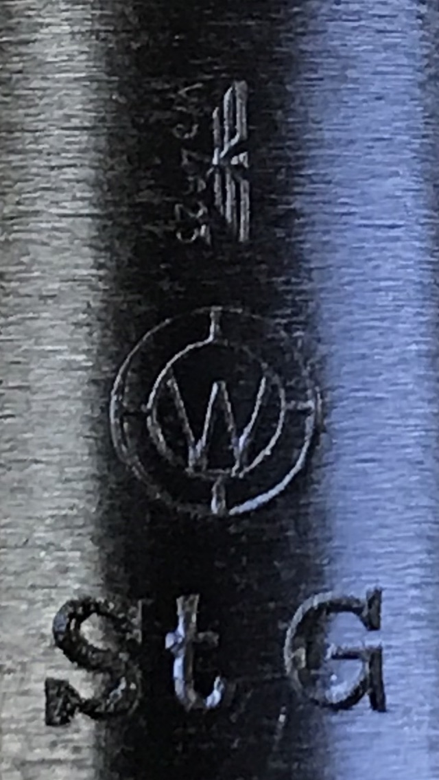

Govostes Posted June 13, 2019 Report Share Posted June 13, 2019 I recently bought a MP38/40 from Morphy auction house, its a Inland tube gun. They say the front sight an Barrel are from a MP38 an the rest of the gun are from a MP40 minus the receiver. There are three Proof marks on the Barrel, the first one I recognize a military acceptance proof. The other two I,m not sure, I didn,t know if someone on the forum Might. My first thought , is the barrel is a military Replacement for a MP40. Anyone s input would be appreciated. Thank You Dave Link to comment Share on other sites More sharing options...

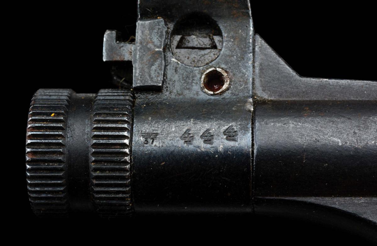

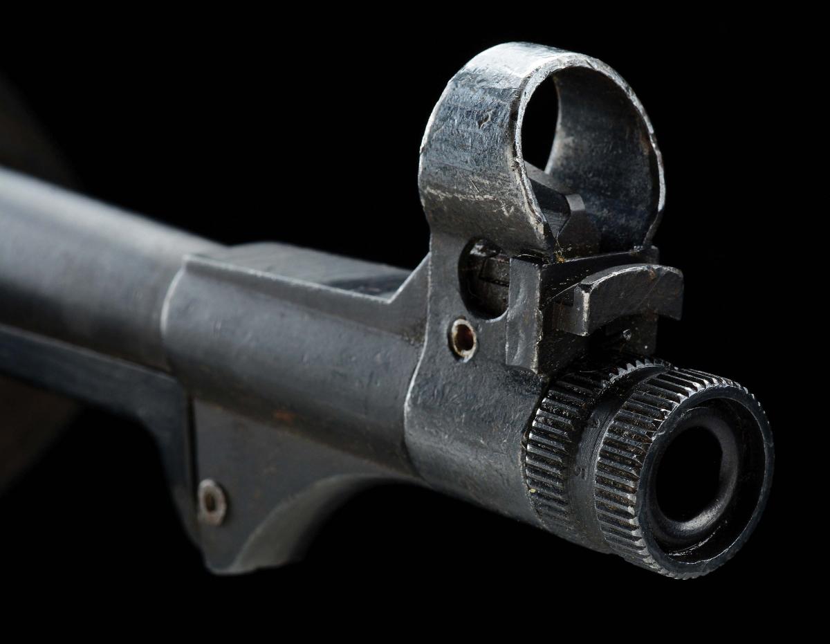

Annihilator Posted June 14, 2019 Report Share Posted June 14, 2019 If the WaA shown on the picture is 623 then the barrel itself should be from Steyr and Steyr did not produce the MP38The front sight hood is of MP38 but with Waffenamt 37 which is correctSo i think the barrel components are mismatchedThe muzzle nut is the MP40 style Link to comment Share on other sites More sharing options...

TSMGguy Posted June 14, 2019 Report Share Posted June 14, 2019 StG is believed to be a Steyr barrel code. There's usually a year stamp associated with it. Link to comment Share on other sites More sharing options...
Govostes Posted June 14, 2019 Author Report Share Posted June 14, 2019 Dose anyone have an Idea about the middle Stamp on the barrel. I still feel it is a Replacement barrel. Link to comment Share on other sites More sharing options...
Black River Militaria CII Posted June 15, 2019 Report Share Posted June 15, 2019 (edited) StG is not Steyr, the Wa codes of which are 660, bnz and swj for MP40s. Michael Heidler's comprehensive volume on armament codes of 1945 states that "StG" is "unbekannt", unknown, and associated with K 98k and MP40.Basically that is a dead end.I've seen this barrel mark on the barrels of at least a half dozen MP40s and had wondered, as well, about it's provenance until I got Heidler's book. FWIW Edited June 15, 2019 by Black River Militaria CII Link to comment Share on other sites More sharing options...

Annihilator Posted June 15, 2019 Report Share Posted June 15, 2019 It is a Steyr made barrel, the Steyr WaA proof stamp is 623And you see it in the picture Do not confuse production code and Waffenamt proofThe Steyr production codes for MP40 are 660 and bnzThey did not produce the MP 38The front sight hood is from Haenel with the WaA 37 proof stamp Link to comment Share on other sites More sharing options...
Petroleum 1 Posted June 15, 2019 Report Share Posted June 15, 2019 Any idea what that W stamp is?? I dont recall ever seeing that marking before. Link to comment Share on other sites More sharing options...
TSMGguy Posted June 15, 2019 Report Share Posted June 15, 2019 (edited) The StG is most likely a Steyr steel batch code. IIRC, my all matching bnz 41 MP-40 has this code on the serial numbered barrel. I'll have to dig the gun out of the safe and look. The gun's WaA stamps are all 623 and 815, which are typical. Both are seen on Steyr-made MP-40 componants. Edited June 15, 2019 by TSMGguy Link to comment Share on other sites More sharing options...

Black River Militaria CII Posted June 15, 2019 Report Share Posted June 15, 2019 (edited) >The StG is most likely a Steyr steel batch code.< Steel alloy codes are numerical with letter prefix, are fairly commonly encountered engraved on the axis of the barrel close to the receiver. They are often confused with serial numbers, but obviously are not since multiple guns are so marked with the same numerical code. A small variety of them have been noted over the years on US owned Mp40s, registered and kits.I again refer you to the definitive code and WAa analysis and listing compiled and published in German by Michael Heidler, "Deutsche Fertigungskennzeichen bis 1945". "StG" is listed as "unbekannt", or unknown and associated with K98k and MP40. There is no other StG stamp noted or listed or any other printed reference that has the provenance of this stamp.Do you have references for your speculations. Please post it if you do. FWIW Edited June 15, 2019 by Black River Militaria CII Link to comment Share on other sites More sharing options...
Govostes Posted June 16, 2019 Author Report Share Posted June 16, 2019 Dose the book your referring to by Michael Heidier, Have any reference to the Middle stamp on the Barrel. I don,t believe a reproduction barrel would have these stamps on it, even though there,s no serial number. Link to comment Share on other sites More sharing options...

DZelenka Posted June 17, 2019 Report Share Posted June 17, 2019 A quick internet search has StG listed as a barrel blank code for Steyr for K98s and MP40s. THe WaA623 is the Steyr inspector's stamp. My bet would be repalcement barrel since there is no serial number on it. I would further bet that it was NOS after the war when it was installed on this tube. Link to comment Share on other sites More sharing options...
Govostes Posted June 18, 2019 Author Report Share Posted June 18, 2019 Any Idea on the Middle Stamp Link to comment Share on other sites More sharing options...
TSMGguy Posted June 19, 2019 Report Share Posted June 19, 2019 >The StG is most likely a Steyr steel batch code. Do you have references for your speculations. Please post it if you do. FWIW The StG marking is not a WaA stemple. It's only encountered on Steyr made 98K and MP-40 barrels, all of them WaA623 marked. The StG marked barrel on my all matching bnz 41 MP-40 conforms to this convention. Looks like we know the what of the StG marking pretty well, if not the why. There'll be no reliable references unless someone unearths and translates original pertinent documents. Link to comment Share on other sites More sharing options...
oogillino Posted October 18, 2023 Report Share Posted October 18, 2023 The middle stamp is from the steel foundry. Barrel blank manufacturing symbol for the steel firm DEW. Deutsche Edelstahlwerkes. They are still around today. Link to comment Share on other sites More sharing options...
