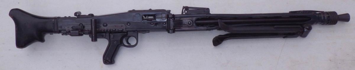

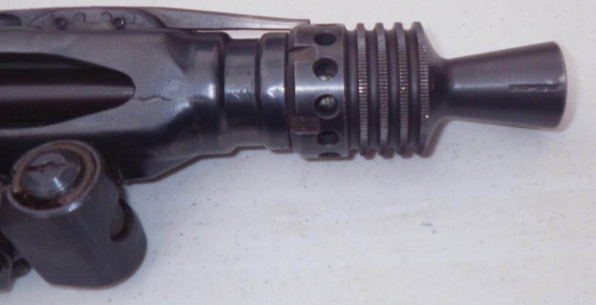

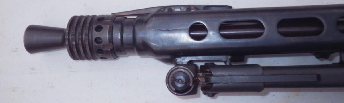

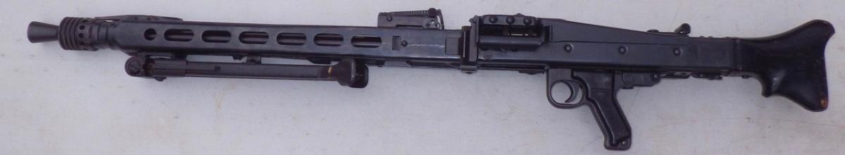

DZelenka Posted April 3, 2017 Author Report Share Posted April 3, 2017 I think I have answered my own question but would love any commentary. Also, this gun doesn't appear to have an anti-aircraft sight spud (at least I cannot see it from the side view pictures), that seems very odd. Link to comment Share on other sites More sharing options...
Black River Militaria CII Posted April 3, 2017 Report Share Posted April 3, 2017 (edited) The maker whose stamp is 'arz' made MG34 and MG42 parts. The company was Deutche Kul-u Kraftsmaschinen GmbH, Kraul-Enbisdorf, bri Freiberg, Germany. It is the maker's stamp on the gun. This outfit was a sheetmetal stamping concern. Many businesses contracted with the major assembler/makers to make parts for the MG42s. Kraftsmaschinen also made MG34 parts like feedtray so, bipod parts, etc.If the profile picture is slightly below the centerline of the gun the AA fixture can be hidden behind the top edge of the shroud. There should be one on that gun. Buttstock appears to be Yugo. Edited April 3, 2017 by Black River Militaria CII Link to comment Share on other sites More sharing options...
DZelenka Posted April 3, 2017 Author Report Share Posted April 3, 2017 Buttstock is Yugo as is almost every part other than the top cover and the receiver. Link to comment Share on other sites More sharing options...

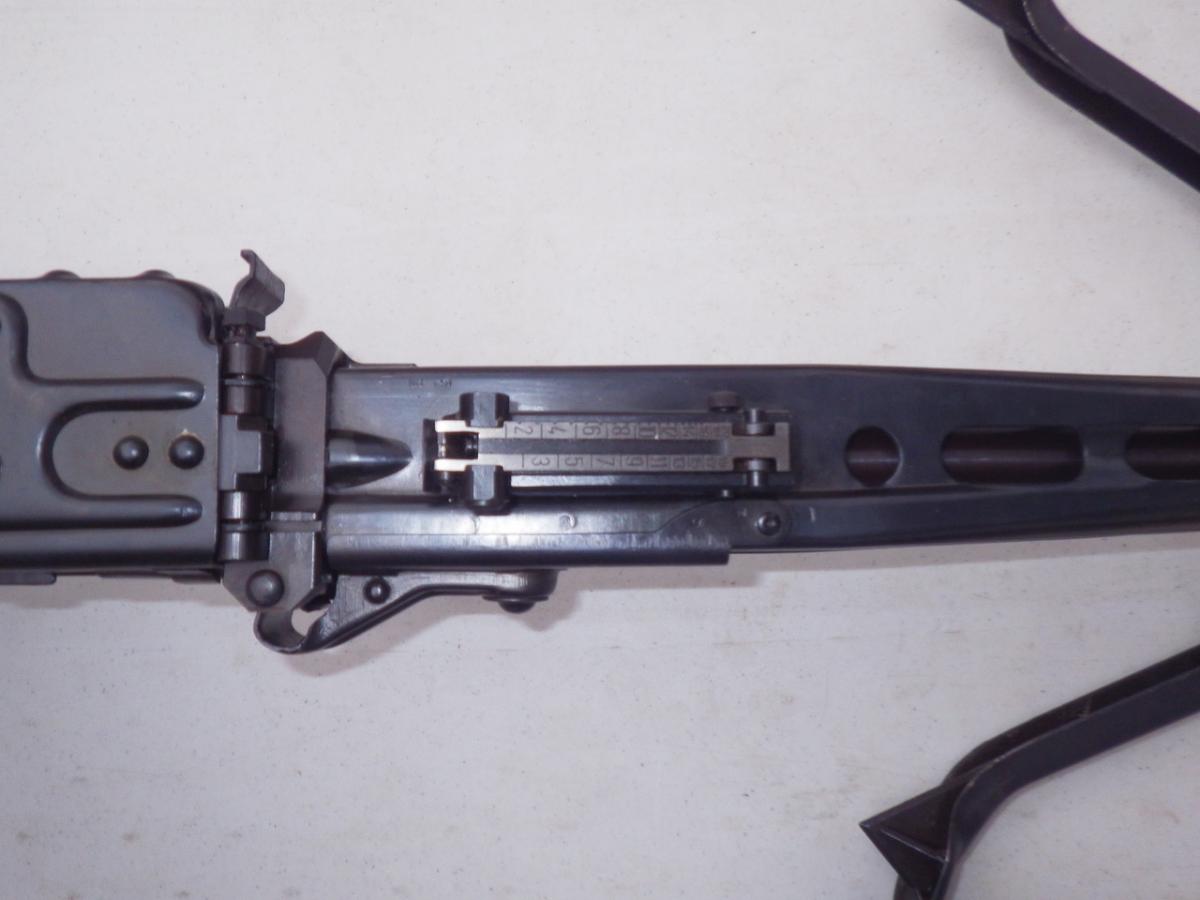

DZelenka Posted April 3, 2017 Author Report Share Posted April 3, 2017 couple more Link to comment Share on other sites More sharing options...

Black River Militaria CII Posted April 17, 2017 Report Share Posted April 17, 2017 Rear sight is also Yugo…….the trunnion appears somewhat purple to me. Does to have a purplish color to it? Link to comment Share on other sites More sharing options...
