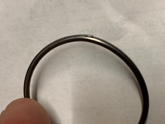

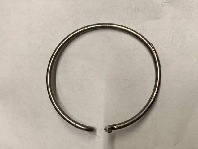

I thought those here might find it interesting to see a picture of a bad topcover feed cam return spring.
Typically, they do not totally snap - instead, they crack making the return slow/weak - and gun just starts to misfeed...
Notice the very small crack at the top of the 2nd picture.

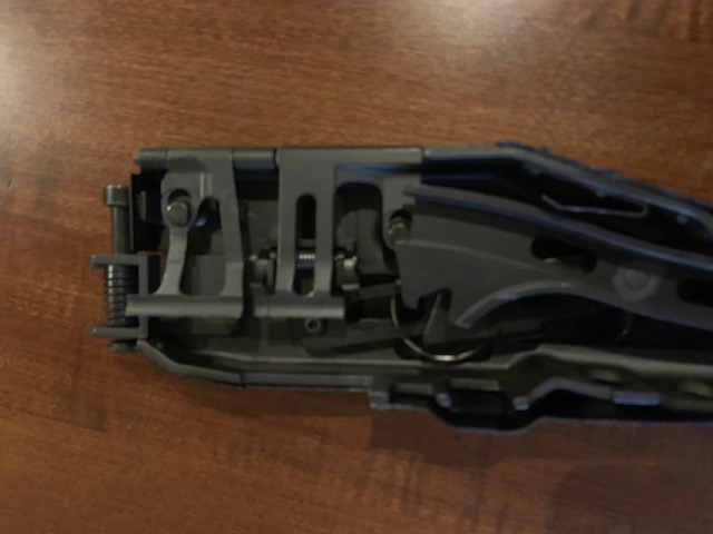

Here is a picture of an M60e3 topcover showing where the spring is located under the cam...
