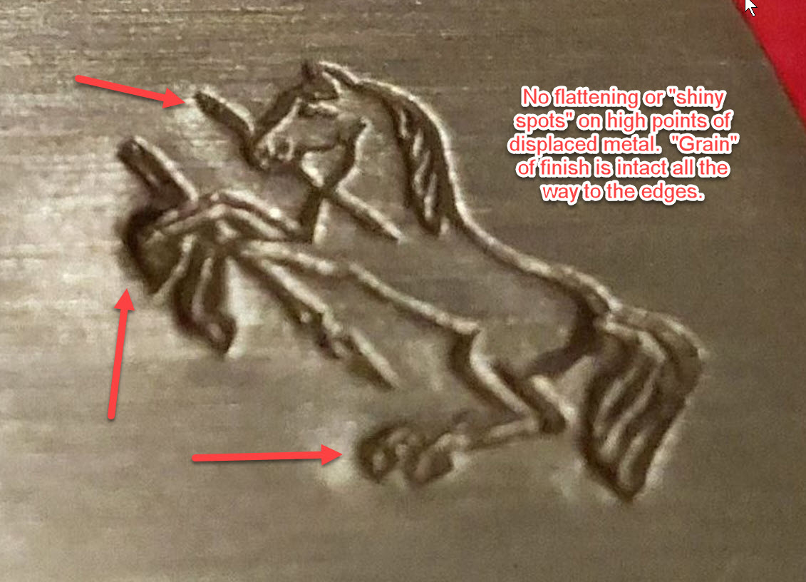

Let's look at just the slide for a moment, if we may.  All the roll marks on it are crisp, but the main reason why I think this slide has not been restored or re-blued is the displaced metal from the "pony" stamp.  I'm including a closeup of that stamp.  You can see that the raised/displaced metal hasn't been flattened or lowered in any way, and that those parts still retain the "grain" of the finished metal.
When that mark is buffed even a little after it has been stamped, the tops of those raised bits get flattened and/or shiny--if not go away entirely.  I'm not seeing that at all here.
Also, the only mark on this slide is the "B" above the FP stop plate.  I'm not sure what that means (haven't found where my Clawson ended up yet), but if this part went into service, it should have had other markings, shouldn't it?  How about the amount of wear showing--not only through the finish, but in the metal itself--does this slide look virtually unused to others here?
What do you think?  Has this slide been re-finished since it was marked, or not?

Not being an expert, I think the slide looks very original. You have made excellent points about the metal displacement and bluing.
  • 2

That the pony stamp was applied after the last time the steel was buffed seems even more apparent in this photo -- taken with a low-power microscope.
