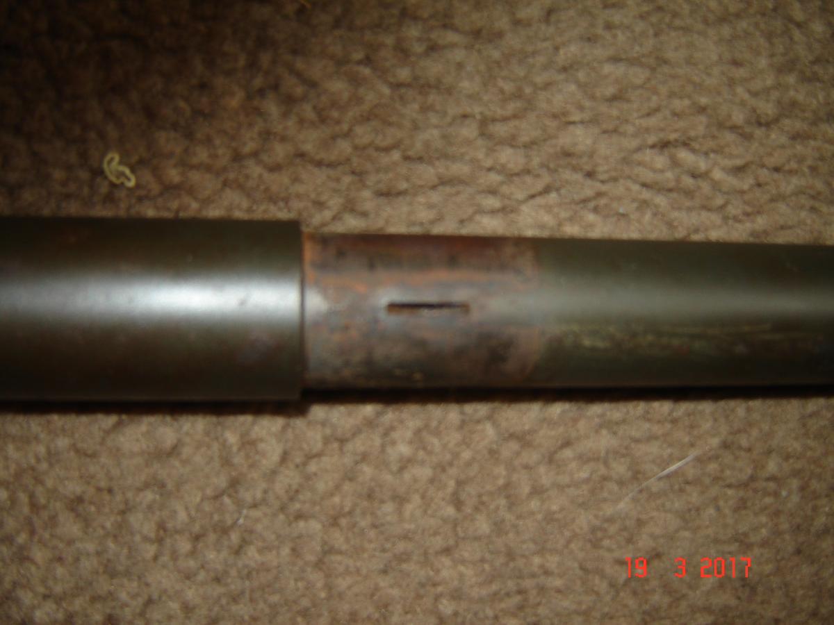

Here's a picture of the slot in the stoner barrel. The slot is .435 long and .150 deep. It is .6525 from the edge of the larger portion of the barrel to the center of the slot.

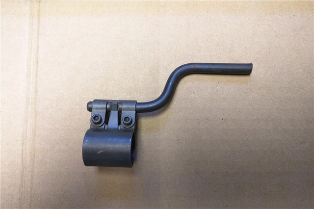

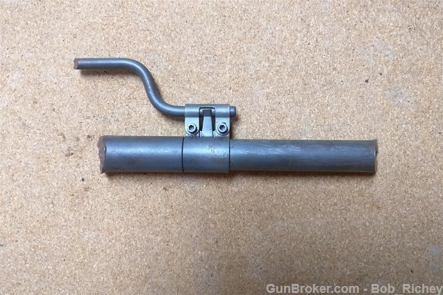

And the demilled carrying handles
