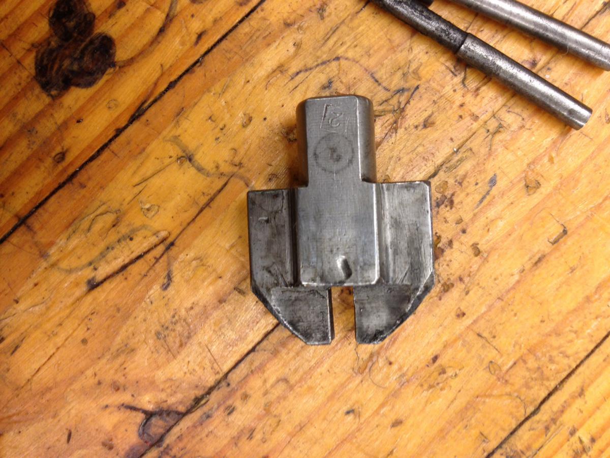

DZelenka Posted September 16, 2015 Report Share Posted September 16, 2015 PJ 1715bbnz Steyr from early 1944?Why is there no MG42 stamping? Link to comment Share on other sites More sharing options...

DZelenka Posted September 18, 2015 Author Report Share Posted September 18, 2015 Bolt markings Link to comment Share on other sites More sharing options...

Black River Militaria CII Posted September 22, 2015 Report Share Posted September 22, 2015 (edited) Further Yugo parts observed:Booster/flash-hiderTrigger in stripped WWII Waffen marked grip stickBolt body. Bolt head appears to be vintageBipod Only Steyr 42s have been observed with the phosphate receiver mixed with blued parts. Not all Steyt receivers were phosphate. Late war made receivers often were not marked with MG42 by several makers. Curved piece, trunnion in other words, has matched parts by number, which were mated during machining, and is "ar" marked for Mauser manufacture. Rivet holding trunnion parts together appears to be original or arsenal rework.Finish looks fair to good, pretty average for many 42s in the US. Bob Naess Edited September 22, 2015 by Black River Militaria CII Link to comment Share on other sites More sharing options...
