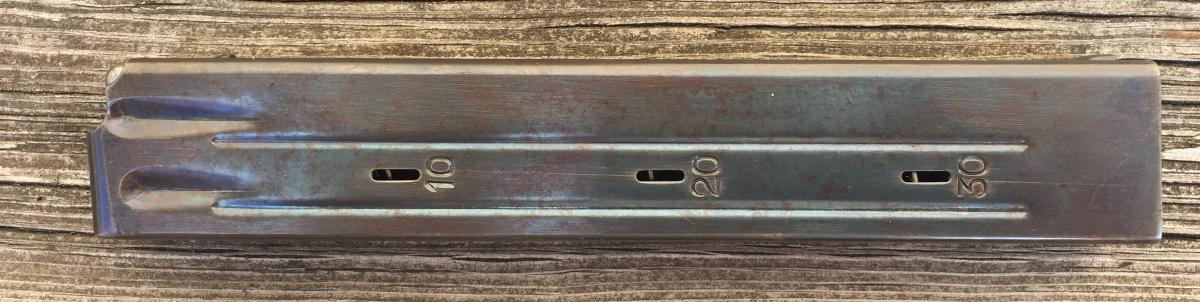

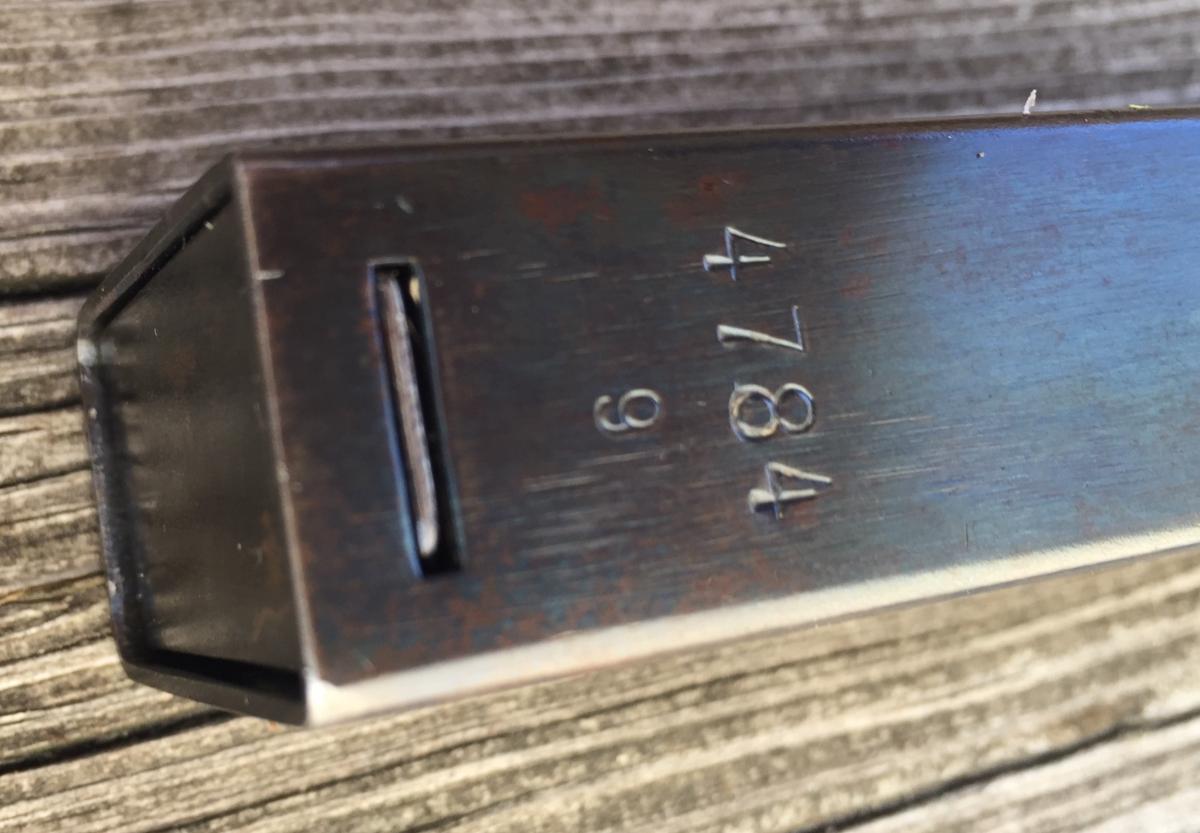

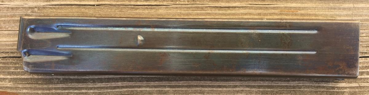

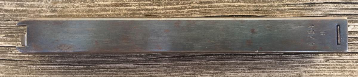

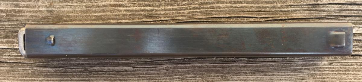

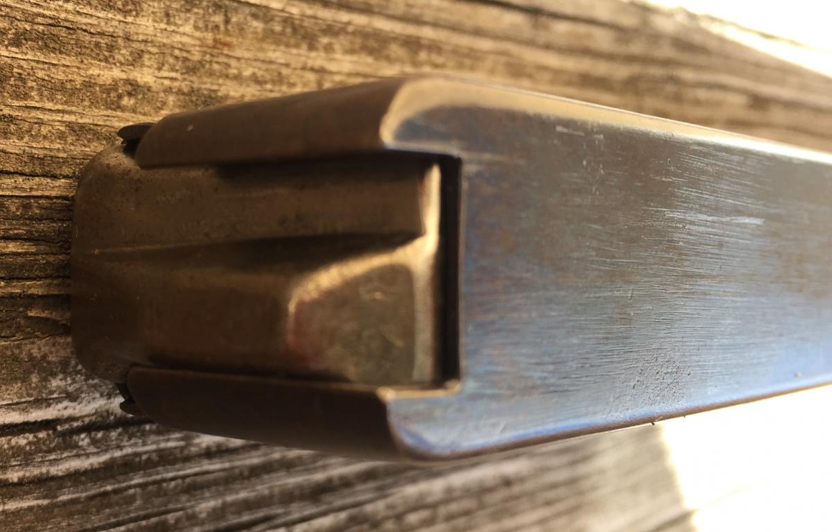

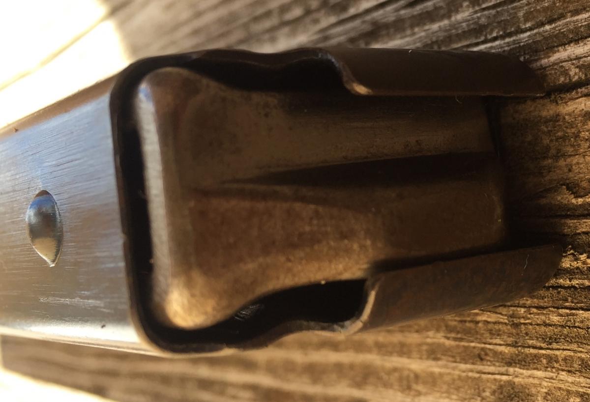

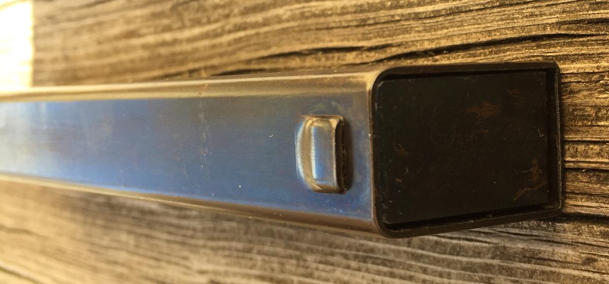

inertord Posted August 30, 2020 Report Share Posted August 30, 2020 Looking for ID on the magazine shown, 30 round capacity, appears to be 9mm Parabellum Caliber. Thanks much and stay safe! Frank Link to comment Share on other sites More sharing options...
Mike Hammer Posted September 1, 2020 Report Share Posted September 1, 2020 Those are either Swedish K or Suomi mags aren’t they. I’m sure someone else can confirm one or the other if they are more familiar with them. Link to comment Share on other sites More sharing options...
Got Uzi Posted September 1, 2020 Report Share Posted September 1, 2020 Swedish k, Port Said, and Suomi mags arent rectangle. They are angled on the sides Link to comment Share on other sites More sharing options...
DINK Posted September 2, 2020 Report Share Posted September 2, 2020 Most definitely not Swedish K/Suomi mags. No idea what they are, though, except for a European origin probability due to the serial number. Most people aren't anal enough to serial number mags, LOL. Link to comment Share on other sites More sharing options...
1gewehr Posted September 2, 2020 Report Share Posted September 2, 2020 Possibly Swiss. Maybe MP48/MP310? Link to comment Share on other sites More sharing options...
PTRS-14.5 Posted September 6, 2020 Report Share Posted September 6, 2020 This may be newhausen (SP?) SMG MagPTRSCharlie Link to comment Share on other sites More sharing options...
inertord Posted September 7, 2020 Author Report Share Posted September 7, 2020 Winner, winner, chicken dinner: SWISS SIG NEUHAUSEN MKPO SUBMACHINE GUN https://www.morphyauctions.com/jamesdjulia/item/1085-369/ Link to comment Share on other sites More sharing options...

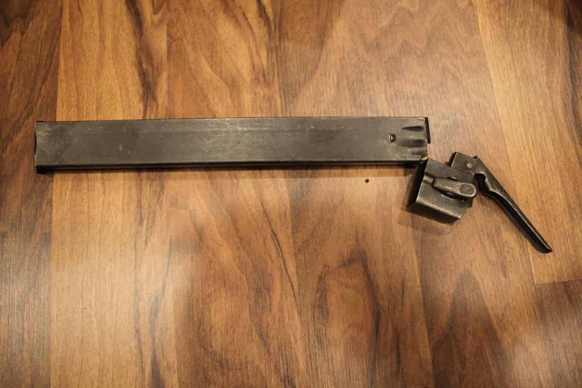

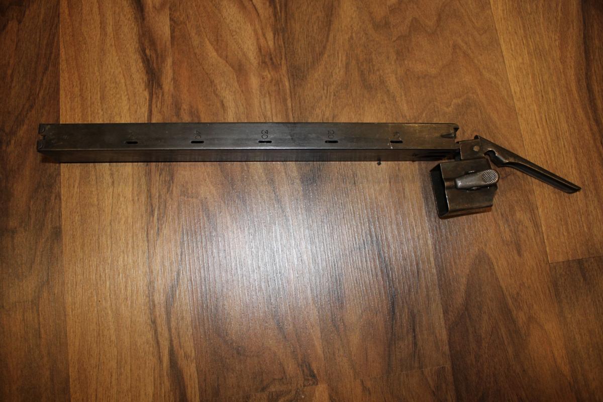

johnsonlmg41 Posted October 5, 2020 Report Share Posted October 5, 2020 Seemed too easy? How about this one?It does have a Finnish stamp at the bottom. The loader is unmarked. 50 rounds!!! Link to comment Share on other sites More sharing options...
BillyDixon Posted October 7, 2020 Report Share Posted October 7, 2020 this mag is for the finnish bergman smg, cal 7.63 mauser, the guns are quite scarce but years ago many thousands of mags and loaders showed up on market, sarco and navy arms had them,, i was able to modify one to fit the spanish destroyer 9 mm largo cal carbine, just sayn 1 Link to comment Share on other sites More sharing options...
johnsonlmg41 Posted October 12, 2020 Report Share Posted October 12, 2020 Very helpful, thank you. Too bad I only have the one or a conversion effort would be worthwhile. Link to comment Share on other sites More sharing options...
supertwin Posted December 3, 2020 Report Share Posted December 3, 2020 The swiss MP48 / 310 are identical to your mags, but with 40rds capacity Link to comment Share on other sites More sharing options...
