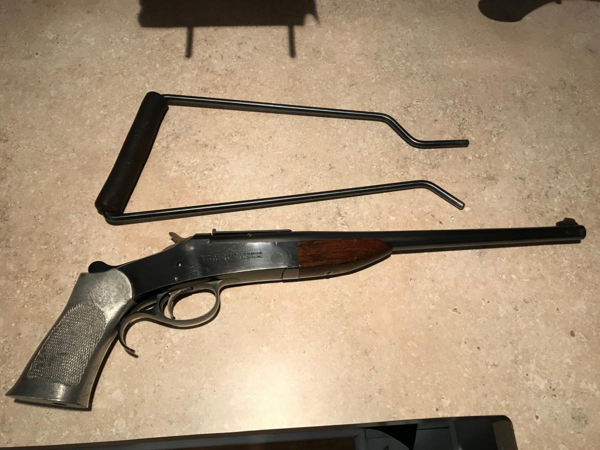

Here it is . The stock fits in to two holes in the aluminum grip
That is great! I have never seen or heard of an aluminum grip. Great find.

Posted 26 March 2020 - 08:33 PM
Ditto!  Thanks for posting!
