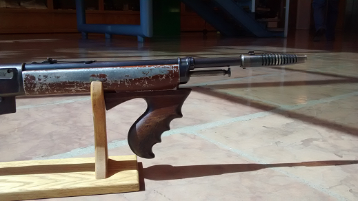

OCM Posted October 21, 2014 Report Share Posted October 21, 2014 (edited) Here are some good close ups, that my pal Sheriff Ernie Hudson took, of the recovered Dillinger 351 in Tucson AZ, 1934. It's converted to full auto and according to them still in working condition. Dillinger group had a couple of these as well as other 30s outlaws like Baby Face Nelson.I've posted these before, but since you just got one, here they are again. OCM Edited April 15, 2015 by OCM 1 Link to comment Share on other sites More sharing options...

gunhistorian Posted October 25, 2014 Report Share Posted October 25, 2014 I really like the photos of the Dillinger .351! Thanks for posting them. I wonder if Dillinger did the gunsmithing work on the rifle or if some unknown (at least to me!) gunsmith did the f.a. conversion, the attachment of the TSMG vertical foregrip, and the installation of the compensator? The comp looks familiar, but I can't place it! I don't think it was an option on the 07, was it? Was the s/n of the rifle traced to the original customer? Maybe that would provide a clue to who did the 'smithing work. . . Sorry to be so curious the technical stuff -- who did the conversion, how it was done, etc. Link to comment Share on other sites More sharing options...
dalbert Posted October 25, 2014 Report Share Posted October 25, 2014 gunhistorian, The work was done by Henry S. Lebman in San Antonio. David Albertdalbert@sturmgewehr.com Link to comment Share on other sites More sharing options...
OCM Posted October 25, 2014 Report Share Posted October 25, 2014 Hyman S. Lebman did the conversion in his basement shop in San Antonio, Texas. The front was a saddle/leather shop. He also made the Colt mini submachine guns for the Dillinger group.Go to the HS Lebman gunsmith to the outlaws on this forum-subject area, lot of stuff on him and his work. OCM Link to comment Share on other sites More sharing options...
