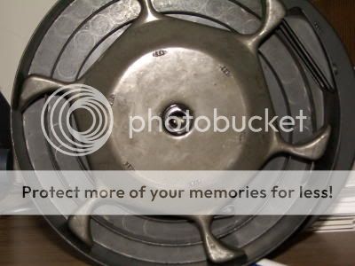

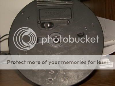

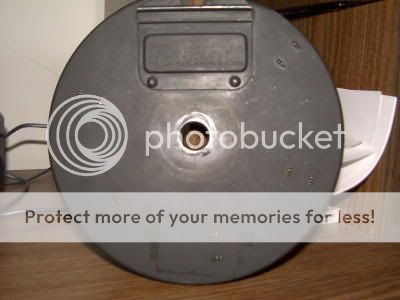

Here are the pictures of the drum. Any help with approximate value is appreciated.

Hawk
You may want to do a search and see an earlier extensive discussion on on this subject.
Search Subject Drum and Member Sig (any time period) or try this link if it works.
drum discussion
My impression is this is a Colt based with the comma after the N.Y., being my guide. The rotor looks kinda dark in the picture it should be nickel type finish not black to be original. The Worcester drums noted New York, N.Y. where Colt had New York N.Y., from what I see in Doug Richardson's book on the subject. Colt drums should have a nickel internal rotor where Worcester's were black oxide finished.

Posted 07 January 2004 - 07:50 PM
Appears to be third model Colt L drum with a Worcester rotor (non nickel plated).

Posted 07 January 2004 - 07:51 PM
That drum looks very similar to the one I sold, not too long ago, for $1000.00 (believing it to be a Worcester Pess model). I now think that mine was either an early (mid-thirties production) Worcester drum or a Colt. Yours definately looks to have the nickel rotor, which would tend to indicate it to be an early Worcester or a Colt. I think I noticed spot welds on the back cover. This would indicate that the back cover, at least, is probably a Colt drum part. All Thompson drum parts are interchangeable and over the last 70-80 years, they have been mixed and matched. ohmy.gif blink.gif Your drum looks to be in original condition (no paint, parkerizing, etc), which is always good. Well, that's my two pennies worth. blink.gif cool.gif Good Luck! biggrin.gif Regards, Walter
PS: On second inspection, I see that there are spot welds on both front and back covers, indicating Colt lineage. It appears to be a nice drum! I'd venture to put a price of $2,000-$2,300 on this drum. Also, you might want to get some differently angled shots of the internals to reduce the glare and clearly show that it is, indeed, a Nickel rotor. Arthur, I think you are right, about this Drum, because of the spot welds (went back and checked the old discussion) and the "5," from".45" is under the "g." Note: There does, however, appear to be some difference of opinion about the spot welds, whether they indicate Worcester or Colt, between Tracie Hill and Doug Richardson.

Posted 07 January 2004 - 08:17 PM
I believe only the three type Colt drums had nickel rotors. The Colt drums are supposed to have the two faint "spot welds" above the slide markings.

Posted 07 January 2004 - 09:13 PM
I understand
Spot welds are very pronounced on Worcester drums BUT Colt drums still have spot welds.

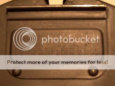

Posted 07 January 2004 - 10:16 PM
Closer photos of drum. I believe it is a nickle rotor, from what you members say about Colt manufacture, I think you are correct from what I see. Do these photos offer any more help or change of mind about the manufacturer. I bought this drum 5-6 years ago for $500. Thanks again.

Posted 07 January 2004 - 10:20 PM
hawk, no, it does not change my opinion. Unless you need the money, I would hang on to that drum! smile.gif biggrin.gif Regards, Walter

Posted 07 January 2004 - 10:44 PM
You might want to polish the rotor out to insure it is nickel. Many Colt drums have had their nickel rotors swapped for black oxide Worcester ones. I have a low three digit numbered Colt L drum with the faint rivets on the back cover. I can't imagine how Hill and Richardson could be at odds about whether these "spot welds" indicate Colt from Worcester. All they need to do is look at their own Colt drums and compare to Worcester drums. Surely each expert has their own swelling collection to be definitive?
