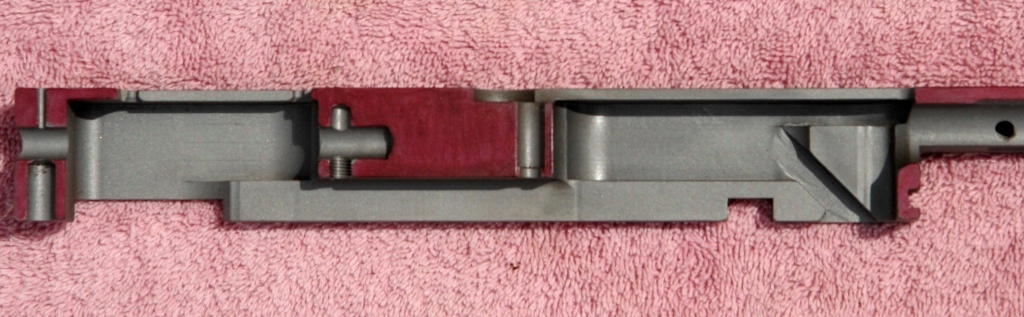

My 1928A1 ESF "Ultimax" receivers are being the subject of comparison which is fine.  But to do it right, the entire receiver needs to be viewed - not just selected areas.  The outside of my receivers has not changed much since I made my first receiver in 1957.
"Ultimax" did not change that.  What "Ultimax" did change was the interior of the receiver.  The whole "Ultimax" concept was based on making every single cut that is made on an original working receiver but interrupting some of those cuts to stay legal.  So a cutter path that would originally go from one end of a working receiver to the other would be there but be interrupted in the middle of the bolt channel.  Heretofore, if the cut could not be completed, it would not be done at all.  Therefore, to not examine the receiver interior is to not see an "Ultimax".
In order to provide everyone with a true and complete view of an "Ultimax", I am providing the two photos shown below.  The first is a bottom view of a 1928A1 "Ultimax" receiver.  This receiver has been fitted with one of my 1928 Ultimax Display Pilot kits.
The second photo is a cut-away view of the left inside of the bolt channel.  This view was made possible by cutting a receiver down the middle except for a jog over to cut through the rear sight rivet holes.  Note that the bolt channel roof slot with its 1/4" wide x 3/4" end radii, which clears the underside of the actuator slot, is completely finished.  The lock ramps with their ramp entry bevels are completely finished.  The horizontal lock track is finished on each end but "interrupted" in the middle as dictated by the "Ultimax"
concept.  However, because the track is started, the transition between the ramp and track was able to be finished.  Note also that the rear sight holes are completely finished including the countersinks for the rivet heads.
The rear end of the bolt channel is completely finished including the slot for the oiler.  The front end of the bolt channel is completely finished.  The breech entry chamfer at the front end of the bolt channel is finished.  There is not a single cut  called for on the original manufacturing drawing that has not been made as shown on the drawing.  No omissions.  No shortcuts.  Only a section of the slots on the sides of the bolt channel have been interrupted in accordance with the "Ultimax" concept.
"Ultimax" does not make it easier to make an ATF defined machine gun (more than a single shot with a single pull of the trigger - that only takes a rectangular pocket fitted with an M1A1 bolt.) "Ultimax" makes it easier to make an original style 1928 if you have the license. (By the way, "Ultimax" is a trade mark of Douglas W. Richardson.) For more information, visit my website www.ThompsonSMG.com  or call me at 310-457-6400
Attached File  IMG 1 IMG_1348.JPG   102.47K   395 downloads (Click on the Photo for a large view.)
Attached File  IMG 2 Copy of IMG_1385.JPG   179.76K   382 downloads (Click on the Photo for a large view.)
Edited by Doug Richardson, 19 May 2013 - 03:22 PM.

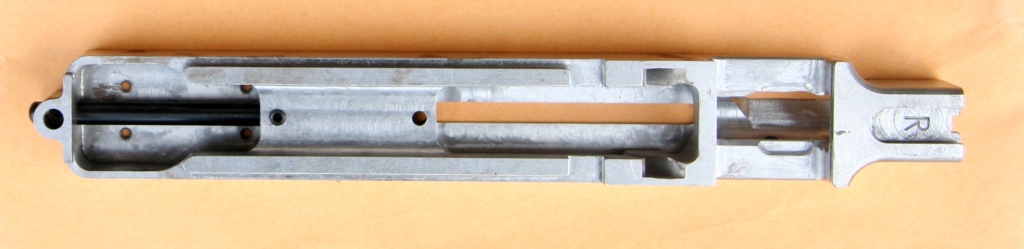

     I do not make an "Ultimax" receiver. I make 80% machined receivers for dummy gun builders
and gun builders. and 100% machined receivers which we build into WORKING and SHOOTING
guns for Class 3 dealers with a Police letter, Police Departments, and Class 2 manufacturers. My
intent with the post was to show side by side the quality of the machine work offered by myself and
Doug, not to compare a specific receiver. My "Ultimax" is a 100% machined receiver.
    Here are photos of the underside of my 100% machined receiver. My 100% receiver is more
correct and more complete (obviously) than an "Ultimax". It has to be - I am making guns that WORK.
There are cuts missing on the Ultimax receiver that need to be done, but can't be done until the bolt
cavity in the receiver is fully machined so you can get in there to do them. If you don't
actually finish and test fire guns on your receivers you have no way of knowing this. There is no
substitute for experience. Also - Please note that the angled cuts at the rear of the mag cutout are there
on the 100% receiver.
