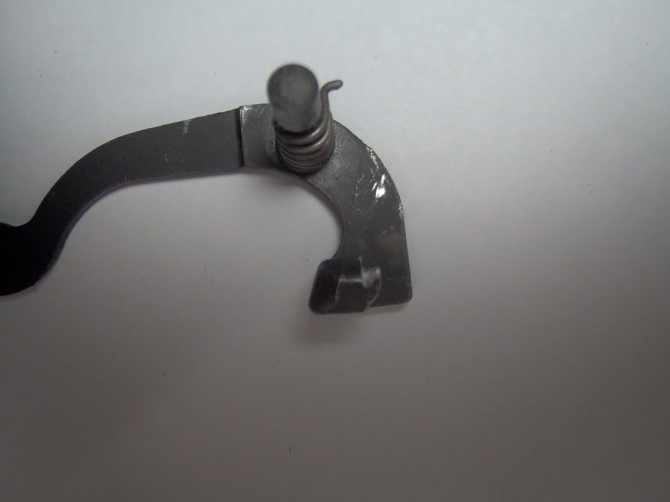

"Well, since this thread is now a sticky, I thought I’d post a few pics of the mag catch mod for you fellers out there who have yet to do it, kind of a before and after comparison. I used a Dremel tool with a cut-off wheel to re-shape the locking stud approximately 0.10” shorter than the factory SA one. You can buy these babies pre-shaped for about 40 bucks , or save a dollar or two and do it yourself. I bought the Dremel tool for 18 bucks, the cut-off wheels for 4 bucks, and the mandrel for 3 (all from Wallyworld)…so, I’ve got 25 bucks in it, plus a tool I can reuse over and over . Just take your time, and re-fit it every so often to check and test it.
Here’s a couple of shots of the factory catch. Note the top of the locking stud lip (in front of the groove) is level with the top of the locking stud…
http://img.photobuck...-TO/BEFORE1.jpg
http://img.photobuck...-TO/BEFORE2.jpg
Now here’s the catch after modification. Note the locking stud lip is about 0.10” lower than the top of the locking stud. Just be sure to maintain the same contours of the lip, notch and roundness of the stud. You can touch it up with some cold blueing if it floats yer boat for esthetic reasons.
http://img.photobuck...W-TO/AFTER1.jpg
http://img.photobuck...W-TO/AFTER2.jpg
http://img.photobuck...W-TO/AFTER3.jpg
http://img.photobuck...W-TO/AFTER4.jpg
Now, I can snap those USGI full-auto mags in all day long with ease! The fit of the mags after this mod doesn’t seem to be as sloppy as the altered SA mags, either; when I finally get my E-Z Pull spring set in, I’ll take her to the range and try it out, and give you a AAR.
My thanks goes out to all the guys who gave me the skinny on this mod, and offered their advice!
Rob
(PS…Later this week or so I’m gonna bfa my Tommy, and I’ll post a step-by-step photo log of it too for all you guys who are interested....)."

Here's the post in it's entirety, taken from my post at the WW2 Forum...
Rob
