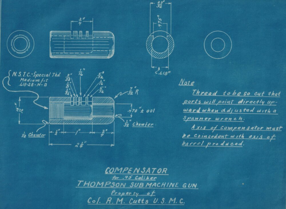

According to Tracie Hill's Volume I (as shown in the above post) the Marines attempted to install 1st pattern Cutts on their Colt TSMGs with poor results. U.S.M.C. Richard Cutts blueprint didn't foresee the problems associated with fitting the comp to the barrel boss. AOC replaced the bulged barrels and compensators when returned to them free of charge. Doesn't specify if the this meant the Marines sent their receivers along with the barrels. Opens up the prospect of AOC attaching the Cutts with the barrel off the receivers. Richard Maclean (Small Arms Review contributing writer) wrote in American Gunsmith that the witness lines on the 15,000 Colt TSMG receivers and barrels were used for initially installing the barrels and then removing them for "bluing and sight installation. "
