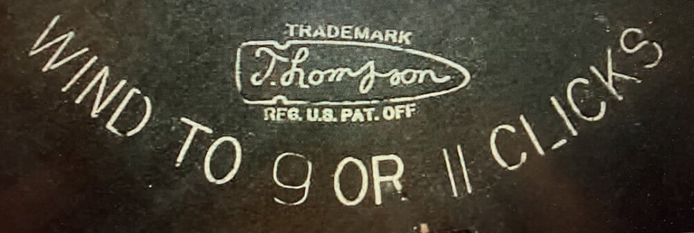

Time to dig into your old stash of drums. I am looking for a specific drum that Kahr manufactured after the Assault Weapons Ban expired (~20 years ago). These are not the drums with Export Only stamped on the back of the drum. They look like a typical L drum with a solid hub, except they have funky numbers in the winding instructions arc below the winding key on the front. Both the 9 and 11 use a strange font and size. Here is a pic of what I am looking for: If you have one of these drums, I would like to either buy it or trade for another drum. You can PM me or post in this thread if you have one of these drums you are willing to "share". Thanks for looking. Roger
Please Help me identify this drum
TSMG28 replied to Grease Gunner's topic in Thompson Submachine Gun Message Board
That is a third generation (latest) Kahr drum. The spot welding is definitely Kahr, and the front faceplate places it as 3rd gen. Roger -

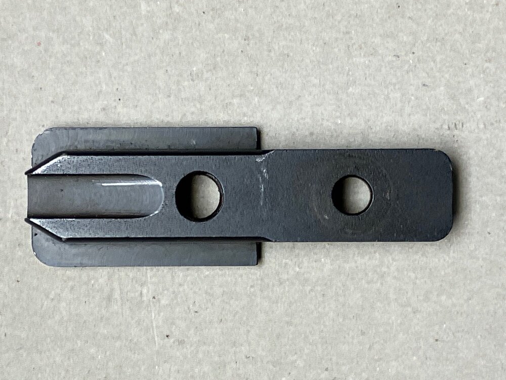

I have received some questions about the elongated loading slot on the drum magazines. Below are pics to help answer any questions. I will not have the tooling needed for the slot elongation set up for a couple months. Drum with standard loading slot on back. Drum with standard loading slot and TSMG adapter installed. Drum with elongated loading slot. Drum with elongated loading slot and TSMG adapter installed. -

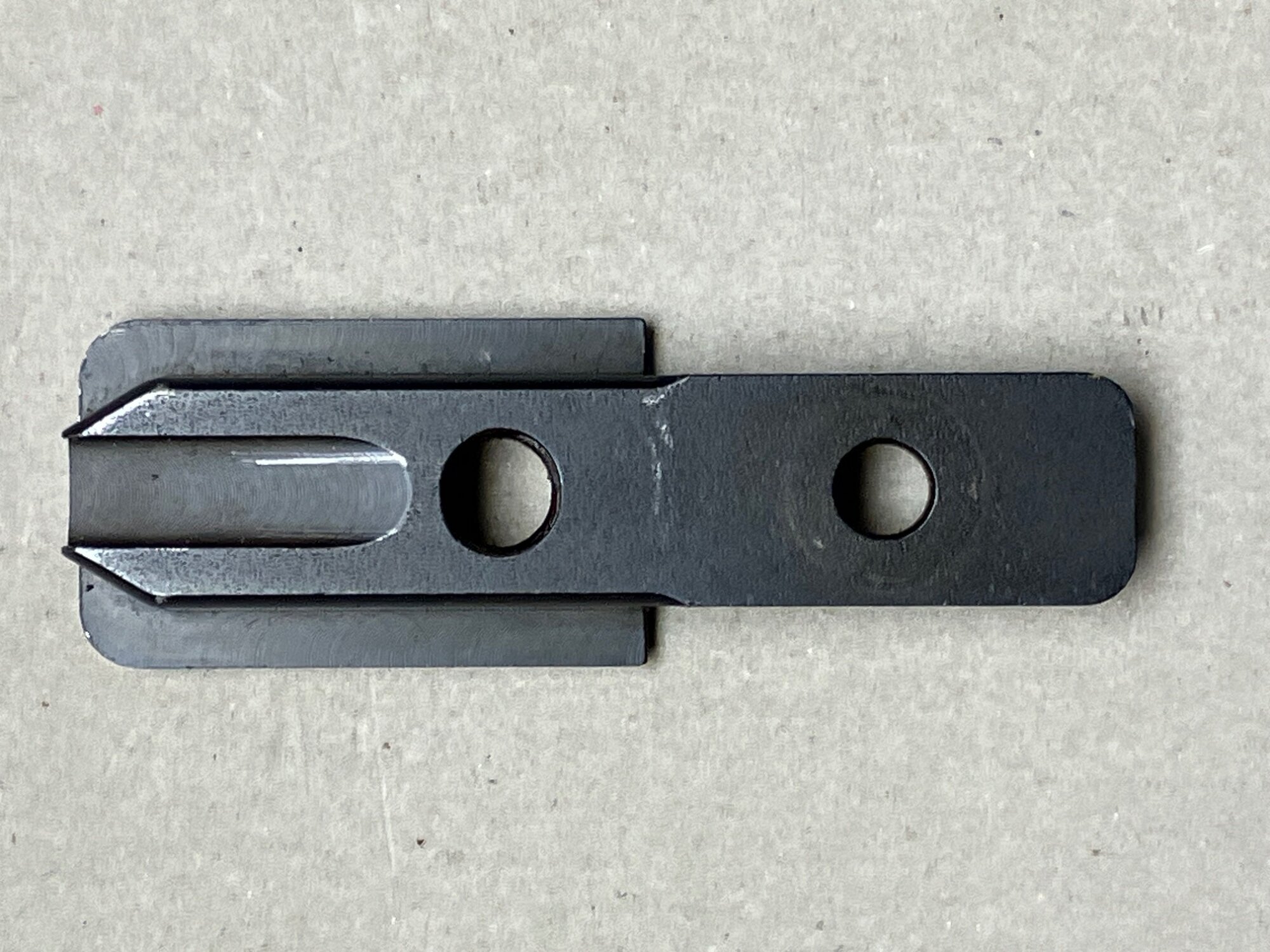

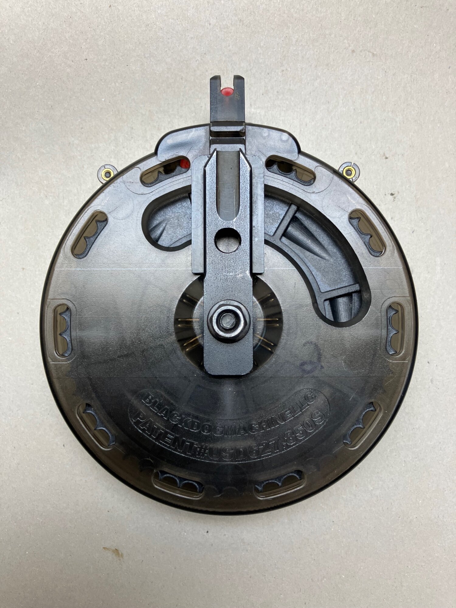

UPDATE: Merle .22 Conversion Kits
TSMG28 replied to TSMG28's topic in Thompson Submachine Gun Message Board
Below is a pic of a Black Dog drum with Merle’s adapter attached to the back. It also has the longer winding slot modification. Below is the adapter itself. As with Merle, we only plan to sell the adapter mounted on a drum.
