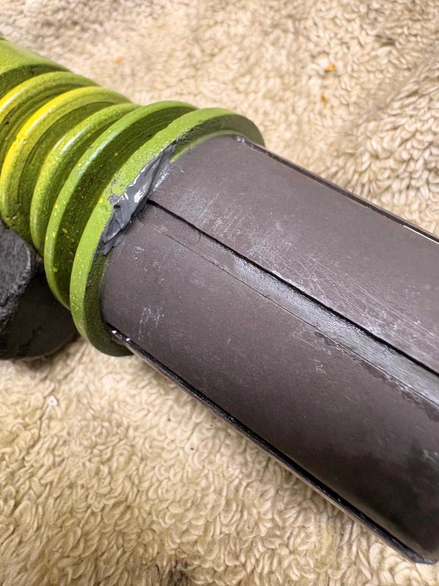

  1. After the dollop of epoxy is added the barrel has 0 slop now. Gap is even all around. My hope is by pulling the front grip into me it was pulling the barrel left with the slop it used to have . no idea how long jb weld will Survive but it can at least prove or disprove my plan to adjust things anyone own a barrel bender?
  2. I’ve owned 15+ old mags. None needed new springs rof is so slow. Mags keep up fine
  3. My riddle. If I shift the barrel 1/8th left. But the sights also moved 1/8” left. Did I accomplish anything? i figure the barrel attaches slightly loose so you can get the pin to click in easier. Maybe this was never super tight by design. It’s not sloppy. But has a slight wobble if you try to wiggle it. Here’s my dab of epoxy to test my idea
  4. It has slight slop where it fits the pin if you rock that slop you’ll find 1/64 slop where the barrel connects with the gun it equates to 1/8th+ movement at the end of the barrel. I’m going to add a few drops of epoxy to hold the barrel to the right. Firming up the barrel The barrel isn’t sloppy loose. But it’s not solid like a threaded barrel would be. Just the way the gun Is designed. It’s not a target gun Gun Is a FANTASTIC smg. If I can tweak the barrel right it will be awesome

  13. Tap the front sight right Try a small shim under the barrel to tweak it down ive had a smith put a blob of weld to pull a grease gun barrel slightly over. Worked.
  14. Gun now runs 100% 30 round mag works perfect Very enjoyable gun
