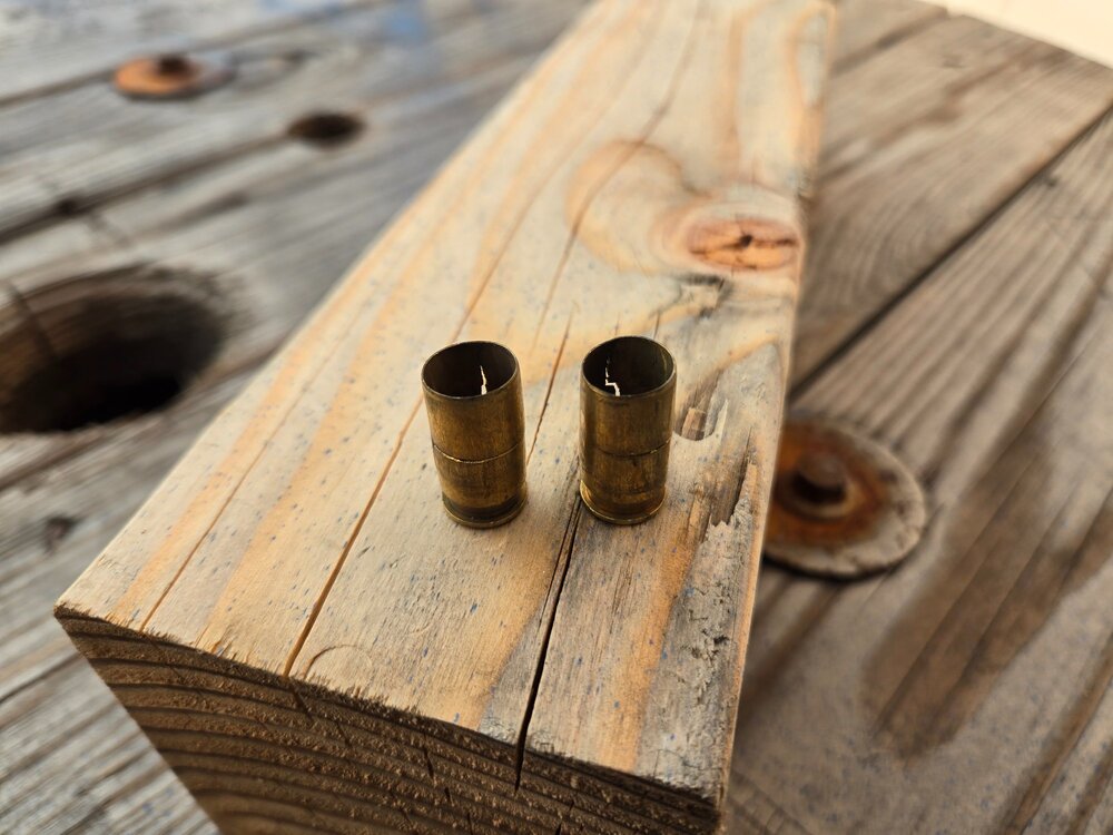

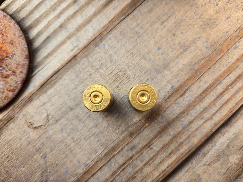

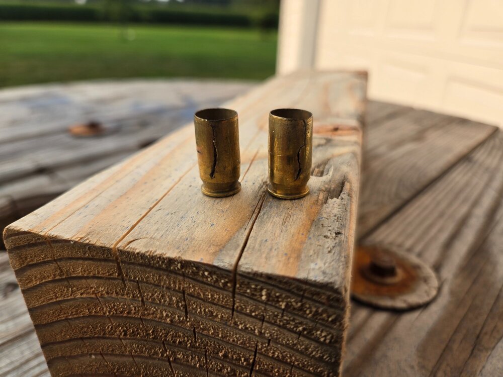

  4. I mic'd (using a ball mic, calipers are not reliable for measuring tubular wall thickness) at 11.5 thou at the case mouth the two cases I have from Winchester that split. I measured 10 other cases from various makers, all in the 11 thou range. This is not a material thickness issue. There is an underlying material chemistry, heat treat, other raw material issue, or process issue. Winchester will likely find the root cause or be able to determine it from samples. Whether or not they will be forthright with John I do not know. I am send my samples back to John, it's all him now.
  5. Another great time at Tracie's and the after party. Fred and I send our thanks to the Hill's and Phil Askew for the hospitality.
  6. John, digging through the brass I picked up at the spring TCA shoot, I found two pieces of Winchester very similar. Something in their process is not right.
