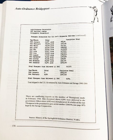

Date for a M1A1 reciever by serial #?
Frank I. replied to p51's topic in Thompson Submachine Gun Message Board
I would ESTIMATE that it was made during the last months of production, due to the 800-thousand serial number. I have never documented any M1A1s with a higher s/n than the 800k-range. The last Thompsons were delivered in February 1944. (Thompson production had be extended because of problems welding M3 SMG receivers together) Also, I would GUESS that it is an Auto-Ordnance Bridgeport mfg, not Savage, because of the late s/n range with the added A1 suffix and the serial number that is somewhat misaligned, both are indications of A-O mfg. American Thunder III, M1 chapter page 156 -

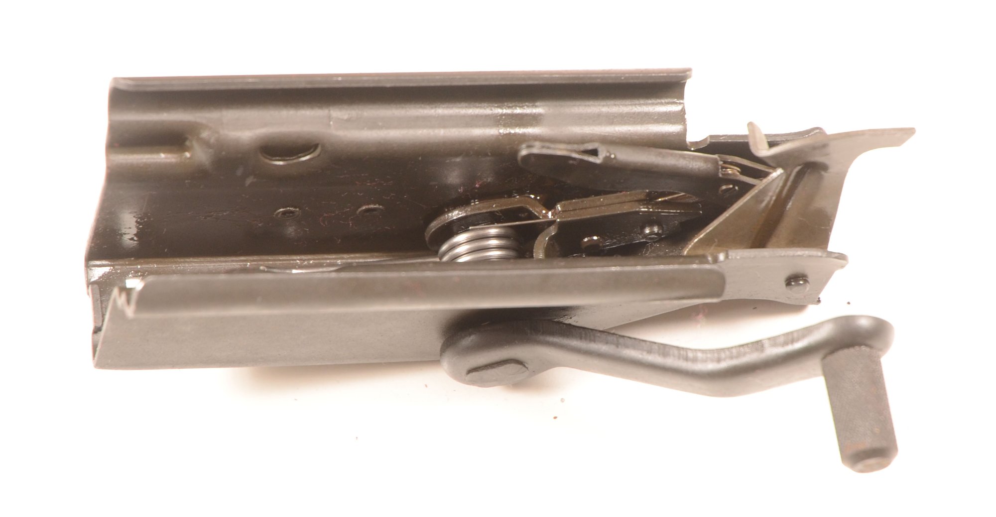

Installing cocking handle spring
Frank I. replied to Got Uzi's topic in The U.S. M3-M3A1 Message Board

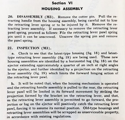

OLD topic, but again, may help someone... Attached is a picture of the cocking handle spring tool... John, with your skill level you couldn't make this simple tool? ? -
Grease gun ejector with a hole
Frank I. replied to Annihilator's topic in The U.S. M3-M3A1 Message Board
Old thread but, I think that is the early style M3 ejector / cocking handle that resulted in problems. The replacement can be identified by the ejector having a 90-degree bend at the back to keep the cocking lever from moving too far forward. The lever is also updated on those housings. -

I realize this is an OLD thread, but this info MAY help solve someone's similar problem When switching from FA to semi be sure to retract the action bar (cocking handle) 1/4" to disengage the auto connector lever from the action bar. (as per the instruction manual) Failure to do so will result in the bending of the sheet metal L-shaped "leg" part of the selector, that is designed to lift the auto-connector lever off of the action bar. Once the leg is bent, the auto lever will remain engaged with the action bar, causing the weapon to fire in full-auto mode in the semi-auto position.
