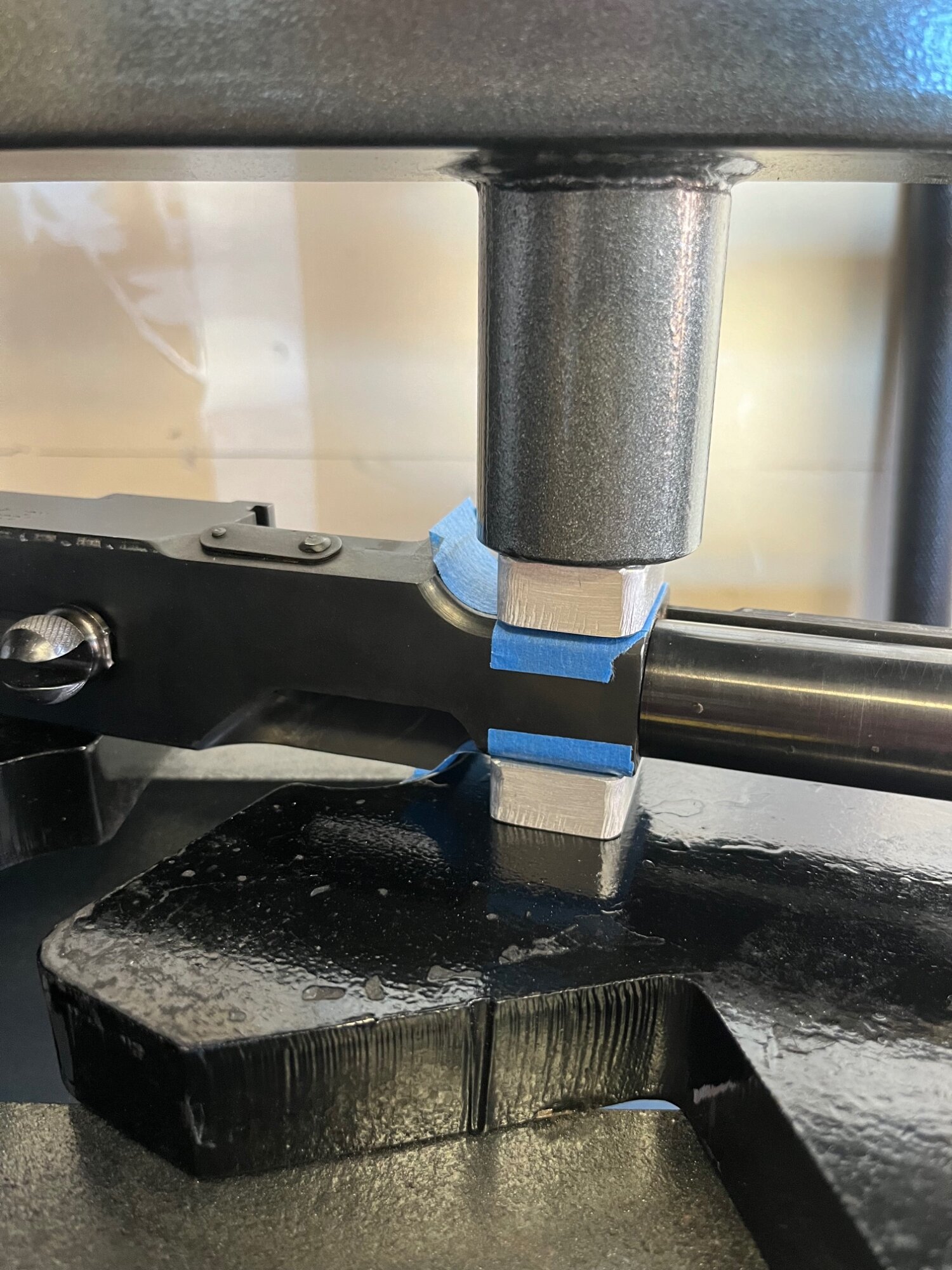

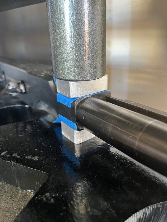

Yup! This works with the “lightweight”Al receivers. Ask stated you can use the included receiver spacers to grab the receiver top and bottom or right and left forward of the ejection port right by the barrel. And I am still making them. Feel free to check out the website https://patriotfabanddesign.com/ if you’d like to order. Let me know if you have any other questions.

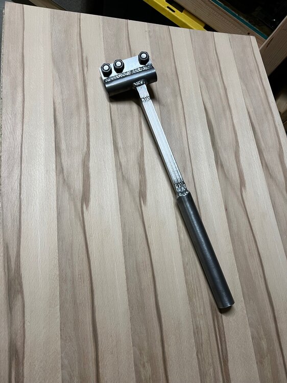

side note (and quick plug) I made a first gen handled Thompson barrel wrench for a customer this week and made a spare so if anyone is in need for an original wrench it is $175 shipped in the us. I almost always stock the latest gen that is compatible with the 1/2” breaker bar and those are still $120 shipped.

I have a barrel wrench from a Doug Richardson design. To make sure you don't chance a mark on the barrel mine needs a paper business card to insert between the barrel and tool. FWIW
Appreciate the concern. I usually recommend a barrier as well. I’ve used paper and / or painters /electrical tape as an intermediate surface. A business card might be too thick for my wrench.

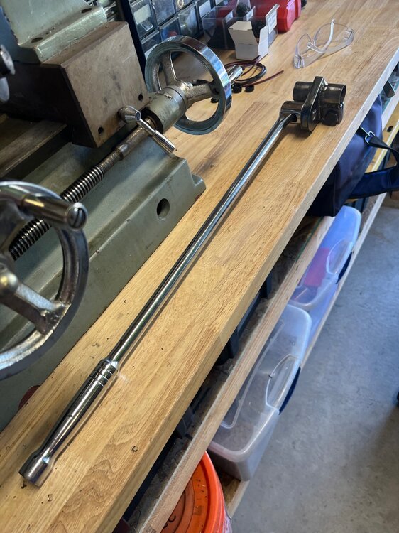

new YouTube video of said barrel wrench

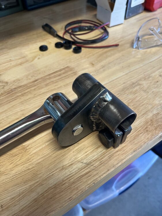

Well I am changing things up a bit and I think this will benefit most customers. The new standard barrel wrench will be compatible with a standard 1/2” breaker bar. This brings my material cost down, reduces welding time, and will allow me to use standard packaging. These new wrenches are going to start at $120 shipped in the lower 48. All wrenches come with 1/2” aluminum receiver spacers and instructions.
I will still offer the last wrench style with the built in handle if you prefer. Please see the pictures attached and feel free to ask any questions. If interested, please inquire at patriotfabanddesign@yahoo.comBreaker bar not included.

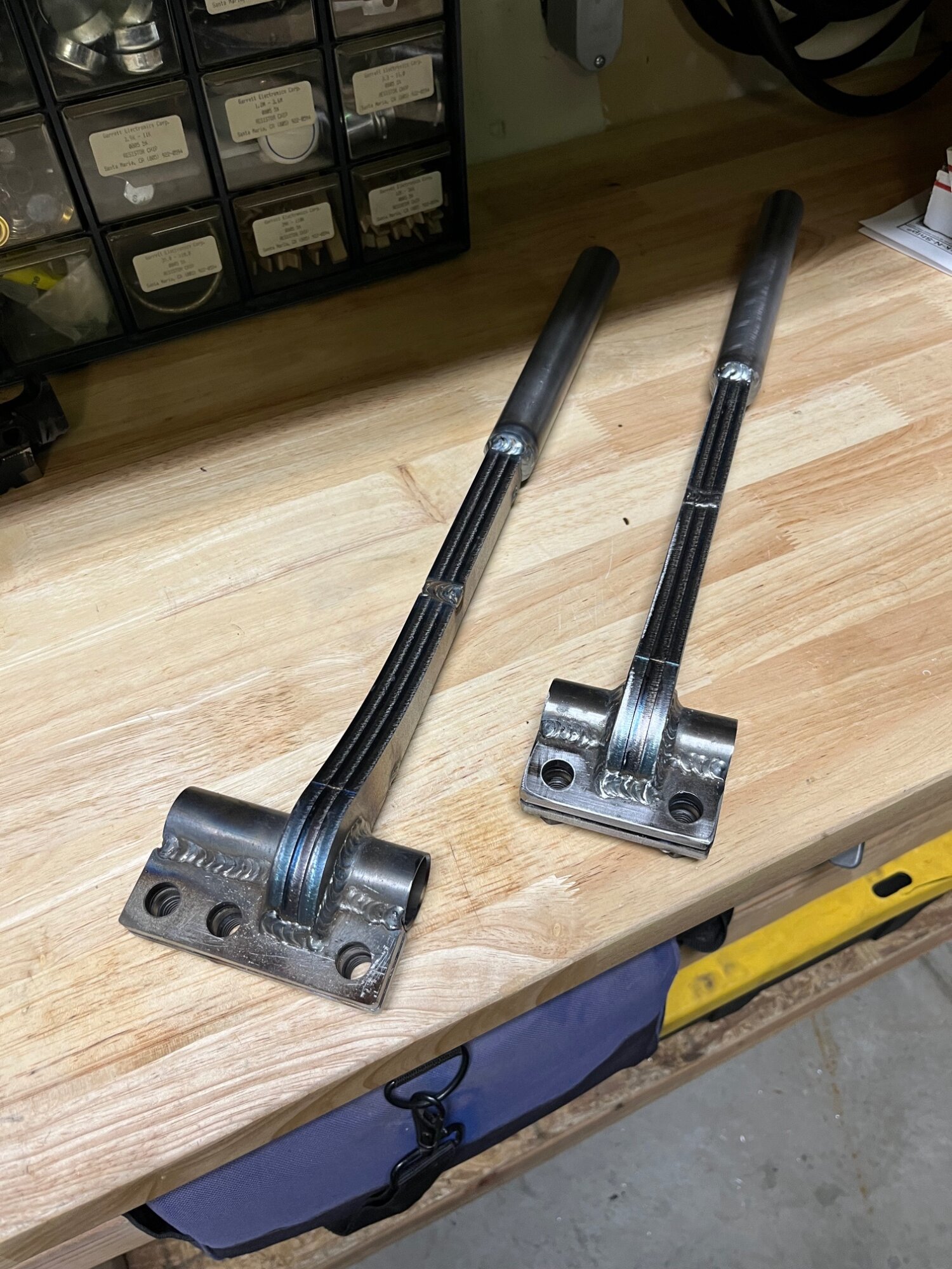

Sorry for the delay in response. Both the shorty and the standard wrench variants are $150 + shipping. Some big changes regarding the wrench options that I will post about below!
I’ve started making two different types of barrel wrenches. One is a “shorted” version for removing SBR barrels, MG barrels, or parts kits barrel stubs. There is no benefit of using my original 4” barrel wrench on 10.5” barrels because the barrel taper on 10.5” barrels starts around 2”. So I’ve made a 3” “shorted” (shortest I could make it). One additional benefit to the “shortened” wrench is that it is easier to get around the grip tang then the 4” model, less room for it to bind before the grip tang returns to its home position. The original 4” wrench is still the suggested tool for removing S/A 16” Kahr barrels to maximize barrel surface area contact, but either wrench will work for installing your new barrel, whatever the length.
Let me know if you have any questions! I also currently have wrenches in stock ready to ship!Thanks!

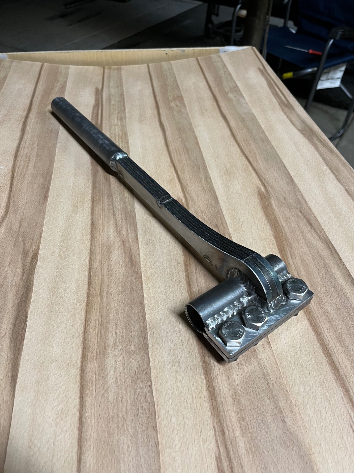

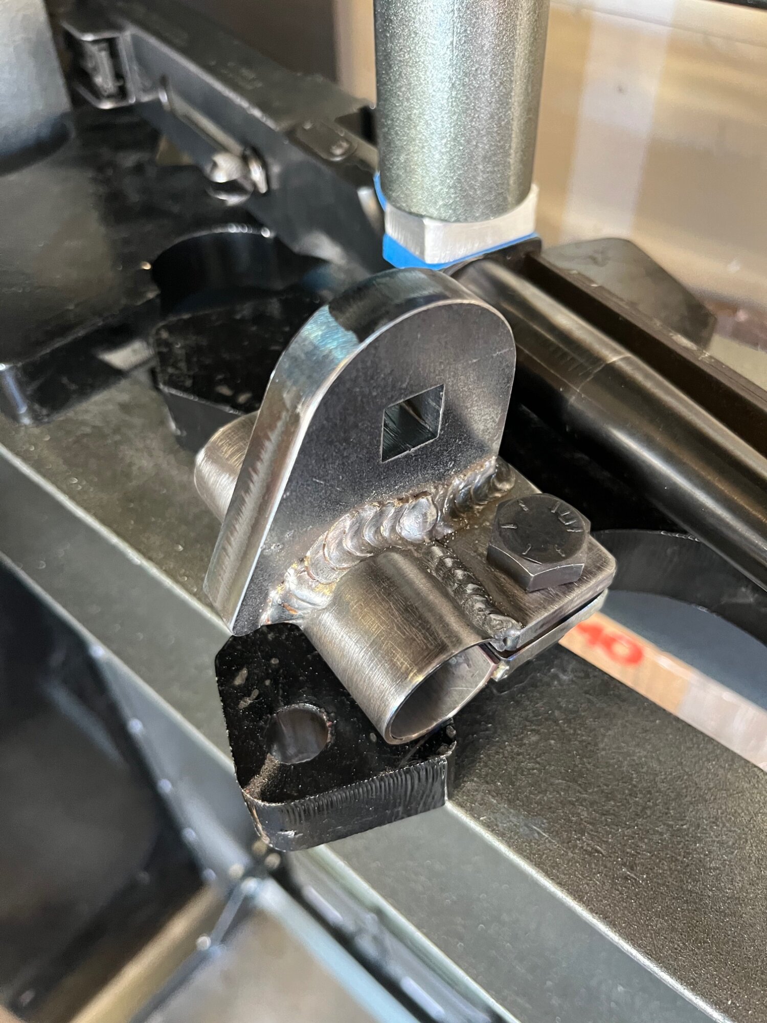

For anyone who is curious, I am still making these. I am very grateful for the response thus far and I have been trying to keep these in stock. I’ve made a few changes lately to optimize performance that I wanted to post about.

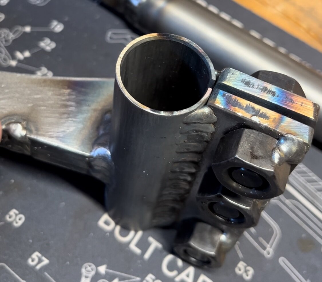

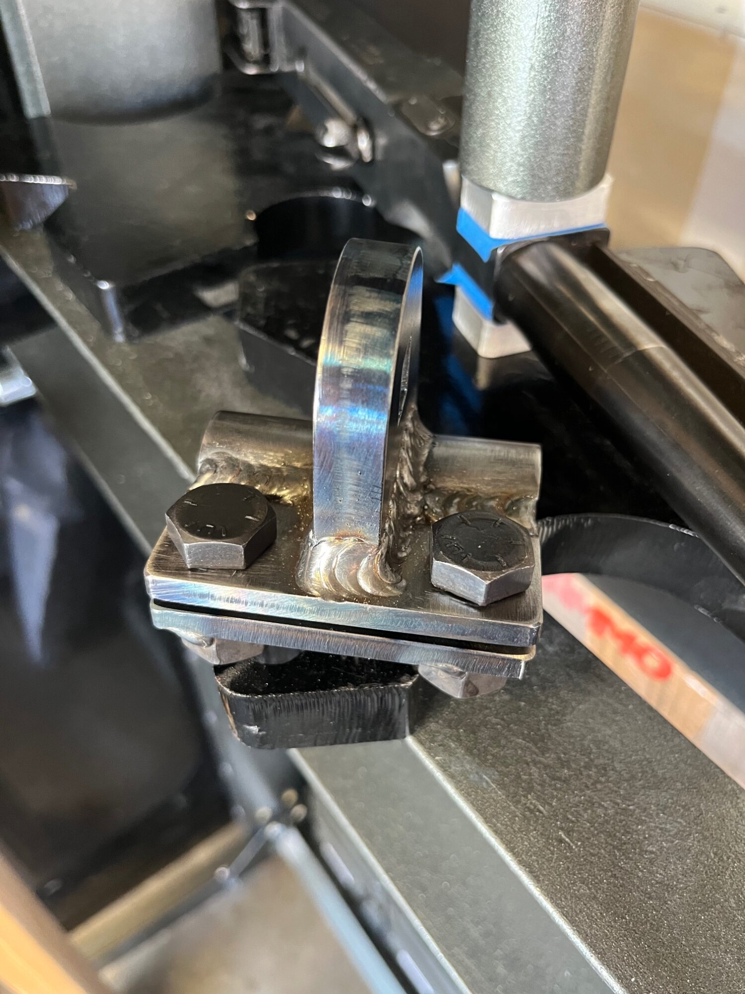

1. I have switched over to grade 8 hardware to handle higher stress applications.
2. I also began welding the nuts to the bottom side of the wrench so that only one box wrench or socket is needed to tighten the clamp.
3. Lastly, I added a mfg process to turn the ID on my lathe to add a nice bevel prior to welding the wrench together. This bevel aids in installation for all Thompsons but this addition was fairly necessary when working on 1928 models with the square profile fins. The problem comes from trying to stay concentric to the fins while fighting the grip tang. If you have one of my wrenches and have a 1928, this bevel can be added with about 10 minutes of dremel work with a 1/2” diameter 60grit drum sander.
The cost for the wrench is $150 + shipping. This includes the receiver spacers which can be used to “space” the nose section of the receiver off the vice or shop press.
