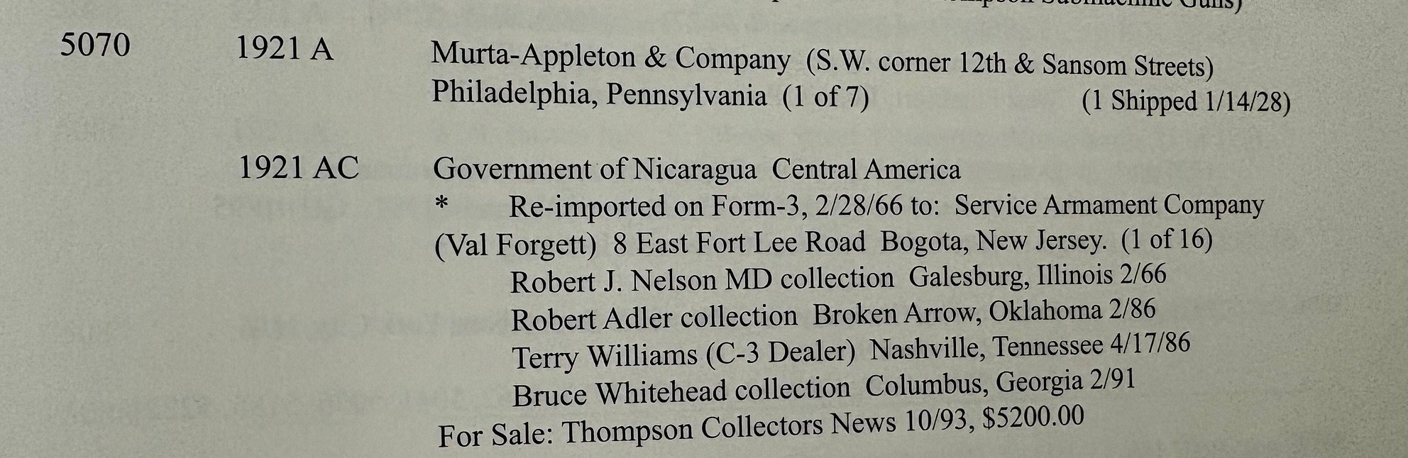

valman35, NO 5070 has a very interesting history. It appears NO 5070 made its way to Nicaragua. We look forward to pictures. There are a lot of very knowledgeable people on this forum. I have thought about doing a short Thompson newsletter story on the Pennsylvania State Police Thompson guns, especially the early ones. I look forward to seeing the inventory number on the butt stock. -

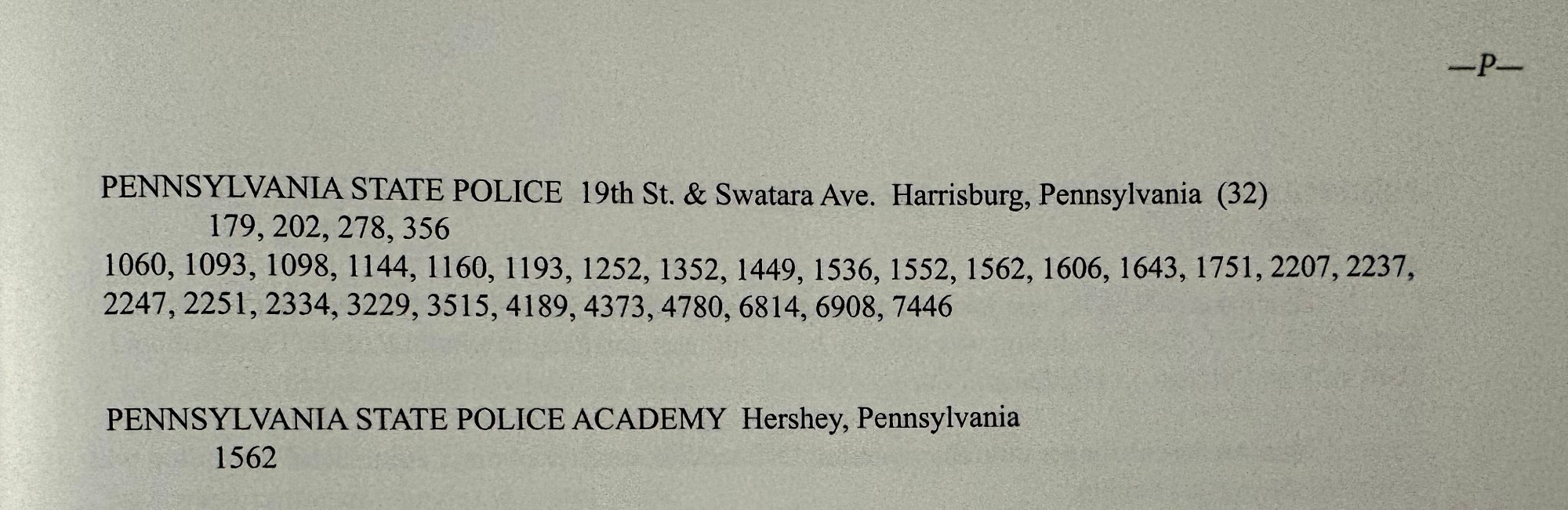

valman35, Welcome to the Thompson forum on MachineGunBoards.com. If you like Thompson submachine guns, this is the place to be. I have followed the Pennsylvania State Police Colt's for some time now. The early ones (NOs 179, 202, 278, 356, 1093) certainly did have sling swivels and Type 2 compensators. While I have not seen pictures of them all, I don't believe all were equipped with sling swivels. There are a number of these Pennsylvania State Police Colt's in the civilian marketplace. I don't have time tonight to check all my files. Here is a list of known Colt's: Which one is yours? When the Colt is yours, I can help you with the FOIA request. -
