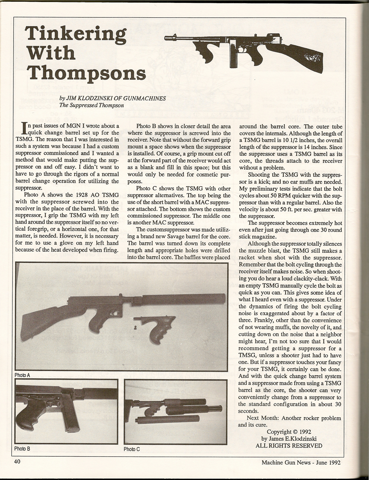

dam6 Posted July 12, 2009 Report Share Posted July 12, 2009 machine gun news, April and June of 1992 " tinkering with thompsons" maybe someone can post the articles Link to comment Share on other sites More sharing options...
full auto 45 Posted July 13, 2009 Report Share Posted July 13, 2009 Here it is from June 92. Link to comment Share on other sites More sharing options...
