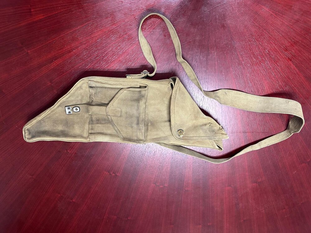

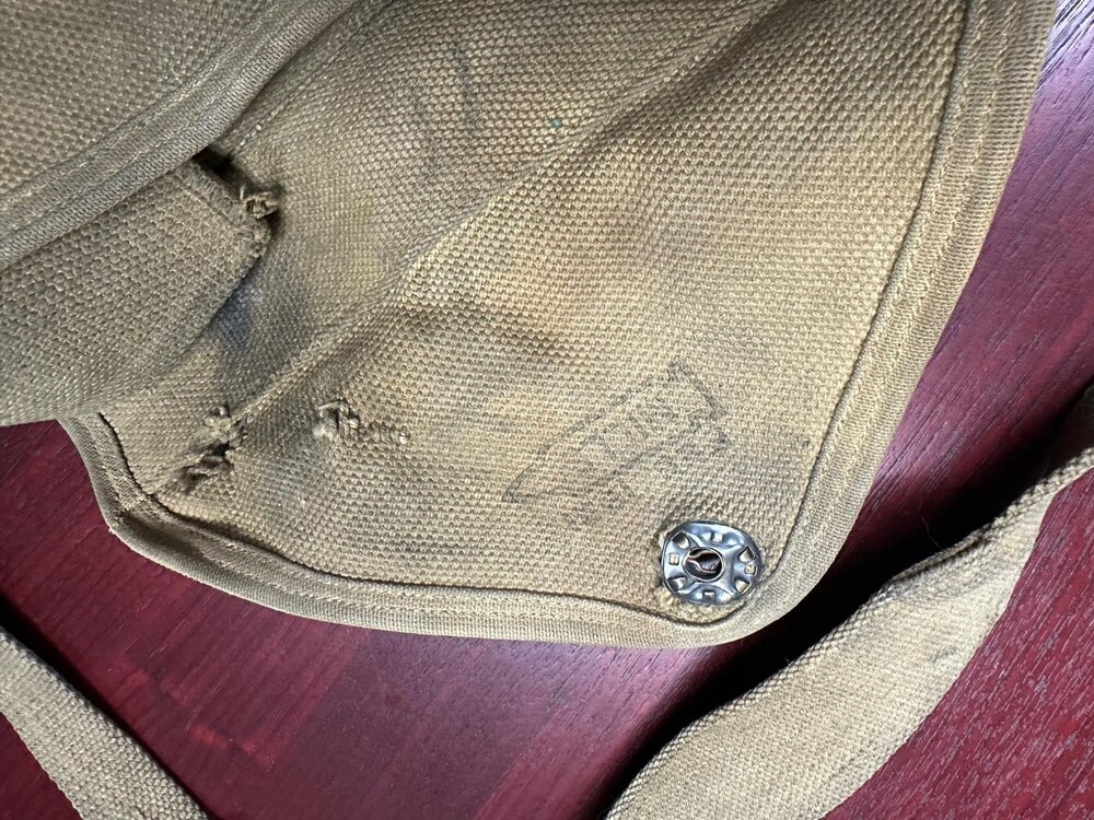

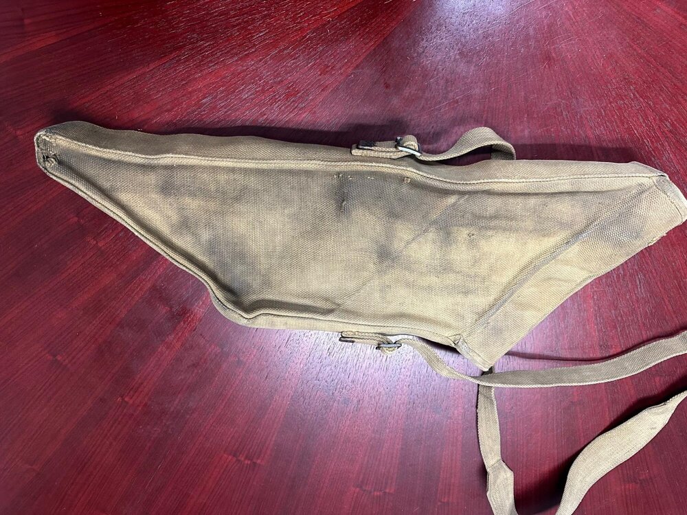

Dpedersen Posted February 15, 2025 Report Share Posted February 15, 2025 On 11/27/2012 at 8:11 PM, ThompsonCrazy said: I've cleaned countless WWII canvass items with great results. Most of these items were gently used or unissued but stored improperly. Here are some key tips: -Only use cool water -Do not scrub the material under any circumstances. The dye used will stay put with soaking only but once you scrub the dye will come off and you will be left with spots. -The best detergent I have found is Palmolive dish soap or equivalent. For a piece like yours I would fill up a bathtub with about six inches of cool water, add about two to three capfuls of detergent, agitate the soap and water with your hand until mixed nicely. There should be very little suds on the top but just a nice soapy solution. Place the piece in the bath and let it soak for a couple of hours checking on it periodically with a visual inspection and swirl the water around the piece to see how it looks. You may find that soaking for a few hours gets the majority of the soiling off. If there are any heavy stains they will not come out. You can gently work the piece with your hands to flex the material but again do not scrub or focus on one area. The key is to agitate the soapy water and piece to loosen and remove the dirt, grime, oil and light grease. Once you are done you can either rinse the piece off with cool water or drain the tub, rinse out the dirt and refill with a fresh cool water rinse to get the majority of the soap out by resoaking. Once you are done rinsing I would place the piece on a wooden broom handle upside down almost like the broom handle is the Thompson and let it drain and dry. What ever dirt which is left in the piece is left. Just repeat, "the enemy of good is better"! You are not going to get the piece to look like new but you can improve it by 25-30 percent in my experience. The soap smell will even go away once dry after a few days and the beautiful smell of vintage canvass will return. The key is that you are improving the piece not restoring to new. You have to be happy with an improvement on this piece. Try this at your own risk of course but if you follow these steps it will be better than what you started with. As mentioned above you should practice on another piece like a mussette bag (with the mussette removed of course;-)) or a haversack, shovel cover, etc. Stay away from any pieces like canteen covers as the lining material will bleed through. I'm sue we all have a dirty 5 cell mag pouch we can practice on. You will get a slight yellow tinge to the water on a large khaki piece and a significantly darker tinge on OD pieces. This is completely normal and expected. If you become uncomfortable with the color of the water just stop, rinse with cool water and let dry. My opinion is that the khaki pieces come out much better than OD. When rinsing just let the water flow gently over the piece. No pressure washing. I prefer the clean cool water soak method for final rinse. Your enemies are: -hot or warm water (seem to release the dye much more aggressively, exponentially even and hot water completely removes oils on small leather pulls/pieces drying them out miserably) -scrubbing by hand or brushes (either will take the surface dye off) -harsh chemicals. Remember what oil clean up crews use on animals. Palmolive is very gentle. Take before and after photos. TC Bringing an old post back to life! Scored an early Mills gun case without the buttstock provision and it was beyond filthy! Used this trick and cleaned it up very well. Still stained some, but way better than when it arrived. Really good info in this post, thanks! 1 Link to comment Share on other sites More sharing options...
TD. Posted February 15, 2025 Report Share Posted February 15, 2025 Very nice! +1 Link to comment Share on other sites More sharing options...
Dpedersen Posted February 15, 2025 Report Share Posted February 15, 2025 Thanks Tom! Link to comment Share on other sites More sharing options...
Colt Chopper Posted February 15, 2025 Report Share Posted February 15, 2025 Big Score. that makes maybe 4 or 5 that I have seen !!!! Link to comment Share on other sites More sharing options...
Countryboy77 Posted February 16, 2025 Report Share Posted February 16, 2025 I seen a power washer work wonders on web gear,stay at least 6" away and of course know the powlwer of your washer.The washer used on canvas was at tye car wash and after a sun dry it was good as new Link to comment Share on other sites More sharing options...
