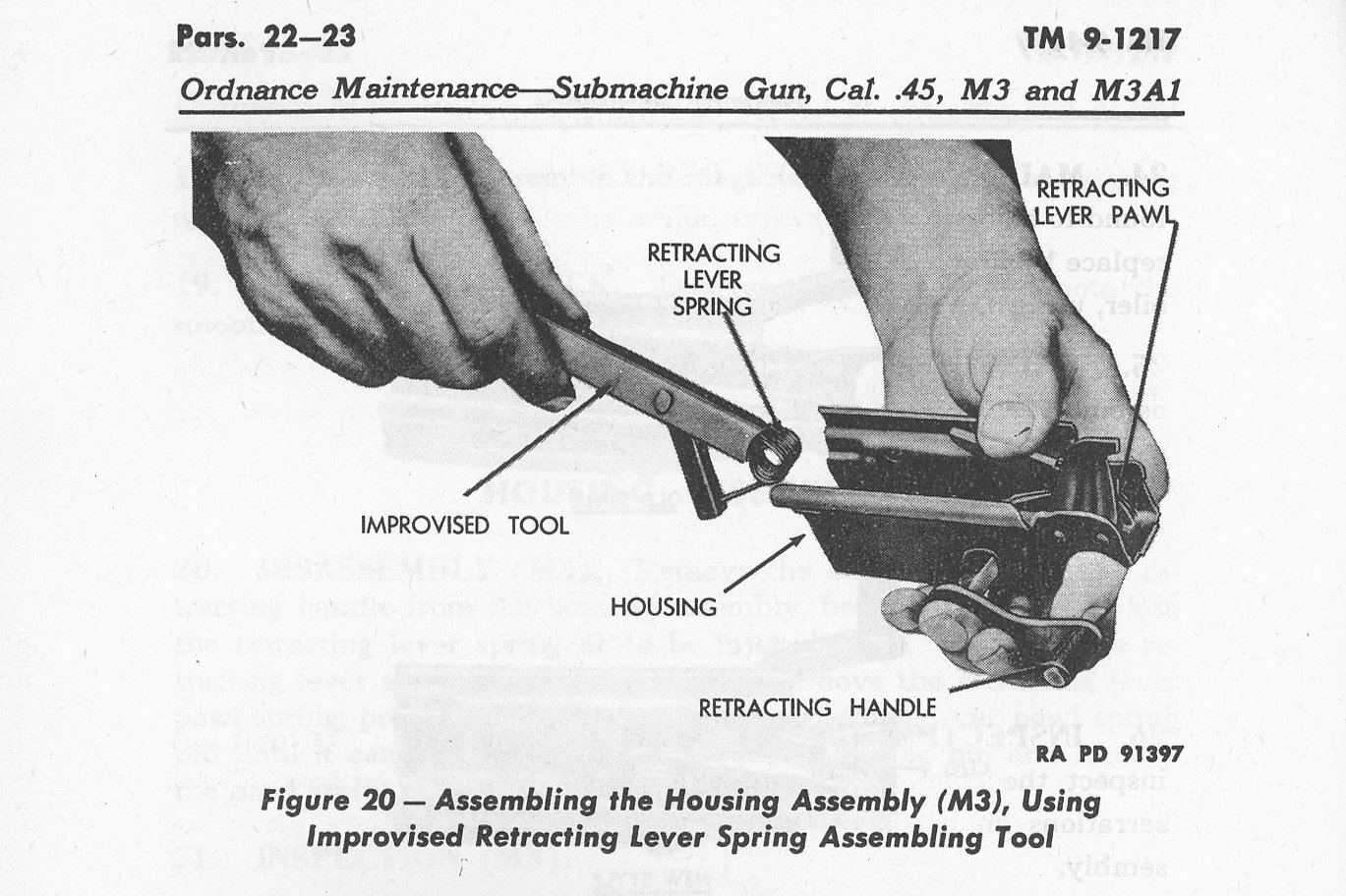

Got Uzi Posted August 10, 2015 Report Share Posted August 10, 2015 Anyone have a trick to installing a new cocking handle return spring? I need to replace the one in my original housing as its shot. I am thinking a slave pin might be needed but I figured I'd ask to see if someone else has "been there, done that" Link to comment Share on other sites More sharing options...
emmagee1917 Posted August 11, 2015 Report Share Posted August 11, 2015 That is one of the few sub-assemblies of all of my guns that I've never had apart .Good luck .Take a lot of pictures for a how-to afterwards .Chris Link to comment Share on other sites More sharing options...
Got Uzi Posted December 22, 2015 Author Report Share Posted December 22, 2015 Well I finally took the time and got my original one back together after spending 1 1/2 hours fighting with it. That is not an easy task when you don't have the nice little tool for it. Link to comment Share on other sites More sharing options...

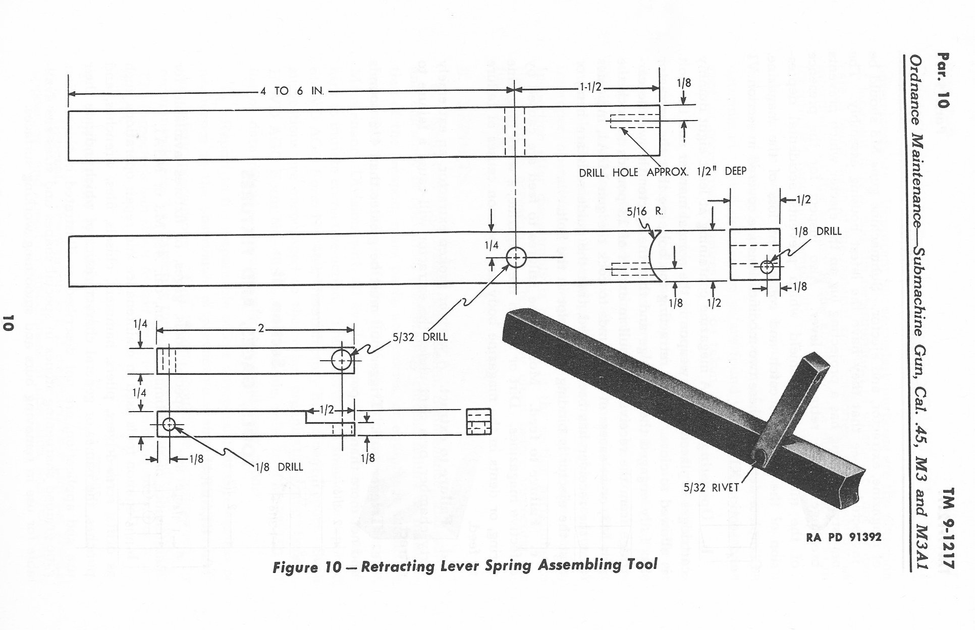

Frank I. Posted June 25, 2025 Report Share Posted June 25, 2025 OLD topic, but again, may help someone... Attached is a picture of the cocking handle spring tool... John, with your skill level you couldn't make this simple tool? ? 1 Link to comment Share on other sites More sharing options...
Got Uzi Posted June 25, 2025 Author Report Share Posted June 25, 2025 I made a few of these years ago. 1 Link to comment Share on other sites More sharing options...
skoda Posted January 16 Report Share Posted January 16 (edited) Frank, Thank you very much for that tool drawing. My friend came to me with a cocking pawl assembly that he couldn't get back together and neither could I. I looked around and found your posting with the tool drawing so I made one and it worked well. They must have had something like that at Guide Lamp to put those things together. That is one stiff spring. Edited January 16 by skoda Link to comment Share on other sites More sharing options...
