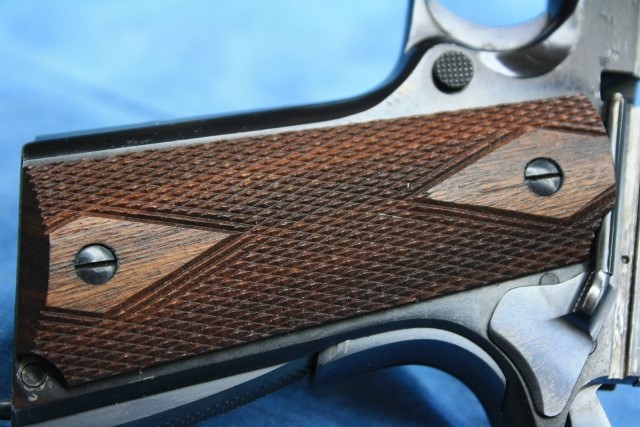

A good friend introduced me to this group, and specifically to this discussion topic. From what I've read so far, I agree with him entirely that the contributors here are far more academically inclined, and less prone to loudly assert personal opinion as fact, than what is typically found elsewhere. It is for that reason that I'm going to lay out a recent purchase, warts and all, to see what sort of comments I get. Please forgive me for creating such a long posting, but this one is a bit complex. Perhaps if you read it like a firearms mystery story, it will be easier to plow through.
In brief, this gun had been offered at auction for awhile. The seller's opening bid was too high, and nobody was nibbling, so I decided to contact him. We came to an agreement on a price. It was still higher than I really wanted to pay, but not horribly outrageous for an exceptionally nice looking Colt Government Model with some history. The challenge was to pin down that history.
In brief, what I hoped I was getting was an Argentine contract Colt from about the 1924 period--one that may have been built partially of WWI surplus parts (as is another "lettered" Argentine Colt that I have), and one that is in exceptionally fine condition.
What did I actually get? That's the point of this posting. Is it a fake? Is it a fluke? Is it something legit, but unusual? That's what I'm still trying to determine. Let's title this:
The Case of the Mystery Marina Argentina Colt
Here's what I have--or think that that I have--so far as can be determined. Corrections are welcomed and encouraged. I'm not trying to turn this into anything that it's not, but it's difficult to determine what it actually is.
OVERALL
On the surface, it's a very nice Marina Argentina contract gun made by Colt. Both the frame and slide appear to be in "as new condition," with very minor marks. There are no import marks on this piece.
THE SLIDE
The slide seems to be dead-on original and as-new. All edges are crisp, as are all markings. The markings on the slide appear to be correct as from Colt in about 1916. The roll marks appear to be correct, and the c. 1916 time period "pony" stamp still shows clear signs of slightly raised metal that was displaced from the stamping. I've looked at a lot of older firearms, and I'm pretty sure that the slide, at least, is legit.
THE FRAME
There is no sign that I can discern of pitting or markings having been buffed out. It's uncertain if the frame has been re-blued, or not, but it was done quite well if it has been.
The serial number on the frame turns out to be correct for the same 1916 time period as the slide, but Colt's archives show that this gun's serial number was supposed to have been shipped to, "The Government of Russia" in late 1916. There are no British or Russian marks on the gun, however, as there should be if this had actually been sent to Russia as a lend-lease firearm. Still, the serial number does fall into a block of numbers also used to send some contract guns to Argentina. One possibility is a duplicate serial number--Colt says that did happen on occasion--but there are other problems, too.
Most obvious is the fact that the frame (and the gun in general) has most of the 1911A1-style modifications, when the serial number and the slide markings indicate that it should be a 1911. Some of these can be explained away as later add-on upgrades, but not all (such as the first mentioned in the following list).
Here are some of the 1911A1-style characteristics:
-- There's a crescent-shaped relief cut in the rear area of the trigger housing.
-- It has the arched mainspring housing.
-- It has the short trigger with the checkered face.
-- The font for "Government Model" and the serial number on frame appear to be factory-accurate, but are of a style believed to have been introduced after 1916 (around 1924).
-- The thumb safety is of the type used on the 1911A1.
Here are some of the 1911 characteristics:
-- Wide spur hammer with checkering.
-- The slide has the correct sights for a 1911 made in 1916.
-- The slide has the correct patent and "pony" marks for a 1911 made in 1916.
-- The stocks appear to be correct for a 1911 made in 1916.
-- The front slide relief cut has the smaller radius.
-- Slide stop has checkered thumb piece.
It turns out that this gun went through a regional auction by RIA about 2 years ago. They rated it, at that time, as "professionally restored or re-blued". That may be the case, but if so, the work was excellent. I've checked with Turnbull, and they were kind enough to search their databases. It has not gone through them.
One of the main questions in my mind, at this point, is that if this is faked, or partially faked, why would someone go to all that much trouble for a gun that wasn't really worth a whole lot a few years back? Almost any U.S. Military Colt would have fetched a much higher price. Even today, what I paid for the gun was substantially less than what a quality restoration would cost--and I'd have to start that process already owning a firearm.
What markings are on the inside? I don't know yet. I'm waiting for a good day to strip it, clean it very well, preserve it, and photograph it. I do know that there appears to be a "B" mark showing under the hammer, above the firing pin stop. I haven't been able to locate a source explaining what that mark would represent. I'll be posting internal photos soon, but now let me show you the external stuff.
I hesitate to say this, but the only explanation that I can come up with, that seems to fit all the evidence, is that it could have been a Colt employee-made gun assembled from left-over contract parts. I've read somewhere that happened in the earlier days. Colt says that they also have heard that, and it wouldn't be surprising if it was confirmed, but they (and I) don't expect it could ever be proved insofar as this gun is concerned. I'm just throwing that out as a possibility.
Popcorn, anyone? This might turn into a show! Don't worry about my feelings. Just be honest. I've done well enough on most purchases over the years that getting a smack in the wallet may have been overdue. I just want to figure out what's going on with this gun. Whatever that turns out to be, this is a really pretty piece that someone tuned up rather nicely. The trigger is as smooth as warm butter. It doesn't appear to have been shot much, if at all. I'll know more about that when I get inside and start cleaning.

Well, it has a very desirable pre-war National Match barrel that's worth a bunch. The type of serial number (less the C) is what would have been on late 1930's M1911A1 pistols, less one digit which is why I thought one was missing. The C is a mystery and the slide is from a much earlier gun. Here's my theory: this was a mismatched military gun that someone sent back to Colt's before WWII and asked that it be reworked. A match barrel was installed, the whole thing refinished and the markings on the frame were replaced. I used to own a fairly similar gun that even had the finger relief cuts put into a WWI era pistol. During the depression Colt's would do all kinds of custom work to try to keep their employees busy. Ultimately, all we can do is guess because the factory did not keep the rework/custom work records. Special features added to guns when originally shipped will be in the shipping records but they don't have information on guns sent back. Your is a fascinating gun. Below is a quick picture of mine with some similar anomalies. Note they added the "National Match" rollmark and Stevens sights to a WWI era military slide.
http://img.photobucket.com/albums/v101/kwill1911/National%20Match/IMG_0001.JPG_zpsmh0cffig.jpg
Edited by kwill
  • Upvote 2
I think kwill's assessment of the pistol is outstanding. It makes complete sense. We are often so blinded by "how it was when it left the factory," that we forget about the potential return trips the firearm might have made. Colt wasn't thinking of collectors at the time the pistol may have been returned, and we are left only to reference the records that exist today.

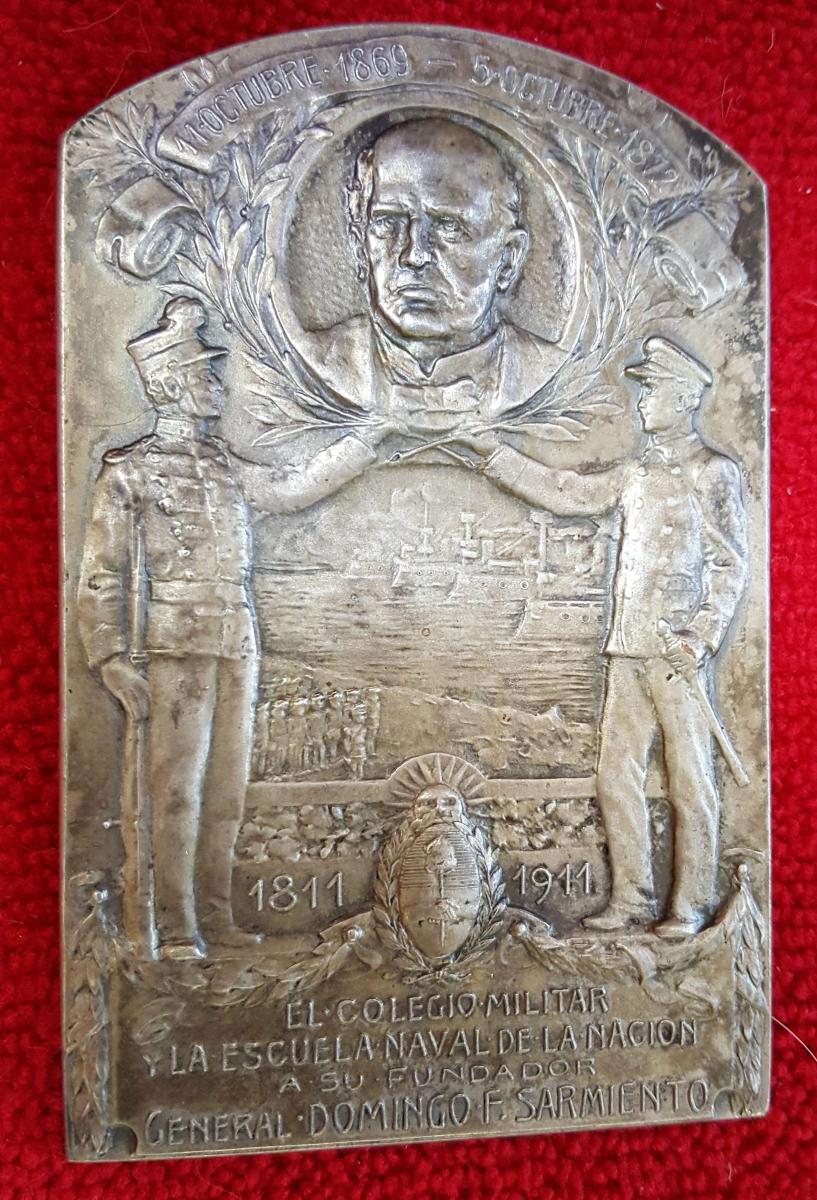

Now let me introduce another couple of pieces of info. I didn't want to throw the first one into the mix at the beginning, because it might have served as a "red herring" and distracted from looking carefully at the gun as an independent object.
This firearm came as a set of artifacts that included a display case, a key to the case, and an Argentine medallion. I can't really tell much from the case, so far. The style of manufacture and hardware, unfortunately, have been essentially the same for decades. The case appears to have been around for a number of years, but whether that means it was made in the '30s ... or the '80s ... is hard to determine.
The medallion is a fairly large chunk of silver commemorating the 100th anniversary of the Argentine Naval Academy (1811-1911). The case was purpose-constructed to house both the gun and the medallion.
Again, I didn't want the presence of this medallion and the case to be a red herring. It might be very much related to the history of the gun, or it might have just looked like a nice way to pair two artifacts together to make an interesting display. Unfortunately, there's a fellow currently creating attractive displays in new cases to make his guns more marketable. These cases are engraved to present the "history" of the guns--which are sometimes not very collectible models and/or are not in particularly appealing condition.

Colt didn't use that italized serifed font until after the 1924 switch to the new A1 features. For your SN, which would have originally shipped in 1916 they were using a straight up non-serif (Gothic) font. I think Colt used a new frame when they reworked the pistol in the 1930s but put the old SN on it. Usually when they did that they put an "R" at the end of the number to signify that the frame had been replaced but they obviously didn't in this case. I don't know about the Argentine connection, which seem tenuous to me but all this is really a mystery and this guess work is kind of pointless, I suppose. That's what makes collecting fun.

David Albert - I'm attaching some photos of the case, but need to take others when I'm outside in the light. It has a glass top, and that mirrored everything in the room. I can show the interior, the lock and the wood, though. I've had some experience with restoring antique musical instruments, and know that hardware design for cases doesn't seem to change a whole lot over time. I've even got a source for a place that sells hardware that is surplus from the 1920s--left over from a bankrupt company--so it's not hard to make older cases out of new materials. If I had to speculate, though, based upon materials and construction, I'd have to say that this one *might* go back into the '20s,* but is certainly in period for the late '40s to early '60s. I'd be comfortable guesstimating that this case was made in the '50s, or earlier.
[*Cases of similar construction can be identified that were used to hold and display watches and other items in jewelry stores that are from the '20s and '30s -- but it's really hard to tell. Hardware that looks fairly new can either be old and well-stored over the years ... or it can be fairly new. It looks like someone else tried to find marks on this case and failed.]
The medallion was made by Juan Gottuzo, a rather well known craftsman in Argentina. It would be typical for such a medallion to have been stamped in bronze, silver, perhaps silver-plated bronze, and gold. I have found no examples of this in gold. Based upon some small scratches and one "dinged" corner, this one appears to be silver. In the same time period, in the U.S., it was not uncommon for silver medals to be made of "coin silver": literally, melted silver currency, as it was plentiful, sturdy, made to be stamped, and relatively cheap back then.
