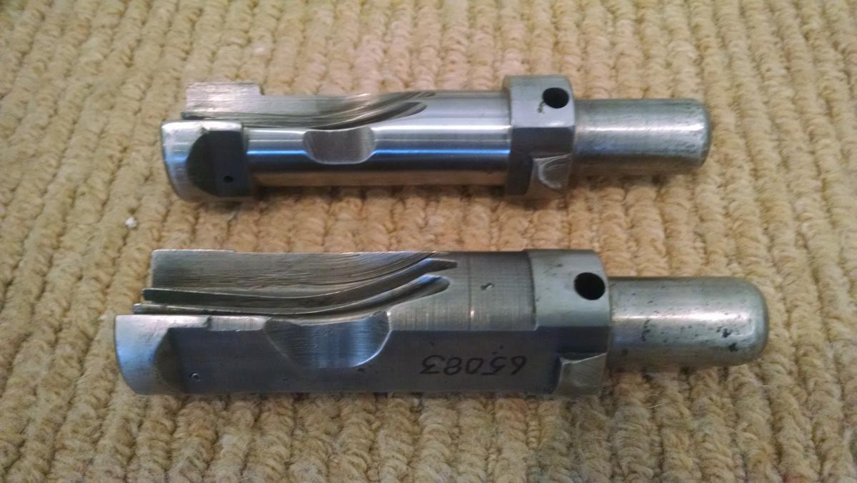

skippyjohnson Posted January 2, 2016 Author Report Share Posted January 2, 2016 Thank you for the responses thus far. Here's the bolt from a few different angles. Not the best pictures, but you get the idea. Sounds like the bolt is bad news and I need to discontinue using that. Will using the original bolt prevent future damage? Will the existing damage get worse? Link to comment Share on other sites More sharing options...
RoscoeTurner Posted January 2, 2016 Report Share Posted January 2, 2016 Not using that lightened bolt would be the first place to start to sort out your problem. Never had a problem shooting Tula or any other brand of standard pressure 9mm rounds in either of my Stens. Shoot the same in an Uzi and MP40. Thank you for the responses thus far. Here's the bolt from a few different angles. Not the best pictures, but you get the idea. IMG_20160102_155221815.jpg IMG_20160102_155202389.jpg IMG_20160102_155141338.jpg Sounds like the bolt is bad news and I need to discontinue using that. Will using the original bolt prevent future damage? Will the existing damage get worse? Link to comment Share on other sites More sharing options...
Grasshopper Posted January 3, 2016 Report Share Posted January 3, 2016 Hi Skippy, To my ear the video is well in excess of 500 RPM. The android is indicating something in the range of 320 RPM. ? The reduced weight Sten bolts are great for running a suppressed Sten, 115gr ammo, and a ported barrel with the port about 2 - 3" forward of the breach. This was common years back as 147 or 158gr 9mm ammo was not available in the War. The ported barrel gave the shooter subsonic ammo with a light bullet and less push on the bolt. Likely not the best idea for non-ported barrel use. Set-up correctly, the Sten can be very smooth. The bolt should not hit the rear of the receiver and the cocking handle should not hit the rear of the cocking slot. I've not got a Sten handy (but I may edit this post later). I'll try to get the distance from the back of the collar at the rear of the receiver to the end of the slot. The tube may not be quite to dimension. HTH, Grasshopper Link to comment Share on other sites More sharing options...
dalbert Posted January 3, 2016 Report Share Posted January 3, 2016 Hi Skippy, To my ear the video is well in excess of 500 RPM. The android is indicating something in the range of 320 RPM. ? The reduced weight Sten bolts are great for running a suppressed Sten, 115gr ammo, and a ported barrel with the port about 2 - 3" forward of the breach. This was common years back as 147 or 158gr 9mm ammo was not available in the War. The ported barrel gave the shooter subsonic ammo with a light bullet and less push on the bolt. Likely not the best idea for non-ported barrel use. Set-up correctly, the Sten can be very smooth. The bolt should not hit the rear of the receiver and the cocking handle should not hit the rear of the cocking slot. I've not got a Sten handy (but I may edit this post later). I'll try to get the distance from the back of the collar at the rear of the receiver to the end of the slot. The tube may not be quite to dimension. HTH, Grasshopper I was just thinking what Grasshopper already posted, both in the rate of fire demonstrated in the video, and with the measurement of the slot cut. I also wonder if a bad recoil spring could be at issue, but I think you should check the slot cut measurement first. I assume you are not the first owner of this Sten, and that it has been fired a lot previously? The Sten should run like a sewing machine. I don't recall ever hearing of an issue like this, so it will be interesting to see if it is truly due to trying to overclock it, or another issue. Who was the manufacturer of your tube? David Albertdalbert@sturmgewehr.com Link to comment Share on other sites More sharing options...

DINK Posted January 3, 2016 Report Share Posted January 3, 2016 In your video it appears that the bolt is slamming into the rear of the cocking slot and the Sten is recoiling much more vigorously than it should. The Sten is normally a pussycat to shoot. If the bolt is coming back too far and too fast, there are several possibilities, some of which have been addressed; The recoil spring is too weak, the bolt is too light, or the ammo is too hot. The Sten is designed to have the bolt come to the rear, run out of energy without actually smashing into anything, then return forward. If the gun has been altered so that the bolt is actually damaging the cocking slot, it will eventually destroy the back end of the gun, so I suggest you get rid of the altered bolt, buy a new recoil spring, and enjoy the Sten for what it is. If you want something that cycles faster, buy a MAC. Wilson was a very well-regarded manufacturer of tubes that were turned into Stens, Stirlings, Swedish Ks, and MP40s, among others. The problem is that you have no way of knowing who actually built the gun. All you know is that a Wilson tube was used. 1 Link to comment Share on other sites More sharing options...

warren Posted January 7, 2016 Report Share Posted January 7, 2016 Get rid of the lightweight breech block and get yourself a new main spring!!!!! Get a spring cup and a retainer cup while you are at it.Check the retainer cup for battering and also the lugs on the spring cup as well.You need the engineered recoiling mass for 9mm and playing with the bolt and spring is a recipe for disaster!!!!!I have seen the spring cup and retainer cup broken from hardening under the constant pounding with a soft spring by guys removing a coil or two trying to speed up a STEN. Link to comment Share on other sites More sharing options...

RoscoeTurner Posted January 7, 2016 Report Share Posted January 7, 2016 Did you do anything to try to speed up the rate of fire to increase the rate shown on your phone? No. The video was captured using the modified bolt. That modified bolt would qualify as trying to speed up the rate of fire. Link to comment Share on other sites More sharing options...
eMGunslinger Posted February 2, 2016 Report Share Posted February 2, 2016 (edited) Destroke the gun a little, make a buffer for the gun really pretty easy to do.I've had to do it to a few transferable Sterlings running around that the cocking handle would jump out of the slot.Really though trying to run a sten fast is a bad idea, new mainspring and don't run lightened parts. A correcrtly running Sten the bolt shouldn't bottom out at any point. Edited February 2, 2016 by eMGunslinger Link to comment Share on other sites More sharing options...
