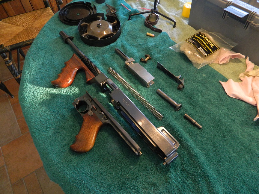

timkel Posted June 12, 2016 Report Share Posted June 12, 2016 (edited) White china pencil(wax pencil). Rub on, rub off. http://img.photobucket.com/albums/v323/timkel24102410/stuff/TompWhiteLtrng001_zps2063224c.jpghttp://img.photobucket.com/albums/v323/timkel24102410/stuff/TompWhiteLtrng002_zps667d62d1.jpghttp://img.photobucket.com/albums/v323/timkel24102410/stuff/TompWhiteLtrng003_zpscaf5bd75.jpg Edited June 12, 2016 by timkel Link to comment Share on other sites More sharing options...
ppgcowboy Posted June 12, 2016 Author Report Share Posted June 12, 2016 Thanks for that demonstration. Looks easy enough. Link to comment Share on other sites More sharing options...
buzz Posted June 13, 2016 Report Share Posted June 13, 2016 some guys can do an awesome job with a china pencil but I never really got the knack down supposedly you want to put some oil or WD40 on the rag for the "wipe off" part of the process Link to comment Share on other sites More sharing options...
