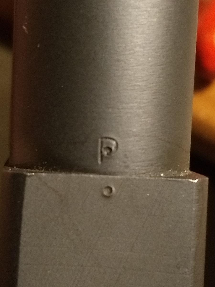

Is the punch mark that is seen in both the photos below something that was done as part of an arsenal rework? I noticed it on am M1A1, and an M1928A1 Thompson. I just don't recall anything being discussed or written about such a marking. please correct me if it's mentioned in a book.
Here is is (kind of blurry) on an M1A1 Thompson. The barrel has also been punched in the same manner, inside of the "P."
Here's one from an M1928A1 Thompson.

Any information you can provide is appreciated. Thanks!

David, I take a look in my books for any reference on the receiver punch mark. I will say that based on the left of center location for the receiver punch mark I feel pretty confident saying both of the receivers pictured were manufactured at the AOC Bridgeport plant. Savage manufactured receivers have the punch mark centered on top of the receiver nose.
I may have misunderstood the question, but that mark is the indentation caused when a Rockwell hardness test is performed on a metal (typically to verify that heat treatment brought the steel to the desired hardness), and can be seen on many small arms of the era. The test is still used in industry today.
Edited by NavyEngineer
I have never read anything specific about these marks pertaining to Thompsons. However,
during the time that the Thompsons were made and serviced it was a standard procedure to put
a prick punch mark on a receiver whenever the receiver was rebarrelled. It is NOT a mark caused
by a hardness tester. A Rockwell tester leaves a tiny mark as seen on the photo of the bolt above,
not a deep recess as seen on the receivers and barrels. The Rockwell B scale uses a 1/16" ball
penetrator. The C scale uses a pointed diamond penetrator. So the punch mark is too deep and
not rounded to be the B scale, and far too deep (again, see tiny marks on bolt) to be the C scale.
All spare Thompson barrels were proof fired and marked with a P at top dead center. I assume
that when a gun was rebarrelled it was proof fired and center punched in the middle of the P and
also the top front of the receiver right behind the P.
How long this procedure was followed I do not know. I think it got its start with the M1903
Springfiled rifles which were in service for over 20 years, many of which had several barrels
fitted over time as evidenced by multiple punch marks on the right side of the front receiver
ring below the serial number.
Bob

I certainly don't know the origin of the punch marks, but in addition to the AOC Bridgeport M1, I also have a Savage 1928A1 that some have thought might have the original barrel. That gun also has British marks on it possibly indicating Lend Lease/ British service. And, it too has the punch mark on the receive and barrel. FWIW.

David,
What do the rivetson the rear sight look like? Are they flat or do they have a dimple?
Just testing a theory.
Dan
Bright. Domed on the top; flat on the bottom.
Please post a picture of that. What manufacturer?
I was actually asking David about his AOC guns.

Bob,
I was hoping you would see this, and provide your insight. It makes complete sense. Thank you for your post.

Bob, I am subject to being corrected as my sample size isn't large, but I believe that he prick marks on the receiver were placed there at the time of the original manufacture. Savages are pricked in the center and AOC on the left side. Why would there be a difference if it was done at the time of rebarrel. Also, the P with the punch in the middle is typical of original barrels on military guns (I have more experience with Garands). In the case of Thompsons, it appears that the AOC factory used a serif P and the Savage factory used a sans serif P. With respect to the replacement barrels being proofed with a P, you would know better than I; but on the few I have seen , the P was upside down. In other words, the P is readable from the rear of the gun on original barrels and from the muzzle (at least sometimes) on replacement barrels.

Were the "replacement barrels" screwed into a receiver or fixture, torqued, fired a .45-round down them, then removed? Were they finished after testing?
I have seen WW2 TSMG replacement barrels that don't look to have been shot or ever screwed into anything.....Phil
You raise an interesting point. I thought that when a firearm was manufactured, it was assembled.
then proof fired, then test fired, and marked with a proof mark. I don't remember individual parts such
as bolts and barrels, being proof fired at the time of manufacture and then again when assembled into
a complete firearm.
I do not believe that proof cartridges were available at field service facilities where much rebuilding
and servicing of guns took place so it would make sense for already proofed bolts and barrels to be
available.
I never paid much attention to the punch marks on the receivers even though I have had hundreds
of them pass thru my hands in the course of my work. I don;t know what percentage had the marks.
Bob
