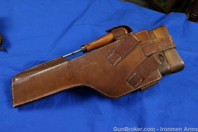

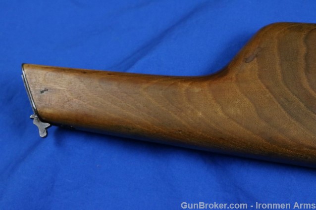

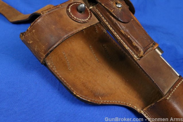

Robert Henley Posted January 18, 2019 Report Share Posted January 18, 2019 Looking for some expert eyes to determine if this leather harness is original: https://www.gunbroker.com/Item/796959515 It looks too good or new looking (stamped number) to be original, but I'm not an expert. Any other comments about it appreciated. Thanks, Robert Link to comment Share on other sites More sharing options...
bmarvin Posted January 18, 2019 Report Share Posted January 18, 2019 Hard to believe it's original in that condition. Here's a couple photos of mine Link to comment Share on other sites More sharing options...
Black River Militaria CII Posted January 18, 2019 Report Share Posted January 18, 2019 Repro....... Link to comment Share on other sites More sharing options...
timkel Posted January 18, 2019 Report Share Posted January 18, 2019 (edited) Leather looks too good. The wood just not right. Edited January 18, 2019 by timkel Link to comment Share on other sites More sharing options...
StrangeRanger Posted January 18, 2019 Report Share Posted January 18, 2019 Would an original be marked "Germany" (see photo 2) or would it read "Deutschland"? Link to comment Share on other sites More sharing options...
Mike Hammer Posted January 18, 2019 Report Share Posted January 18, 2019 Definitely a repro, absolutely no question about it.MH Link to comment Share on other sites More sharing options...
Black River Militaria CII Posted January 19, 2019 Report Share Posted January 19, 2019 On GB under the heading of “Broomhandle” there is a nice vintage M96 leather stock holder that you can inspect and compare. Link to comment Share on other sites More sharing options...
