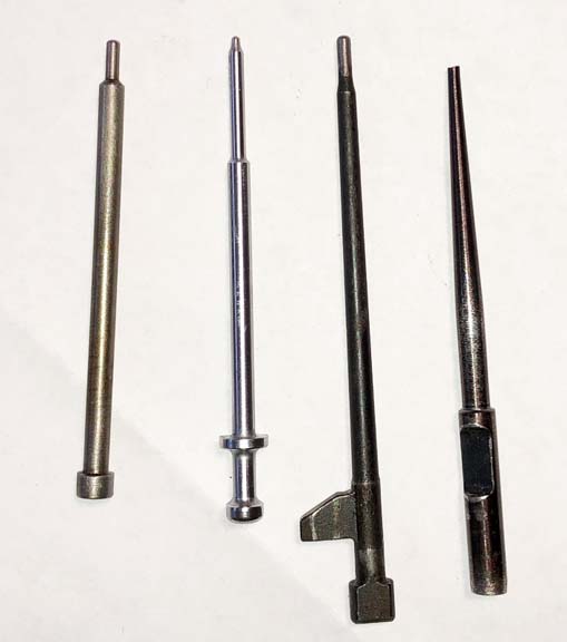

Frank I. Posted June 13, 2019 Report Share Posted June 13, 2019 I took my Reising out yesterday for the first time in quite a while. Well, the firing pin broke, my 4th one. It was even modified (shortened as per the instructions on this board). I'm now on my LAST spare firing pin. I'm curious how Keystone's titanium pins hold up, anyone? Link to comment Share on other sites More sharing options...

Frank I. Posted June 15, 2019 Author Report Share Posted June 15, 2019 I ordered a titanium FP from Keystone Joe, but... Has anyone tried cutting a Reising firing pin at the boss section and attaching, by silver solder or welding, a shortened M16 firing pin?I am going to try it next. I solved my Lanchester's firing pin problem (another subgun known for FP failures) with a M1 carbine firing pin. Link to comment Share on other sites More sharing options...
Frank I. Posted June 15, 2019 Author Report Share Posted June 15, 2019 I am still looking for a donor pin to fabricate into a Reising firing pin;from the left: Thompson, M16, BAR Reising. The BAR pin looks promising! 1 Link to comment Share on other sites More sharing options...
Bridgeport28A1 Posted June 16, 2019 Report Share Posted June 16, 2019 Frank, I do not have one to measure but would a .50 cal M2 Browning firing pin might be a suitable candidate as well? Are you still going to silver solder the larger rear boss section of Reising firing pin to the donor front end? Link to comment Share on other sites More sharing options...
BAMA-66 Posted June 16, 2019 Report Share Posted June 16, 2019 A little info on a 50 bmg firing pin that i found on a gun smith site .hope it helps According to USGI specs for ammo acceptance testing using a Universal Receiver: Firing Pin Protrusion is .074" to .082", Firing Pin Indent is .020" to .025" in a SAMMI spec copper cylinder. Firing pin diameter is .077" to .078" with a nose radius of .040" to .045". This will ensure ignition of USGI Ammo Link to comment Share on other sites More sharing options...
Frank I. Posted June 16, 2019 Author Report Share Posted June 16, 2019 Frank, I do not have one to measure but would a .50 cal M2 Browning firing pin might be a suitable candidate as well? Are you still going to silver solder the larger rear boss section of Reising firing pin to the donor front end?I don't have a .50 cal pin to check, a 1919A4 pin is not usable. Yes I'm going to try to silver solder the donor pin to the boss of the Reising pin. Since I have several broken Reising pins I'm going to make two; one with the BAR pin and another with the M16 pin. Link to comment Share on other sites More sharing options...

Bridgeport28A1 Posted June 17, 2019 Report Share Posted June 17, 2019 Frank, any chance you could take a couple of photographs during the steps of creating your "Frankenpin" Reising pin? Link to comment Share on other sites More sharing options...
Frank I. Posted June 19, 2019 Author Report Share Posted June 19, 2019 Frank, any chance you could take a couple of photographs during the steps of creating your "Frankenpin" Reising pin? I will do that and report how it holds up. Link to comment Share on other sites More sharing options...
