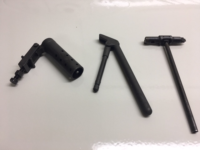

brucea4 Posted January 24, 2020 Report Share Posted January 24, 2020 Hi gang, Came upon these parts that were supposed to be for the M60. Can anyone identify them? I believe the one in the middle is a ruptured case extractor but the other two I do not know. Duh Link to comment Share on other sites More sharing options...
inertord Posted January 24, 2020 Report Share Posted January 24, 2020 Item on the left is an M14E2 Stabilizer Device. Slips over flash hider and locks on bayonet lug. Link to comment Share on other sites More sharing options...
mattnh Posted January 24, 2020 Report Share Posted January 24, 2020 (edited) None of those are parts from an M60 firearm per-se. Item on the right looks like the handle section of an M60 cleaning rod kit.Item in the middle is NOT a std M60 broken case extractor, although that is what it looks like it does... Edited January 24, 2020 by mattnh Link to comment Share on other sites More sharing options...
MG08 Posted January 26, 2020 Report Share Posted January 26, 2020 Pretty much all the above is true. 1 - M14E2 muzzle break 2 - 1919 series Browning ruptured case extractor 3 - Garand cleaning rod handle / tool Link to comment Share on other sites More sharing options...
brucea4 Posted January 27, 2020 Author Report Share Posted January 27, 2020 Pretty much all the above is true. 1 - M14E2 muzzle break 2 - 1919 series Browning ruptured case extractor 3 - Garand cleaning rod handle / tool Thank you for the info all. And naturally a 30.06 ruptured case extractor won't work for a 7.62x51..... Link to comment Share on other sites More sharing options...
MG08 Posted January 27, 2020 Report Share Posted January 27, 2020 Pretty much all the above is true. 1 - M14E2 muzzle break 2 - 1919 series Browning ruptured case extractor 3 - Garand cleaning rod handle / tool Thank you for the info all. And naturally a 30.06 ruptured case extractor won't work for a 7.62x51..... Well, it can - just not the same way- install it the same - then use a cleaning rod from the muzzle to know it out. It just won't cam out like a 30 cal barrel. Link to comment Share on other sites More sharing options...
