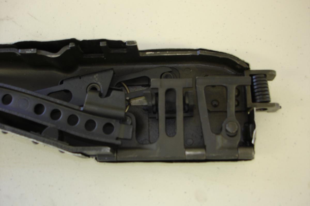

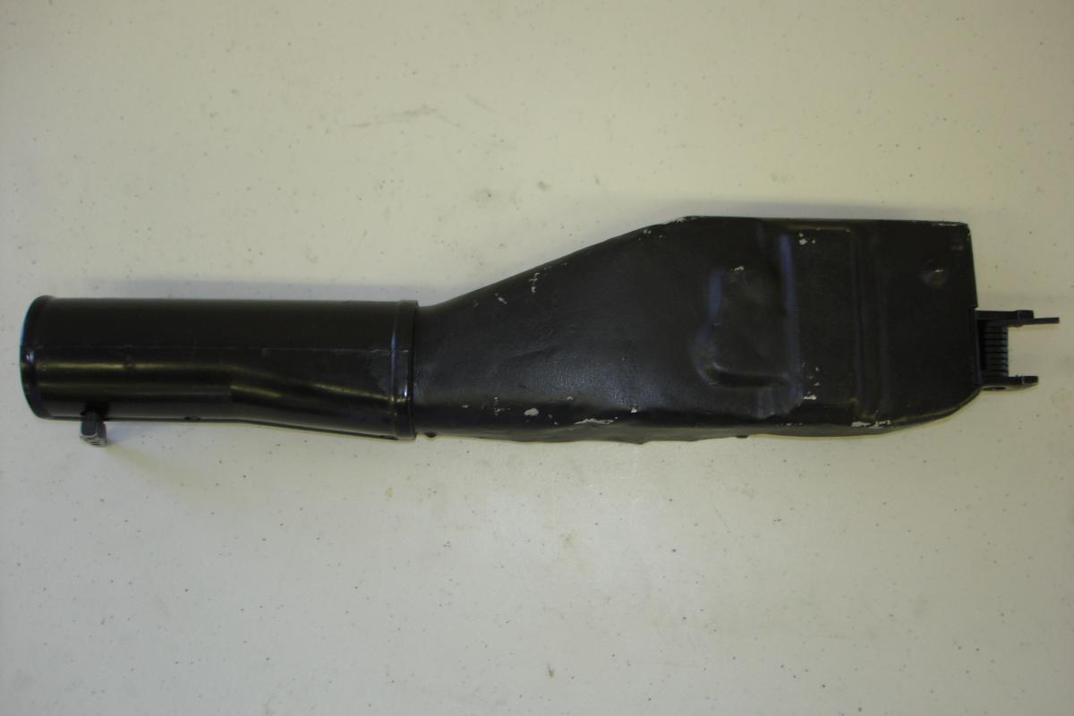

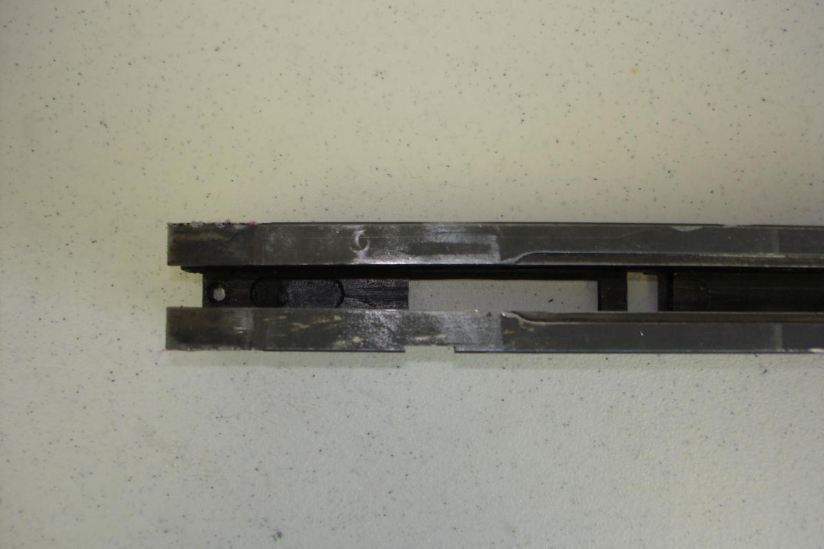

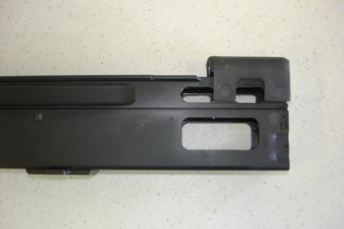

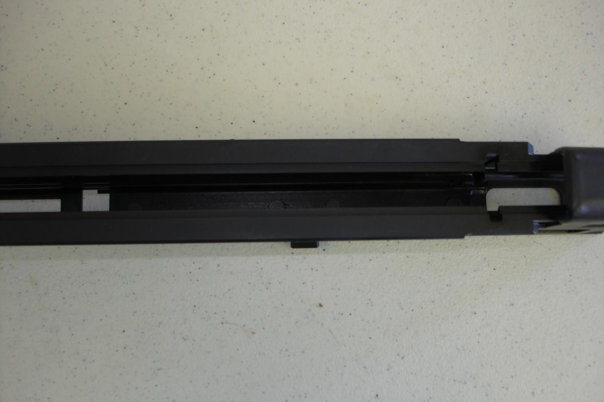

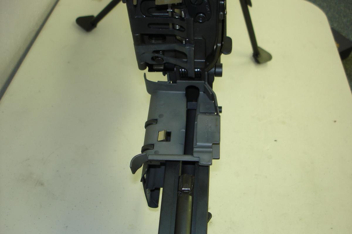

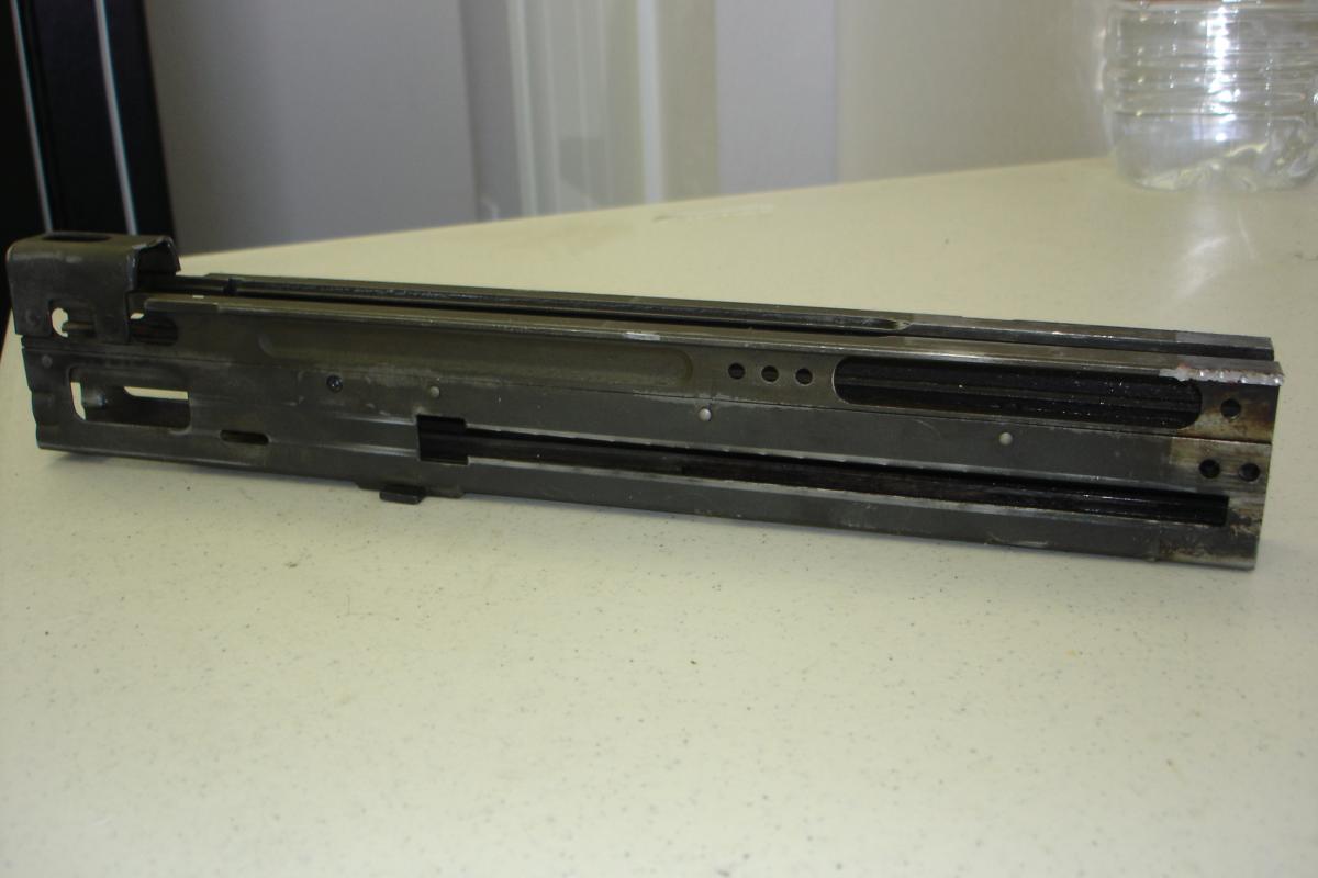

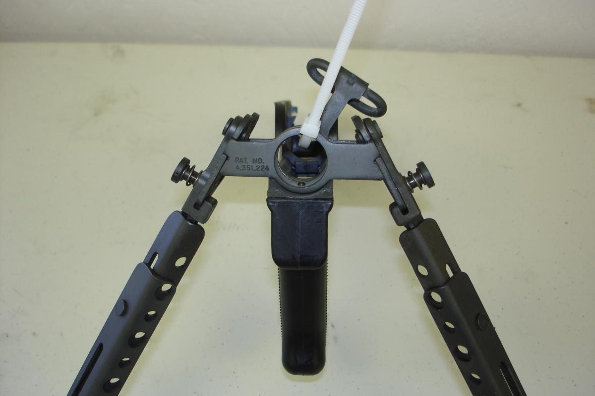

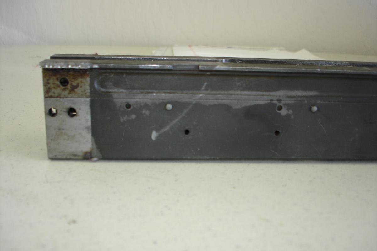

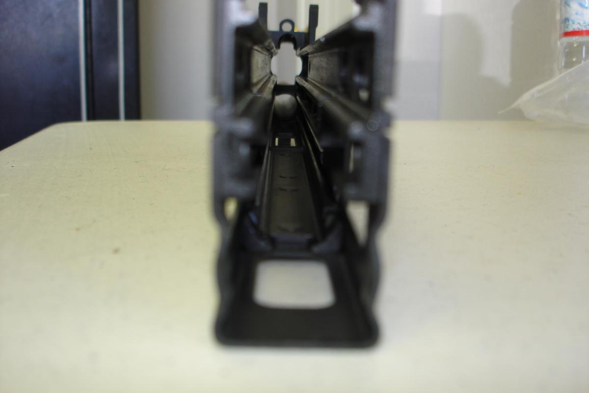

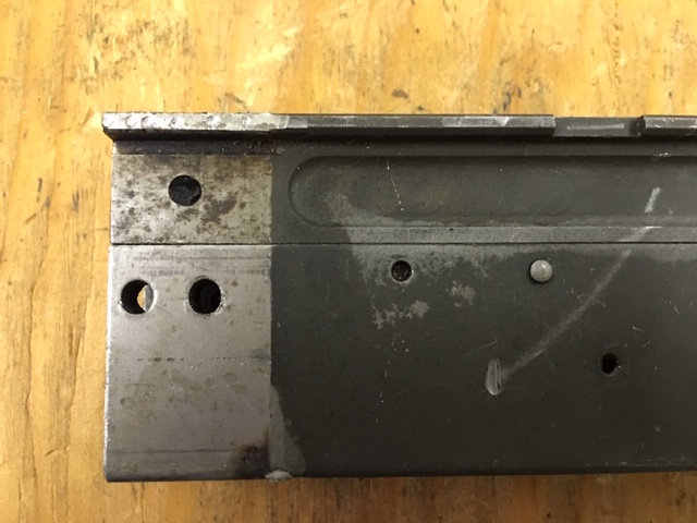

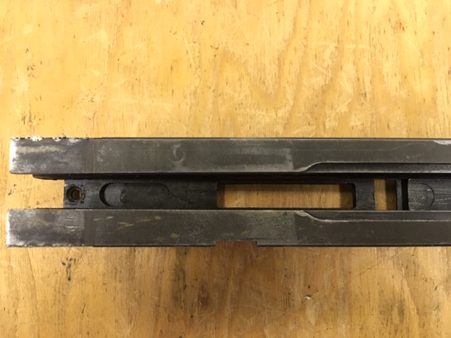

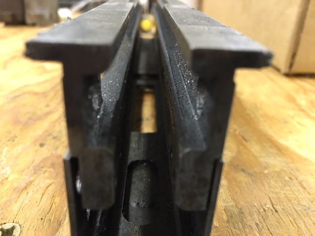

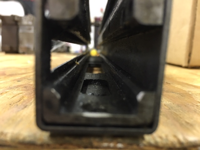

fifthmdec Posted March 29, 2020 Author Report Share Posted March 29, 2020 (edited) Photos of the channel removed from our Erb registered trunnion. It was replaced by US Ordnance and configured into an E4. They stated that the trunnion was no longer viable. In addition, when we first took it out to shoot. It did not cycle worth a damn. obviously, all the components were replaced as part of the upgrade. This was more than 10 years ago, around 2006-2007. Just thinking the reference to the original trunnion, was part of the operational issues before the upgrade. Need to check the photos to see if the trunnion had markings on top. Erb had a bullet shaped logo on the side of the trunnion. SACO-LOWELL on the trunnion. Edited March 29, 2020 by fifthmdec Link to comment Share on other sites More sharing options...

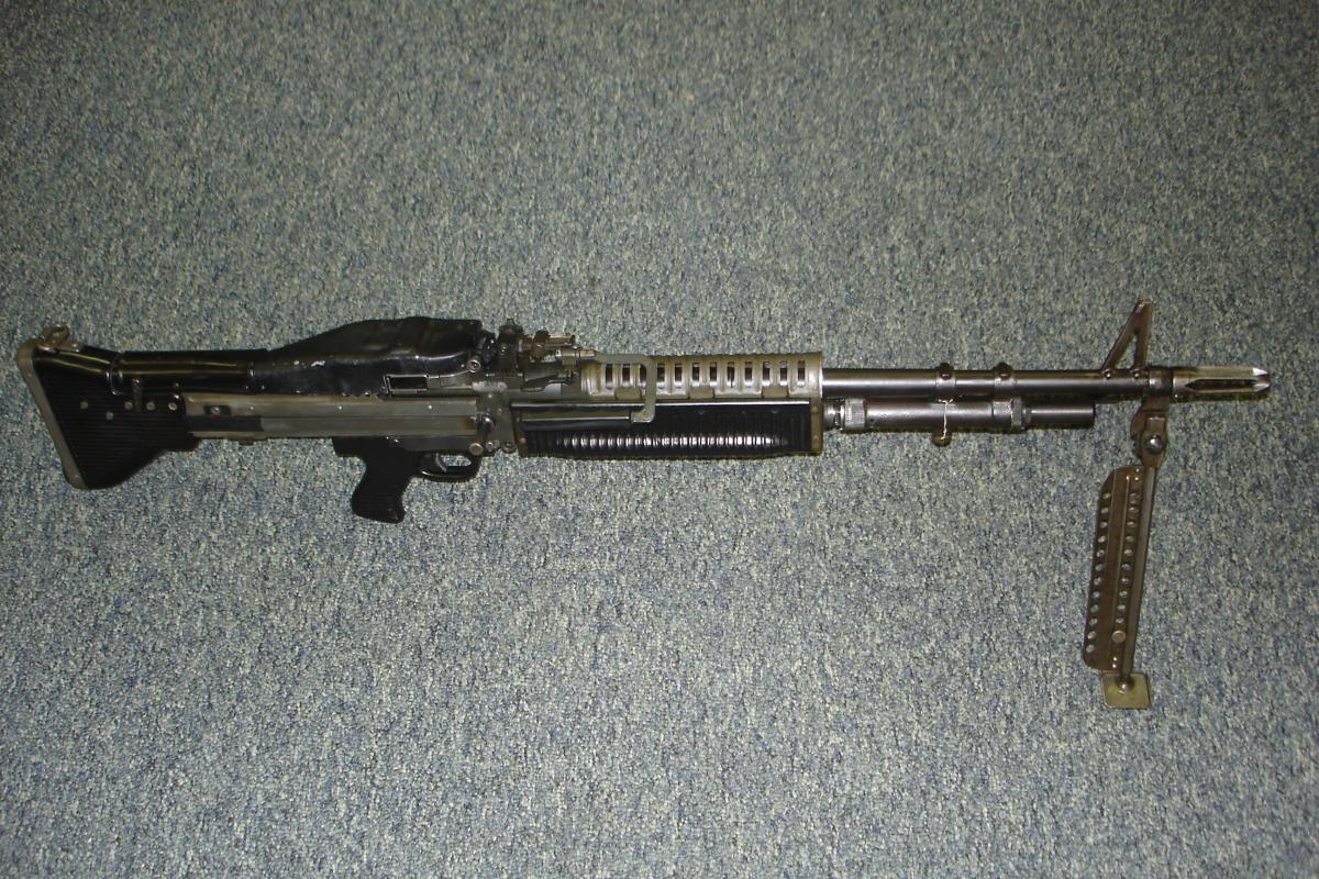

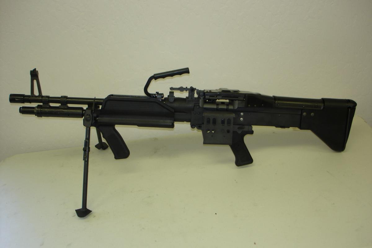

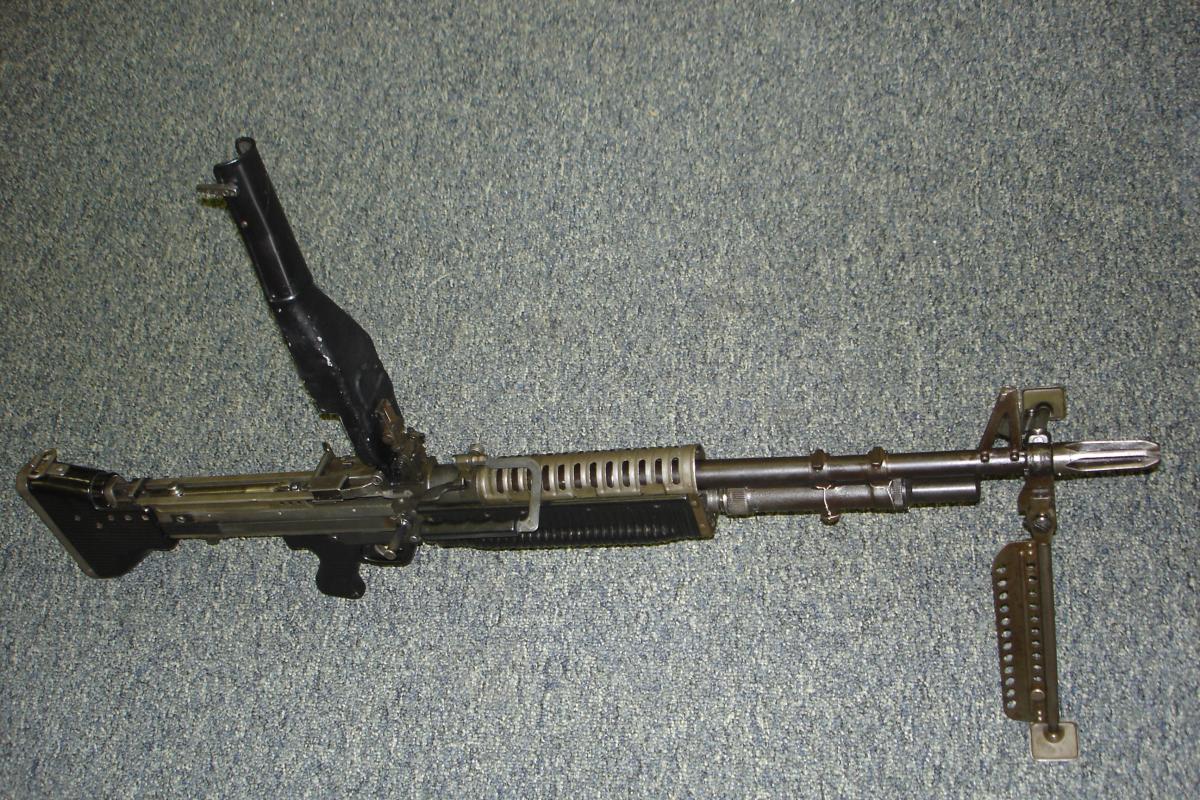

fifthmdec Posted March 29, 2020 Author Report Share Posted March 29, 2020 We sold it years ago. ERB M60. You get the picture... Link to comment Share on other sites More sharing options...

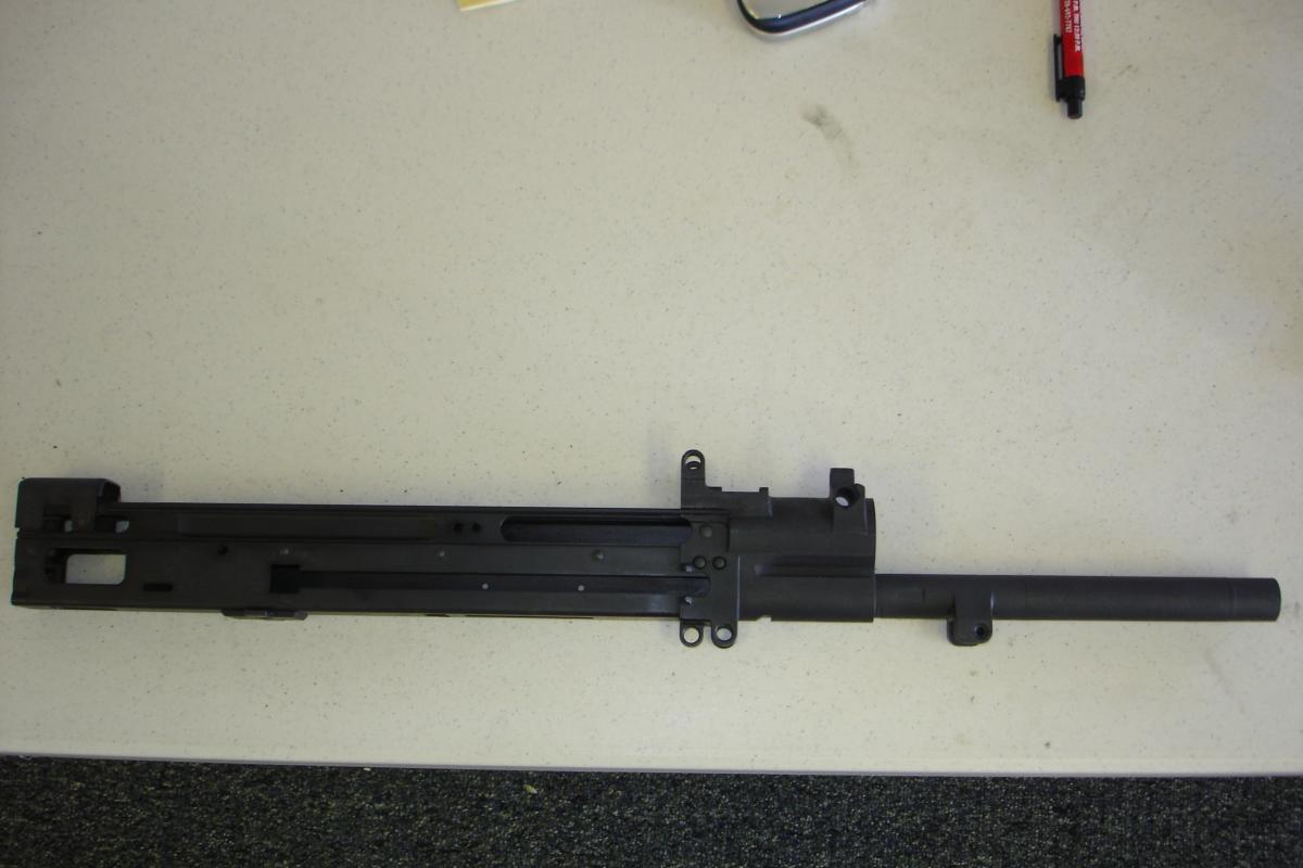

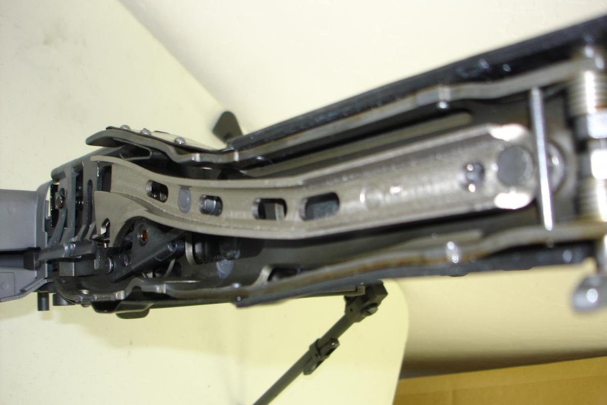

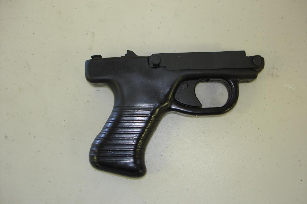

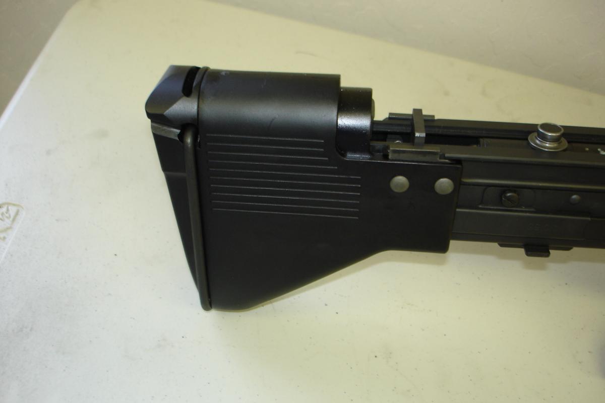

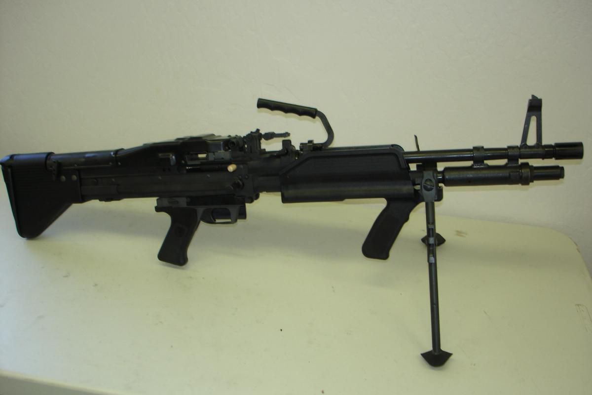

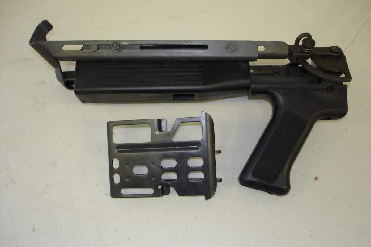

fifthmdec Posted March 29, 2020 Author Report Share Posted March 29, 2020 US Ordnance rebuild... Link to comment Share on other sites More sharing options...

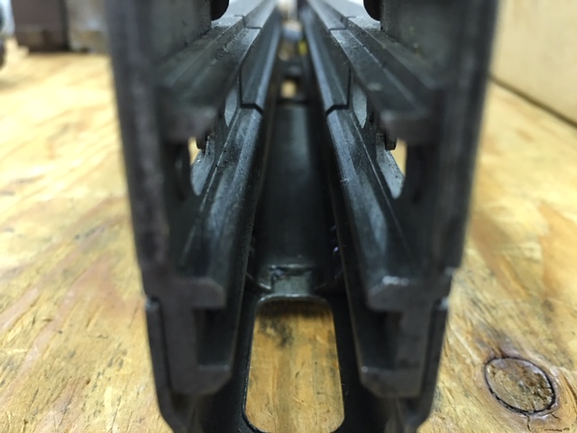

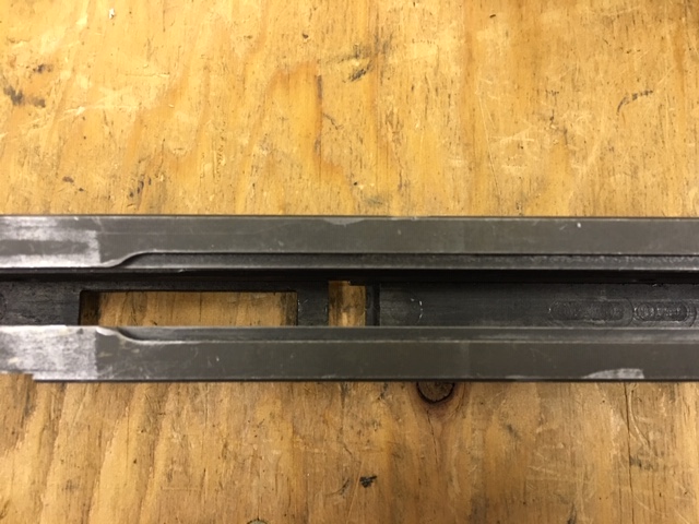

fifthmdec Posted March 30, 2020 Author Report Share Posted March 30, 2020 Wanted to add the photos as they are pertinent to the thread, as the conversation was well thought out and knowledgeable, indeed. BTW, I'm considering a Post Sample RIA channel registered. Not sure of the manufacture date.Perhaps, someone in the thread can shed some light on some date ranges. SN 108xx David Link to comment Share on other sites More sharing options...
mattnh Posted March 30, 2020 Report Share Posted March 30, 2020 Photos of the channel removed from our Erb registered trunnion. It was replaced by US Ordnance and configured into an E4. They stated that the trunnion was no longer viable. In addition, when we first took it out to shoot. It did not cycle worth a damn. obviously, all the components were replaced as part of the upgrade. This was more than 10 years ago, around 2006-2007. Just thinking the reference to the original trunnion, was part of the operational issues before the upgrade. Need to check the photos to see if the trunnion had markings on top. Erb had a bullet shaped logo on the side of the trunnion. SACO-LOWELL on the trunnion. So, DO reworked your reg Erb trunion and put a brand new back-half on it?Did they tell you what they had to fix on the trunion that made in "non-viable" before their work? Link to comment Share on other sites More sharing options...
fifthmdec Posted March 30, 2020 Author Report Share Posted March 30, 2020 The channel was replaced, trunnion was fine. They replaced just about everything, the top cover received new components. The entire build/upgrade ran about 10K. That was in 2005. There was no DO at that time, it was USORD and they were still located near the old rodeo grounds north of I-80. BTW, the current owner of the RIA Postie M60. Received the LMG in 1990 from a SOT in his area... Link to comment Share on other sites More sharing options...
johnsonlmg41 Posted March 31, 2020 Report Share Posted March 31, 2020 90 is before my time in the hobby, but I'd guess there were few posties from them since transferables were still widely available at not much of a premium over a post sample. Likely it was something they had in process in 86 that didn't get finished and make the cut? Lots of guys had piles of stuff that didn't make the cut and eventually got finished into posties and then it took a long time to move them. Or there was simply a shortage of many parts to finish. Had there been a proliferation of HK trigger packs back then like there is today that would be a whole different ball game as well. Wow 10K seems like a lot of dough for that? I see they didn't weld the trunion back onto the channel? No worries with an Erb trunnion......they were as good as Maremont......you could say! LOL Link to comment Share on other sites More sharing options...
mattnh Posted March 31, 2020 Report Share Posted March 31, 2020 The channel was replaced, trunnion was fine. They replaced just about everything, the top cover received new components. The entire build/upgrade ran about 10K. That was in 2005. There was no DO at that time, it was USORD and they were still located near the old rodeo grounds north of I-80. BTW, the current owner of the RIA Postie M60. Received the LMG in 1990 from a SOT in his area... BTW, I would assume you got a new E4 mod0 topcover as well since an E4 cam arm won't fit into an original M60 topcover (or even into an E3 topcover).In retrospect, perhaps a better deal than what you thought... Link to comment Share on other sites More sharing options...

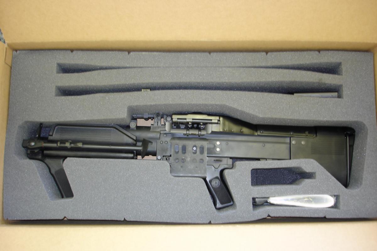

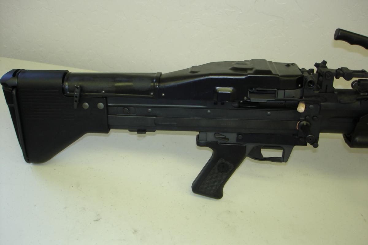

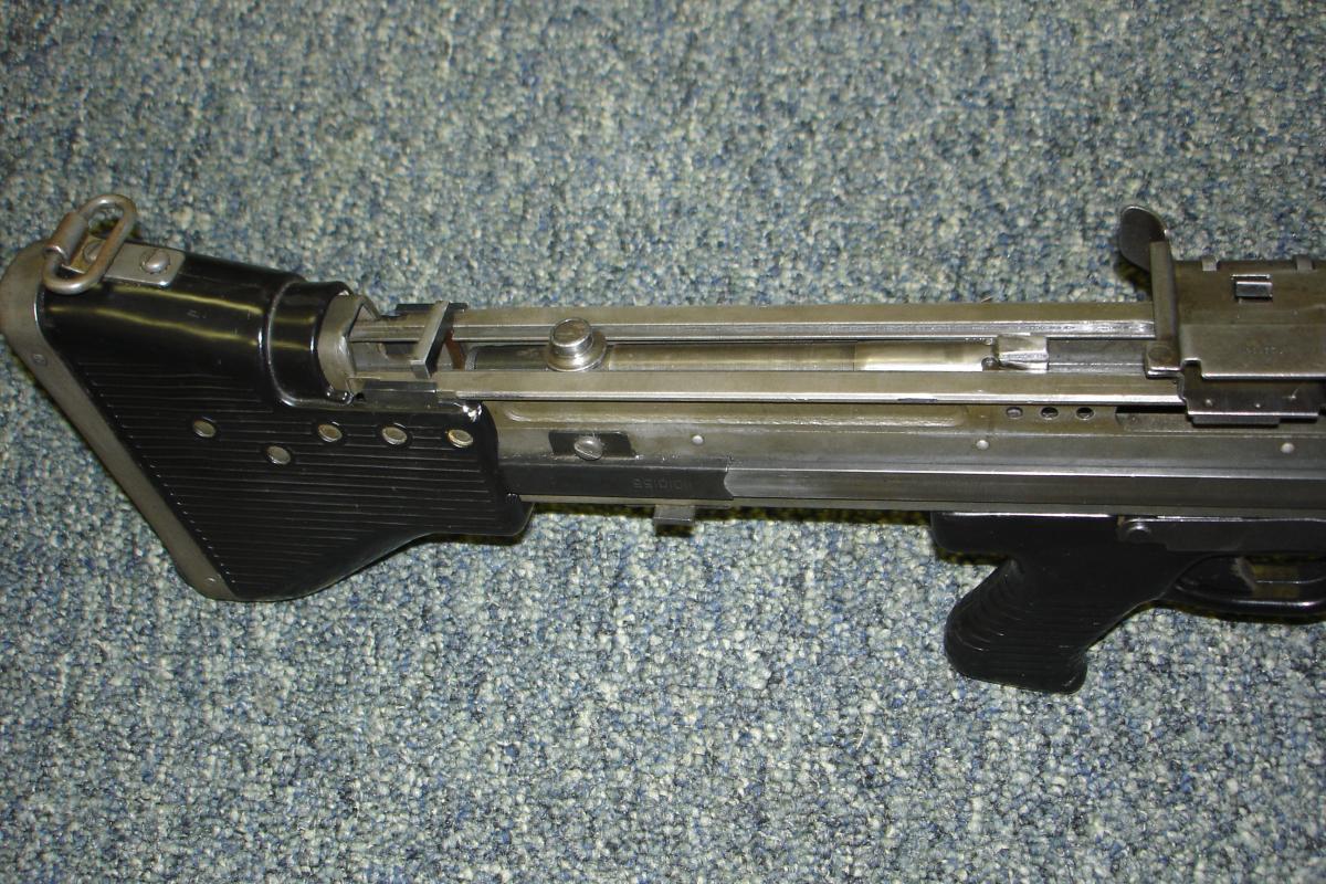

fifthmdec Posted March 31, 2020 Author Report Share Posted March 31, 2020 This is what I received. Yes, I did get a good deal, no complaints. Considering that in the original configuration, it didn't even cycle past one round... New op rod, feed tray; not sure if they used he same top cover. If a new one was needed, then they used one that was new. Anyway, I'll post photos of the RIA when I except transfer. Appreciate all the input as always... Link to comment Share on other sites More sharing options...
