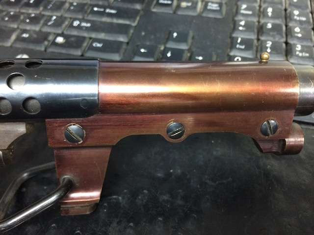

av8tr Posted July 24, 2020 Report Share Posted July 24, 2020 (edited) Im not looking for a Stevens and this one certainly looks vintage but the seller has a 7k bin price and posts two far away photos??. I have seen this time and time again. I ask for more detailed photos of markings and certain things i need to see...no photos and bs replies. The fakes are rampant out there and the broker / sellers do not know what they are selling. https://www.gunbroker.com/item/867145644 I agree, except some do know what they are selling, but don't really want the buyer to know. More times than not, the reason there are only a couple of bad pictures is to hide or marginalize issues. I've gotten to where I just move on and look at auctions that show the gun in its entirety. And, on this one, the bayonet mount part of the heat shield should be plum colored. I wouldn't want that gun. Edited July 24, 2020 by av8tr Link to comment Share on other sites More sharing options...
