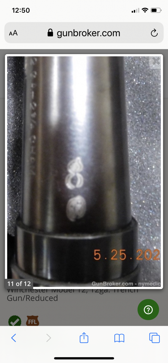

Petroleum 1 Posted July 31, 2020 Author Report Share Posted July 31, 2020 (edited) Do these markings look faked? They do to me. Edited July 31, 2020 by Petroleum 1 Link to comment Share on other sites More sharing options...
Tom D Posted August 1, 2020 Report Share Posted August 1, 2020 "Do these markings look faked? I believe the proof marks are real. But that shotgun has several issues including a WB marked riot gun stock with no sling swivel, a missing bayonet adaptor screw, and a "W" marked adaptor which would most likely be a replacement adaptor on a gun in that serial number range. Link to comment Share on other sites More sharing options...

Petroleum 1 Posted August 2, 2020 Author Report Share Posted August 2, 2020 (edited) "Do these markings look faked? I believe the proof marks are real. But that shotgun has several issues including a WB marked riot gun stock with no sling swivel, a missing bayonet adaptor screw, and a "W" marked adaptor which would most likely be a replacement adaptor on a gun in that serial number range.Agreed Edited August 2, 2020 by Petroleum 1 Link to comment Share on other sites More sharing options...
Petroleum 1 Posted August 2, 2020 Author Report Share Posted August 2, 2020 (edited) The Morphys Winchester trench guns are nice but only for the right price. The model 12 bayonet adaptor and shield has a very newish look to it and should be W marked being late war 1944 mfg. The park finish is correct especially with the RIA marking on the stock. I would ask what the two digit stamp is on the barrel. The model 97 imo is a riot conversion. That gun should have a 6 hole early war shroud the one on the gun is a late war W stamped 4 hole assembly. Also the take down holes are still in the magazine tube which would indicate this was a riot gun originally. Edited August 2, 2020 by Petroleum 1 Link to comment Share on other sites More sharing options...

Tom D Posted August 5, 2020 Report Share Posted August 5, 2020 Only the WWII Model 97 trench guns have the extra hole in the mag tube for the takedown lever. The WWI Model 1897 and the WWII Model 12 trench guns do not. Link to comment Share on other sites More sharing options...
