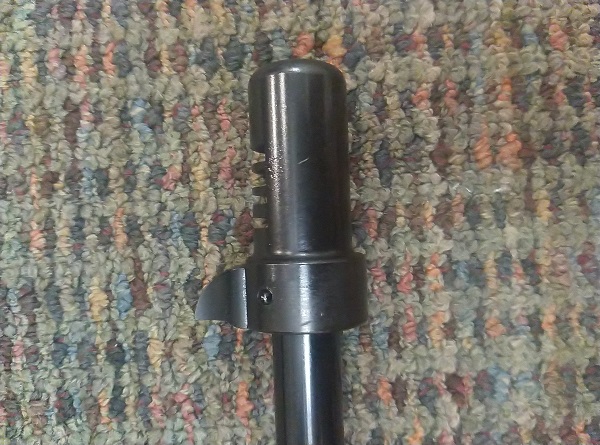

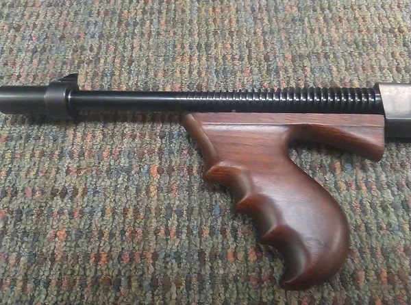

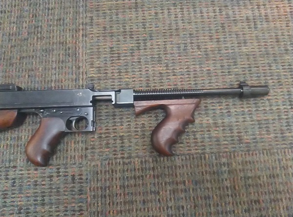

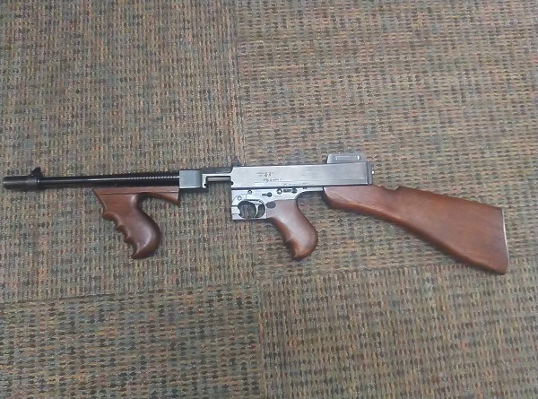

nate129 Posted December 11, 2020 Author Report Share Posted December 11, 2020 I have a substantial update on #4945. Chuck, "gijive," has continued to research the local and national papers. He has unearthed many articles that help paint a picture of how we got this weapon. My next post will have a chronological timeframe of #4945 and the persons associated with it. Chuck didn't stop there. He worked with Roger, "tsmg28," who had an original type 1 compensator in poor condition. Roger very graciously donated the compensator to us. The compensator was mailed to PK in Colorado where he expertly refinished it. When PK was done with that work, we mailed the receiver and barrel to him. PK removed the M1 barrel and replaced it with one of his reproduction 1921 barrels and Roger's refinished type 1 compensator. Finally I mailed Chuck our original Colt wood. Chuck carefully refinished the wood with applications of linseed oil (no sanding was done). And he provided us some ww2 era internal parts to shoot with to avoid wearing the original Colt parts. We are very grateful for Chuck and Roger's help on this project. Between the driving up here to remove the barrel and helping with restoration they have certainly incurred costs in time and materials. Thank you for your dedication to history and helping us restore this weapon rich in history. Our eventual plan is to display the weapon in a case in the private side of our office; I think its too valuable to risk displaying on the public side. Especially after the recent restorative work. I have attached some pictures of the finished product to this post. Link to comment Share on other sites More sharing options...
