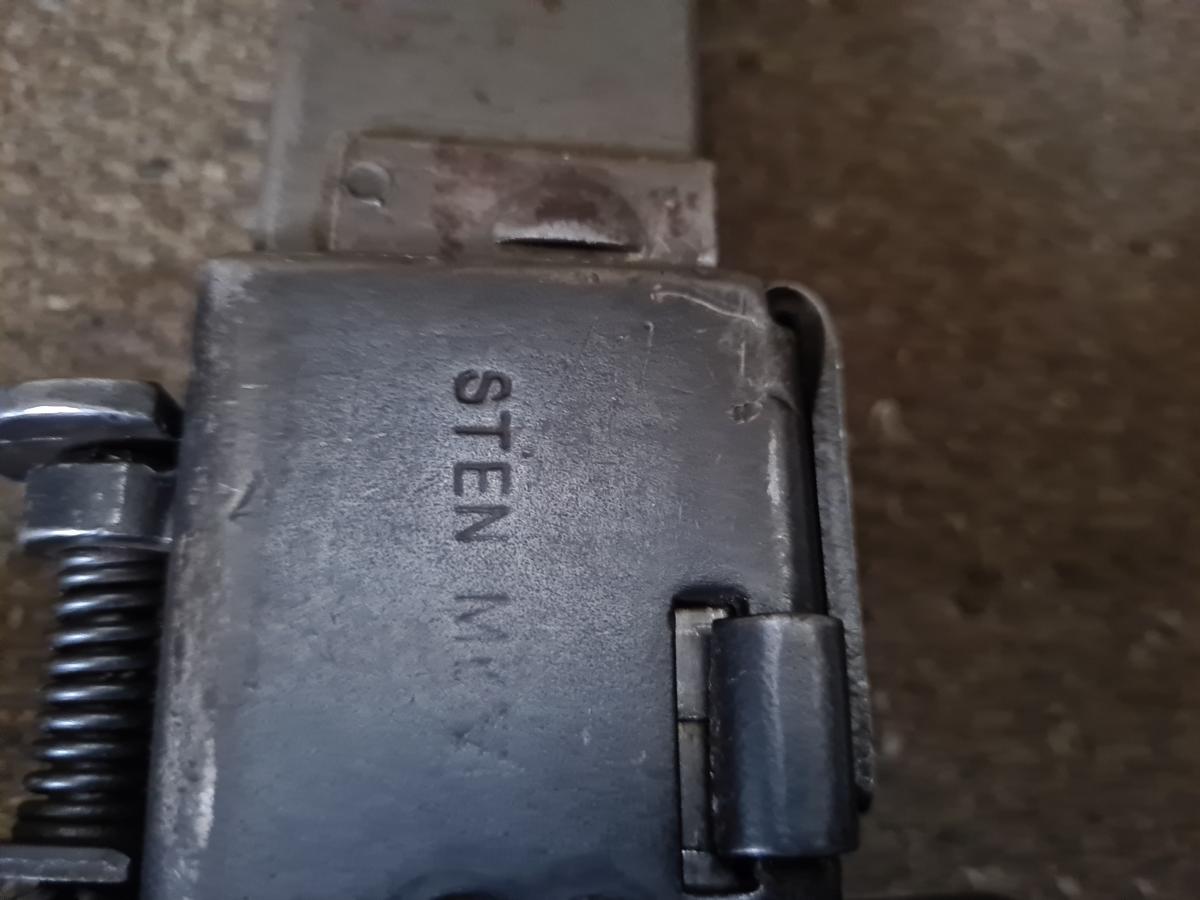

John Dillinger Posted February 1, 2021 Report Share Posted February 1, 2021 (edited) Does anyone know what R/L & M70 stand for on the upper magazine housing on a MkV Sten There's also a V over SSee photo.Thanks. Edited February 1, 2021 by John Dillinger Link to comment Share on other sites More sharing options...
Annihilator Posted February 1, 2021 Report Share Posted February 1, 2021 Its not R/L but RTL Royal Theale manufacture Link to comment Share on other sites More sharing options...
John Dillinger Posted February 2, 2021 Author Report Share Posted February 2, 2021 That's great to know much appreciated thanks Link to comment Share on other sites More sharing options...
BillyDixon Posted February 3, 2021 Report Share Posted February 3, 2021 how about a picture of other side of mag housing < just wondering, Link to comment Share on other sites More sharing options...
m3bobby Posted February 10, 2021 Report Share Posted February 10, 2021 The SV is indicative of the Mk5, simply means STEN mkV I think this is a EU spec deac judging by the blob of weld which likely has a pin under it to block the mag well. Link to comment Share on other sites More sharing options...
AlanDavid Posted February 21, 2021 Report Share Posted February 21, 2021 I cant see M70 in the photo but if present this is the manufactures code for E. David & Sons (Evercool) Ltd, Reditch. They made triggers, mag catch & platform and ejectors. The overlaid VS is the logo for Vi Spring Products who made mag components, springs and breech blocks. Not all companies used the S M N code system. All the above is in Skenneton's book on WW2 British small arms. Vi Spring Co is still in existence having been founded in 1901. They make custom made beds. Regards AlanD Link to comment Share on other sites More sharing options...

John Dillinger Posted February 22, 2021 Author Report Share Posted February 22, 2021 how about a picture of other side of mag housing < just wondering,Here you go Billy. Link to comment Share on other sites More sharing options...
