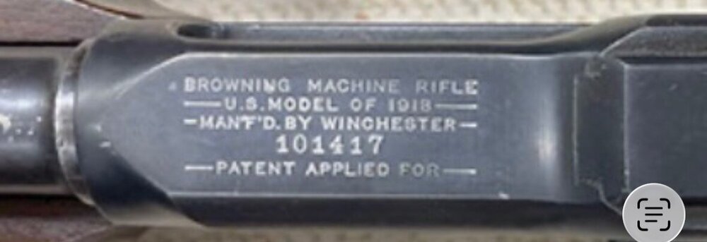

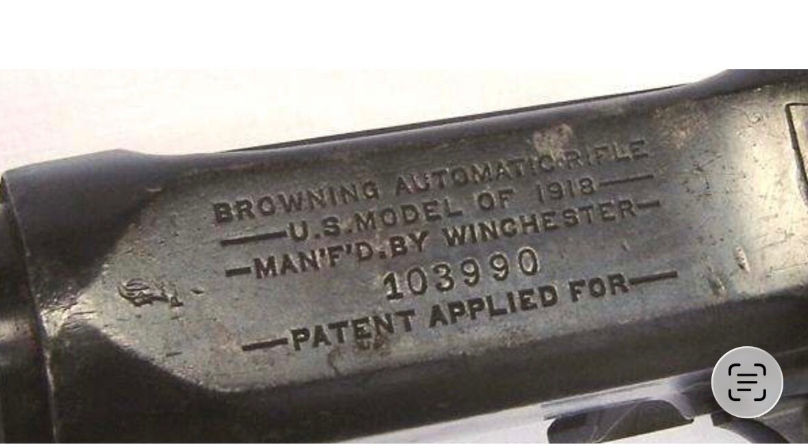

John Dillinger Posted February 18 Report Share Posted February 18 Researching Winchester serial numbers. The 2 photos show the change in the wording from Browning Machine Rifle to Browning Automatic Rifle on the receiver stamp. So could 101417 suggest that the first gun manufactured was nearer this number given it has the early receiver stamp? Of course given that there were 28,000 guns produced with a serial number range of 64,001 - 2000,000 (that’s 135999 serial numbers to choose from and there’s no suggestion that they were sequential) this complicates things considerably 🤔 1 Link to comment Share on other sites More sharing options...
