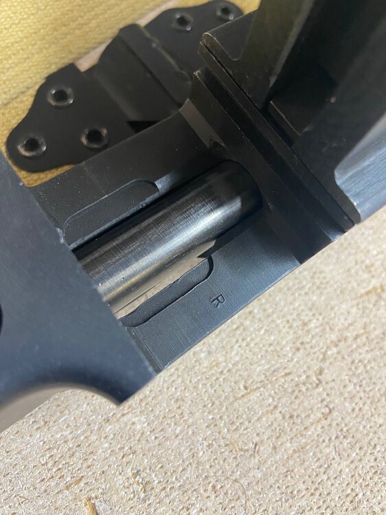

firearm Posted May 12, 2021 Report Share Posted May 12, 2021 I have someone asking about an early West Hurley Thompson I have stuck back in the vault. Yes I know all the everyone thinks they are junk but the guy is simply looking for a shooter. This is a very early 3 digit serial numbered weapon and that is why I kept it. What is interesting are the markings on the receiver. It is marked "US Model 1928A1" and not "US Model 1928". The form 4 also states that the model is a "1928A1". The serial number area is marked "No. A.O.C. 271A" instead of "NO. 271A". The bolt has the "S" Savage marking and it has a Lyman" sight assembly. Wood is pretty nice. I am curious as to why it would be marked differently than the rest of the Hurley 28's that have come through here. I also noticed a "R" stamped in the magazine well. Anyone know what it stands for? I am suggesting to the buyer than he strip all of the Hurley parts out (except bolt) and install a nice clean set of WWII internals. Curious as to what you guys think? A handful of pics attached. Link to comment Share on other sites More sharing options...

anjong-ni Posted June 5, 2021 Report Share Posted June 5, 2021 Here is one of the "R" receivers. I thought that maybe "D.R" had worked on it in the past ..Phil Link to comment Share on other sites More sharing options...

cm289 Posted June 5, 2023 Report Share Posted June 5, 2023 (edited) Mine is A.O.C.274A, and it also has the “R”. For anyone interested in, here's how it was equipped when originally purchased in 1975: M1 style safety and rocker pivots (since swapped out with vintage 1928A1 paddle-style from Savage) Savage bolt Savage Blish lock Lyman adjustable sight Savage actuator Unmarked compensator that has the front sight dove-tailed in (sight was loose, so I staked it down. Also, comp has a set screw underneath to attach it to barrel). Two piece WH buffer pilot (since replaced with a vintage Savage). Buffer pad appears to be black polyurethane. Mag release appears to be USGI Barrel appears to be WH, with the squared off & sharp fins The only other semi-interesting thing about it is that the "4" in the serial # sits about 1/2 a line lower than the other #s. Edited June 10, 2023 by cm289 added info Link to comment Share on other sites More sharing options...

anjong-ni Posted June 8, 2023 Report Share Posted June 8, 2023 Three different "R" marked receivers with the "R" in different orientation. Wonder who stamped them and why?...Phil Link to comment Share on other sites More sharing options...
