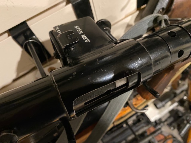

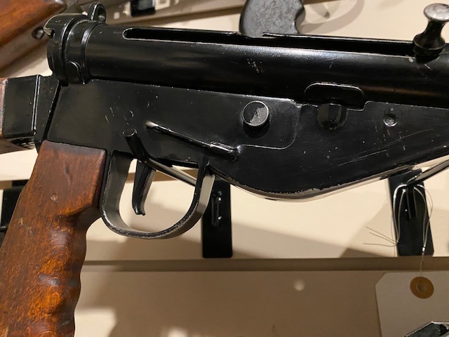

APEXgunparts Posted September 16, 2021 Report Share Posted September 16, 2021 (edited) It seems WAY out of line to mehttps://www.rockislandauction.com/detail/83/1543/british-mark-v-sten-gun-fully-transferable-machine-gun Looking at the pictures closely, I have to question the welds between the tube and the fire control housing.They don't look correct for an original C&R STEN MK5.Here are pictures to reference against the pictures of the Mark 5 that sold at auction. Even the MARK 2 looks different than what we see on this gun at auction. Maybe I just haven't seen enough of them? Richard Edited September 16, 2021 by APEXgunparts Link to comment Share on other sites More sharing options...

MG08 Posted September 17, 2021 Report Share Posted September 17, 2021 It seems WAY out of line to mehttps://www.rockislandauction.com/detail/83/1543/british-mark-v-sten-gun-fully-transferable-machine-gun Looking at the pictures closely, I have to question the welds between the tube and the fire control housing.They don't look correct for an original C&R STEN MK5.Here are pictures to reference against the pictures of the Mark 5 that sold at auction. DSC01079.JPG sten_mk5_trigger_housing_complete.jpg Even the MARK 2 looks different than what we see on this gun at auction. right-side.jpg Maybe I just haven't seen enough of them? Richard Here is my original MK 5, C&R. you can compare welds, but different makers were most likely "different". Link to comment Share on other sites More sharing options...
APEXgunparts Posted September 17, 2021 Report Share Posted September 17, 2021 It seems WAY out of line to mehttps://www.rockislandauction.com/detail/83/1543/british-mark-v-sten-gun-fully-transferable-machine-gun Looking at the pictures closely, I have to question the welds between the tube and the fire control housing.They don't look correct for an original C&R STEN MK5.Here are pictures to reference against the pictures of the Mark 5 that sold at auction. DSC01079.JPG sten_mk5_trigger_housing_complete.jpg Even the MARK 2 looks different than what we see on this gun at auction. right-side.jpg Maybe I just haven't seen enough of them? Richard Here is my original MK 5, C&R. you can compare welds, but different makers were most likely "different". A very nice STEN MK5 you have there!Thank you for sharing the pictures.Note that the "tabs" from the fire control housing attach to the body / receiver tube by the use of spot welds.These were made late in the war and were an improvement compared to the gas welding.Here is info from the Imperial war museum page: The Mk 5 Sten gun was a development of the Mk 2 (see FIR 6260). It was far less 'austere' in construction than its predecessor; featuring front and rear pistol grips and a wooden butt. Quality control over the manufacturing process was more strictly applied. As a result a Mk 5 took about twice as many man-hours to manufacture as a Mk 2. This change reflects Britain's improved position with regard to armaments by the time production of the Mk 5 commenced in February 1944. The Mk 5 Sten was assembled at two Royal Ordnance Factories: Theale, in Berkshire and Fazakerley in Lancashire. This gun is one of 357,603 Mk 5s made at the latter factory. It lacks the forward pistol grip, which was deleted from production in June 1945. It had been discovered that leverage produced by using this grip could weaken the catch retaining the barrel-nut, which joined the barrel to the receiver. Carbine, Machine, Sten, 9mm Mk 5. © IWM (FIR 6272) IWM Non Commercial License Note that the Imperial War Museum example has the 2 tabs spotted welded to the body / receiver tube, same as mine (pictured above).The most recent images are the other attachment method (2 factories, 2 types of spot welded tabs)The gun sold thru RIA was gas welded, and one tab appears to be missing.ALSO, notice the slot for the charging handle!The safety notch is in the MARK 2 location, the Mark 5 safety notch is right above the selector button.There is something just not right about the RIA Mark 5. Richard Link to comment Share on other sites More sharing options...

hkg3k Posted September 18, 2021 Report Share Posted September 18, 2021 I have a limited knowledge of C&R STEN guns...but I've never seen one with that "blob of weld" at 12 o'clock on the receiver ring / tube junction just in front of the rear sight. Seen it on plenty of tube guns...is this legit for an original gun? Link to comment Share on other sites More sharing options...
Barry Posted September 18, 2021 Report Share Posted September 18, 2021 What does the Xx110 On the rear sight indicateBarry Link to comment Share on other sites More sharing options...
APEXgunparts Posted September 20, 2021 Report Share Posted September 20, 2021 It seems WAY out of line to mehttps://www.rockislandauction.com/detail/83/1543/british-mark-v-sten-gun-fully-transferable-machine-gun Having studied these images I think the buyer is going to be quite unhappy when the truth of the STEN is revealed.It may be a C&R body / receiver tube, but it is not a MARK 5 part.It appears that MARK 5 parts were added onto a MARK 2. Richard Link to comment Share on other sites More sharing options...

Odinsravens Posted December 3, 2021 Report Share Posted December 3, 2021 Yep m2 rebuilt as a MK V - I am in Europe with different pricing and supply etc - but does look suspect however if it works got themselves a working sub machine gun Link to comment Share on other sites More sharing options...
