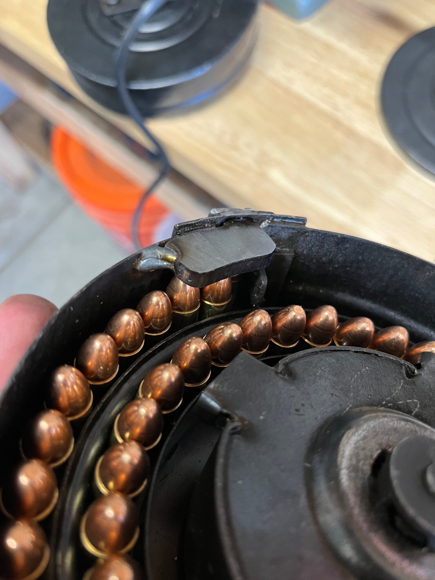

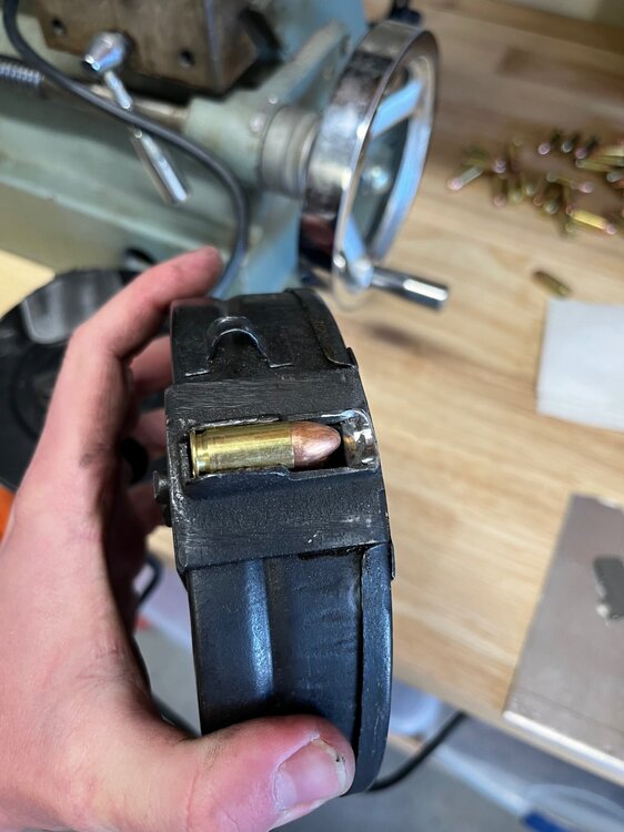

Roland the Thompsongunner Posted January 30, 2022 Report Share Posted January 30, 2022 I have used them with 9mm in my PPSH quite a bit. There is a difference in the length of the rounds but if the drum fits good they seem to overcome that gap and not dive. I do have a failure here and there but I have sorted my drums and some work better than others. My best working drum is a mint condition yugo drum. Has 01 markings. I have also welded a short ramp in a drum I was using for short blanks. It helped to guide them pretty well to the chamber Link to comment Share on other sites More sharing options...

Roland the Thompsongunner Posted February 4, 2022 Report Share Posted February 4, 2022 This mod worked pretty decent for the short 9mm blanks I used years ago. I also had a small guide welded on the inside to guide the shells behind the ramp Link to comment Share on other sites More sharing options...

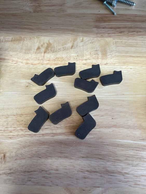

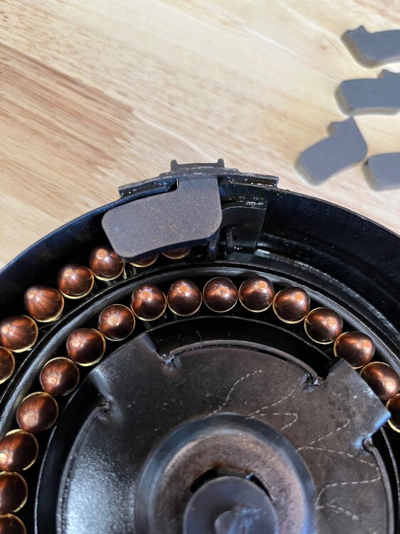

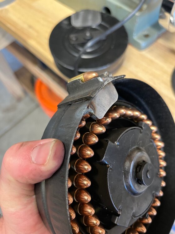

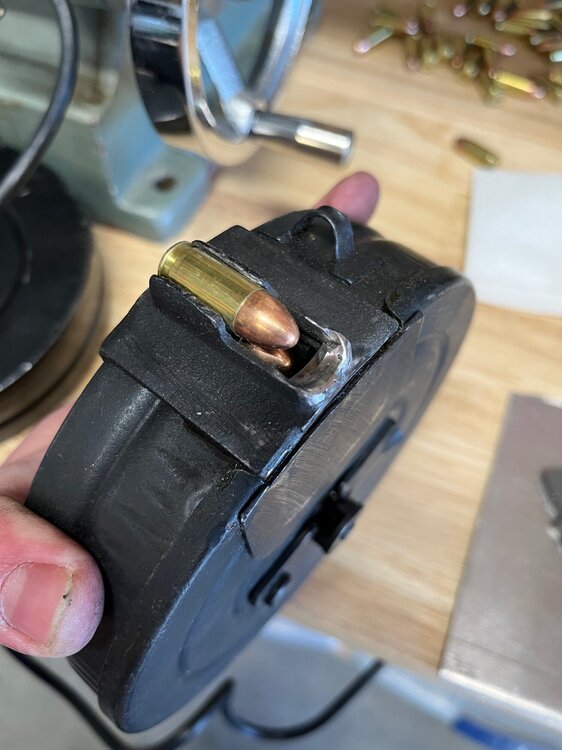

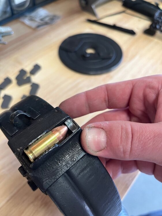

Connor Posted May 8, 2024 Report Share Posted May 8, 2024 (edited) I too have nosediving issues in drums and stick mags. This was my solution for the drums. I drew up a quick .187 spacer that fit the profile of the feedlip, had a local laser cutter cut these out for me with extras. Welded them in place on the drum, and dremelled the feed ramp back to the point that looked right. I chambered about a dozen rounds and they all fed. Planning on some testing this weekend, hopefully with some good results, it looks like it should work. I don’t quite have a solution for the stick mags yet b/c you can’t weld spacers from the inside of the stick mag like you can with the drums. This spacer also doesn’t interfere with the drum follower… it would interfere with a stick mag. if they work, I’ll drop the file here incase anyone else wants to do the same thing. Edited May 8, 2024 by Connor Link to comment Share on other sites More sharing options...
Rekraps Posted May 8, 2024 Report Share Posted May 8, 2024 7 hours ago, Connor said: I too have nosediving issues in drums and stick mags. This was my solution for the drums. I drew up a quick .187 spacer that fit the profile of the feedlip, had a local laser cutter cut these out for me with extras. Welded them in place on the drum, and dremelled the feed ramp back to the point that looked right. I chambered about a dozen rounds and they all fed. Planning on some testing this weekend, hopefully with some good results, it looks like it should work. I don’t quite have a solution for the stick mags yet b/c you can’t weld spacers from the inside of the stick mag like you can with the drums. This spacer also doesn’t interfere with the drum follower… it would interfere with a stick mag. if they work, I’ll drop the file here incase anyone else wants to do the same thing. Quite nice work! Link to comment Share on other sites More sharing options...
Roland the Thompsongunner Posted June 4, 2024 Report Share Posted June 4, 2024 That is a great idea will have to try it Link to comment Share on other sites More sharing options...
Rekraps Posted June 6, 2024 Report Share Posted June 6, 2024 I just thought about this, your guide piece is only centered on the feed ramp/lips area. What prevents the other rounds in the drum from sneaking outward, which will or may result in a blockage? Link to comment Share on other sites More sharing options...
