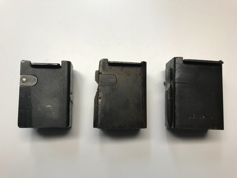

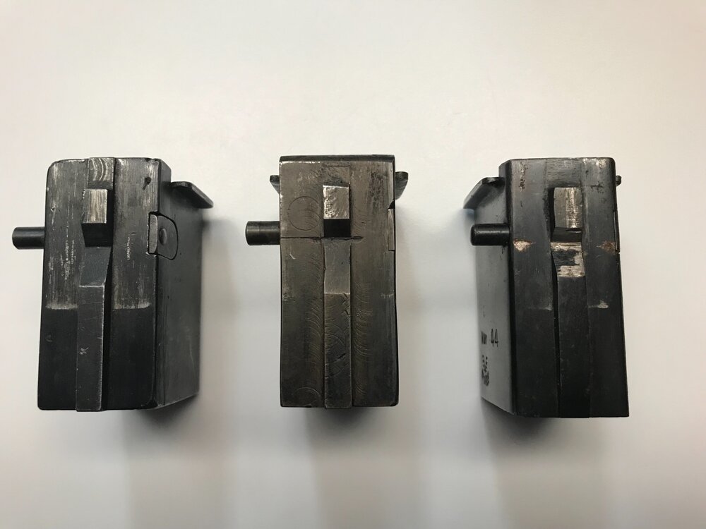

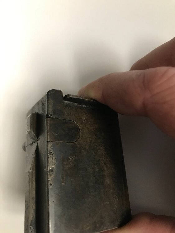

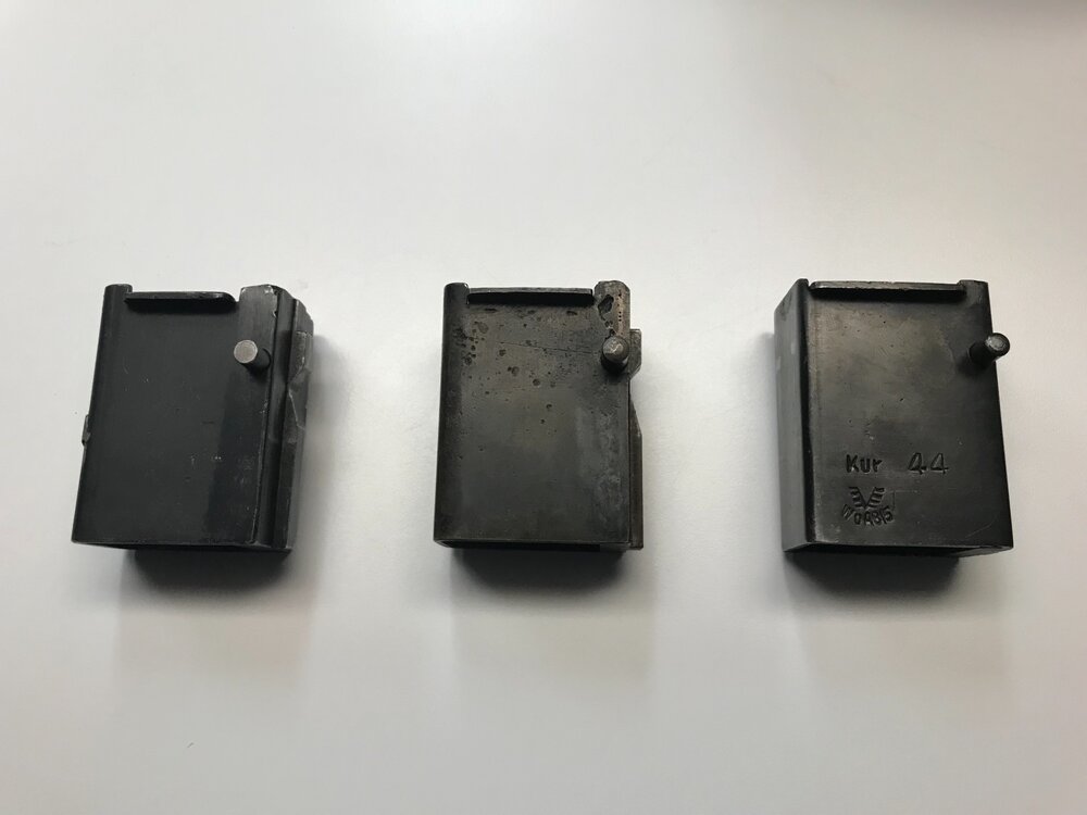

Roland the Thompsongunner Posted December 6, 2022 Report Share Posted December 6, 2022 Here are pics of three that I have. The one in the middle is original and the two others are repro I believe. The one on the left came out of Europe years ago and the one on the right is definitely repro from Royal Tiger or whatever it was before that. The one on the left needed fitting to the gun with a file. No big deal just a couple hours slowly getting it to fit without making it loose. Works great with original German mags Link to comment Share on other sites More sharing options...
Mad Machinist Posted December 7, 2022 Author Report Share Posted December 7, 2022 (edited) would you consider allowing a 48 hour onsite inspection of the original.....I'll provide a shipping lable (Fed Ex Ground insured) to me and cover return insured shipping as well. If you'd consider selling, I'd be interested as well. I want to see how they made the mag catch and installed. I can find everythig I need with just a visual inspection. But I'd really like to have one for my library of unusual stuff Edited December 7, 2022 by Mad Machinist Link to comment Share on other sites More sharing options...
Roland the Thompsongunner Posted December 8, 2022 Report Share Posted December 8, 2022 Hello, I do not want to send my original for fear of it getting lost and I am not interested in selling it. The reproduction made by Interordnance years ago is done is actually very close and was modeled off my friends gun at the time which the company inspected and took notes on a knob creek years back. They pop up for sale on gunbroker and ebay Link to comment Share on other sites More sharing options...

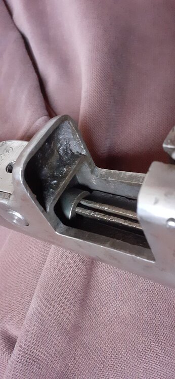

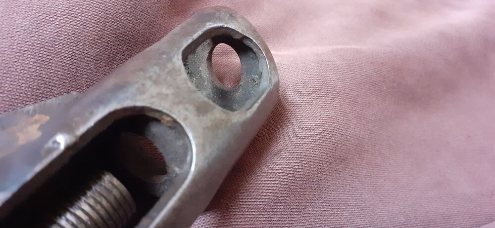

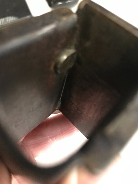

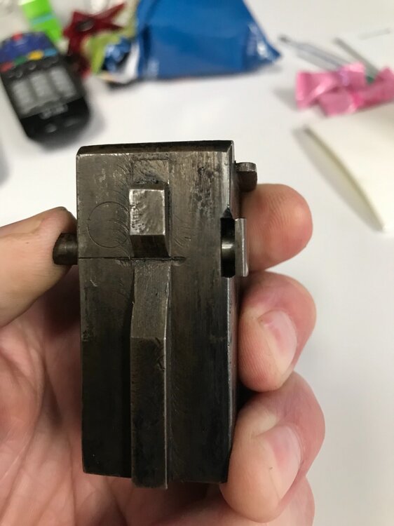

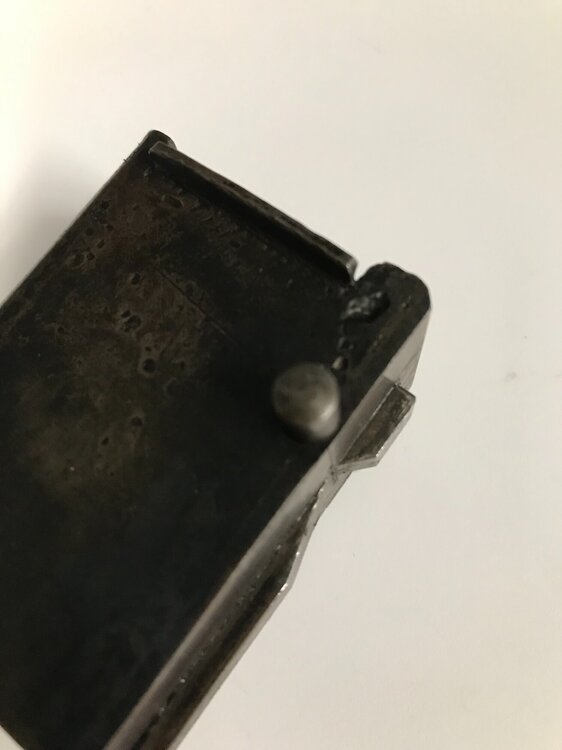

Mad Machinist Posted December 9, 2022 Author Report Share Posted December 9, 2022 (edited) Thanks for the info.......the search continues......If you could post or email me a few pictures of the inside.....I'm trying to determine the size ant type of spring used and how it is captured....Thanks in advance if you can From looking at the great pictures you supplied it appears the button/shaft is pretty slim and it just has a small spring....can you see any sign of a retaining pin.....???? Edited December 9, 2022 by Mad Machinist Link to comment Share on other sites More sharing options...
Roland the Thompsongunner Posted December 9, 2022 Report Share Posted December 9, 2022 Will get some details tonight for you and some more pics Link to comment Share on other sites More sharing options...
Mad Machinist Posted December 9, 2022 Author Report Share Posted December 9, 2022 On 12/4/2022 at 7:38 PM, BillyDixon said: years ago i got a couple of the mag adapters for the ppsh-41 to use the mp-40 mags from IMI , they look great and worked perfectly, price was under 100.00, possibly made in india,, these still show up,, i think you will spend a lot more to make these today, but good luck,,just sayn Check your PM's......got your package today......got all the measurements i needed and clues to how it was assembled. On the way back by Priority Mail Insured. Rudy Link to comment Share on other sites More sharing options...
Roland the Thompsongunner Posted December 10, 2022 Report Share Posted December 10, 2022 Link to comment Share on other sites More sharing options...
Roland the Thompsongunner Posted December 10, 2022 Report Share Posted December 10, 2022 I see you got one to look at that is great. Looks to me like the pin is tapered inside and the spring is internal and on the other side the mag catch is pressed in place and that holds it all together Link to comment Share on other sites More sharing options...
Mad Machinist Posted December 10, 2022 Author Report Share Posted December 10, 2022 (edited) 8 hours ago, Roland the Thompsongunner said: I see you got one to look at that is great. Looks to me like the pin is tapered inside and the spring is internal and on the other side the mag catch is pressed in place and that holds it all together The button is definitely a reduced diameter internal......that retains the spring....can't tell if threaded with a cap or just pressed together but the way the body is welded together I'm betting one or the other as any other way would have resulted in the spring being annealed during assembly. As replicas exist, no need to do it again after seeing one.....I'm looking more at functional new designs that use available magazines to improve life for builders and for registered owners that want to drop in a 9mm barrel and run reliably. Edited December 10, 2022 by Mad Machinist Link to comment Share on other sites More sharing options...

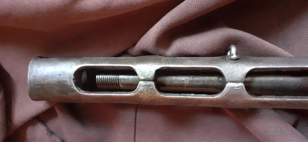

StrangeRanger Posted December 11, 2022 Report Share Posted December 11, 2022 The third picture shows the end of the button where it fits into the release catch. No sign of brazing and a press fit seems inappropriate for the application. Possibly screwed? Link to comment Share on other sites More sharing options...
Roland the Thompsongunner Posted December 11, 2022 Report Share Posted December 11, 2022 You could come up with different ways to make the adapter easier to produce. I saw one years back someone made that used sten mags. I have a mag that someone welded the top of a russian mag to a 9mm mag. I have a 50 round coffin Suomi mag modified for my gun also Link to comment Share on other sites More sharing options...

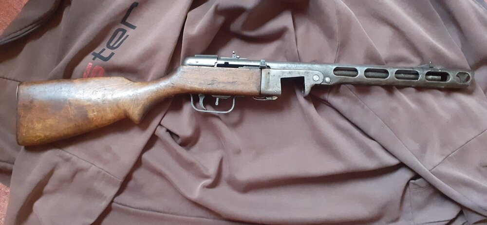

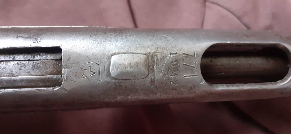

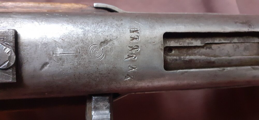

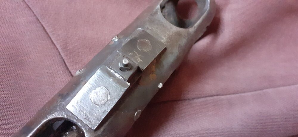

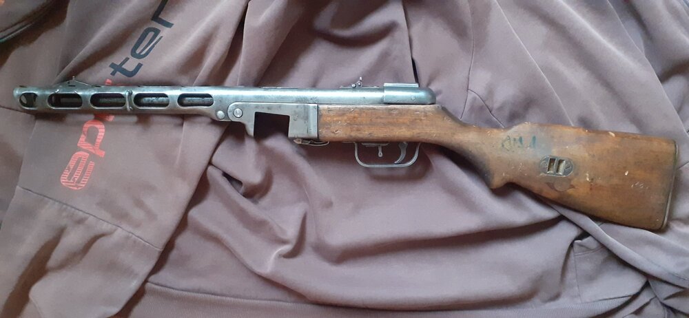

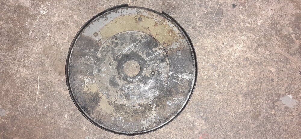

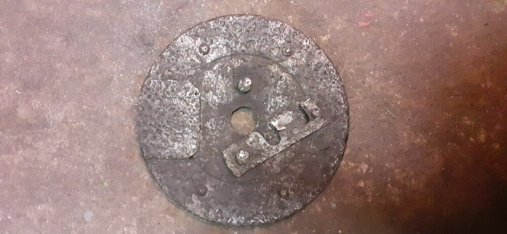

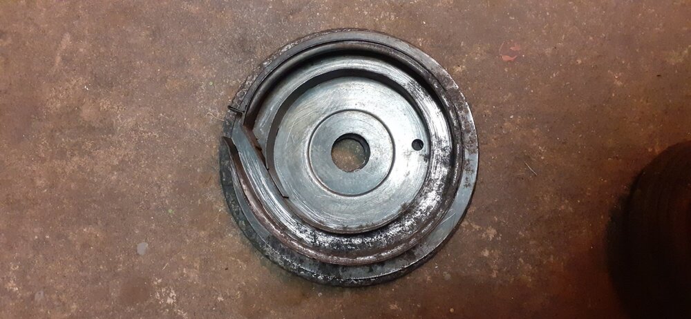

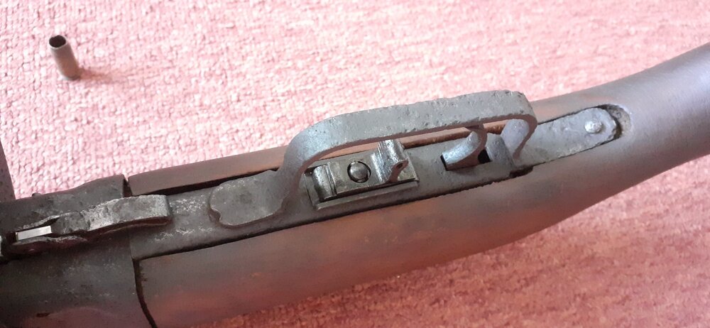

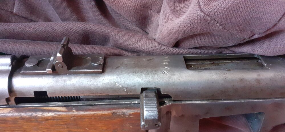

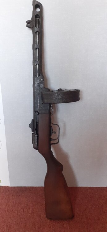

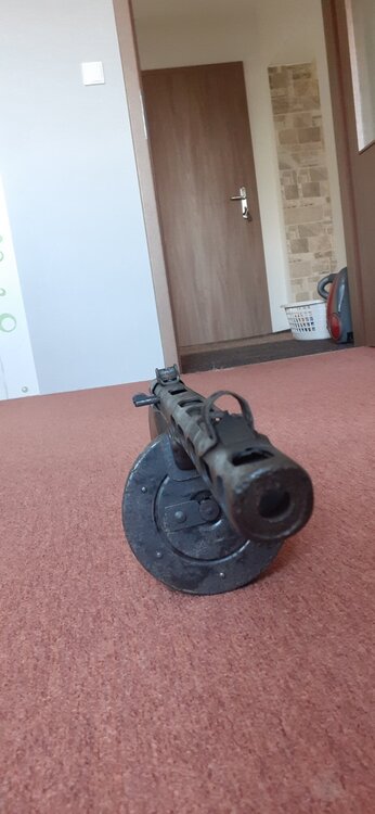

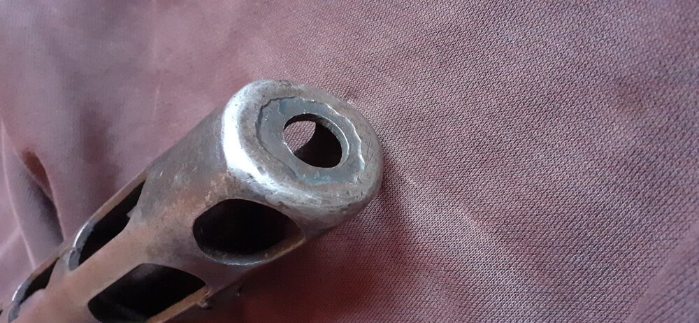

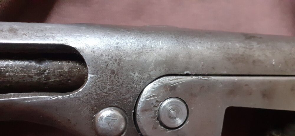

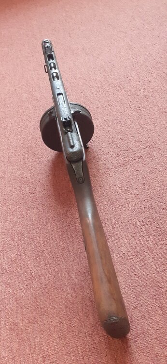

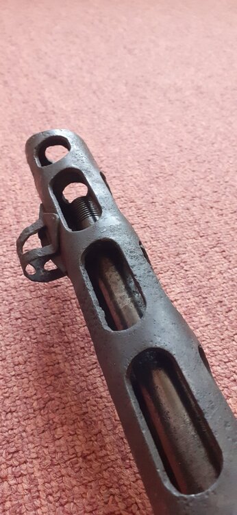

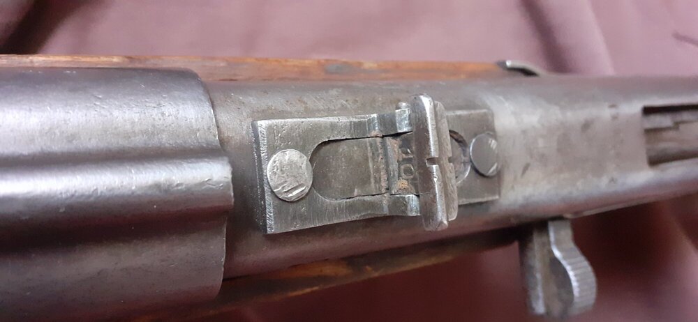

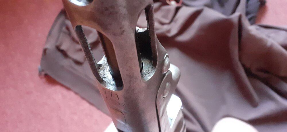

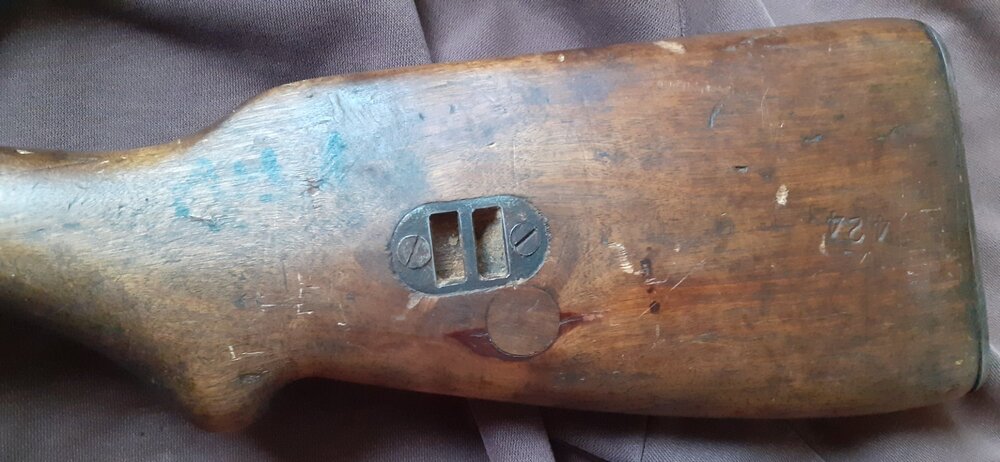

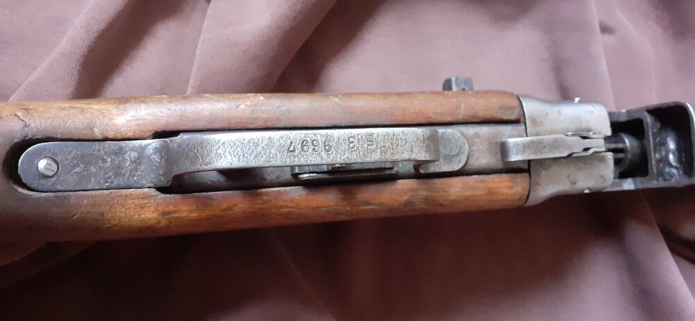

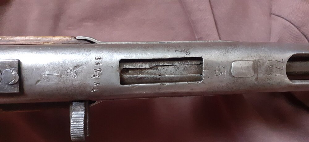

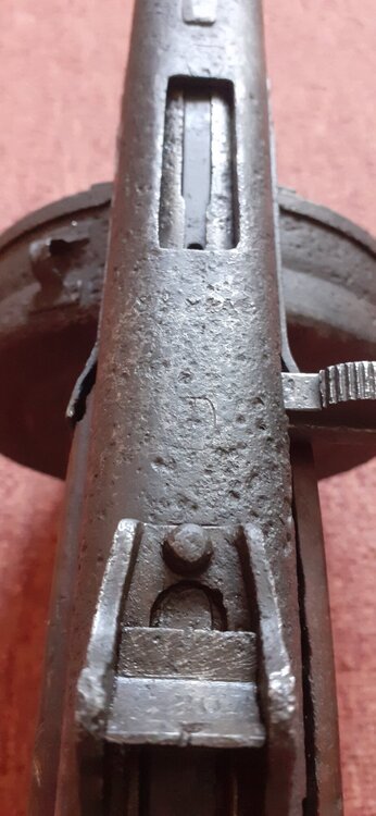

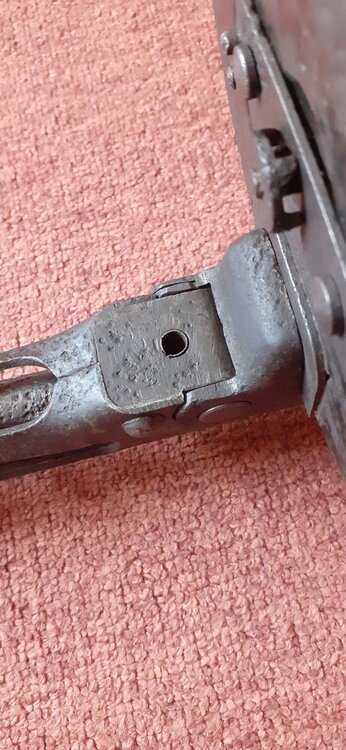

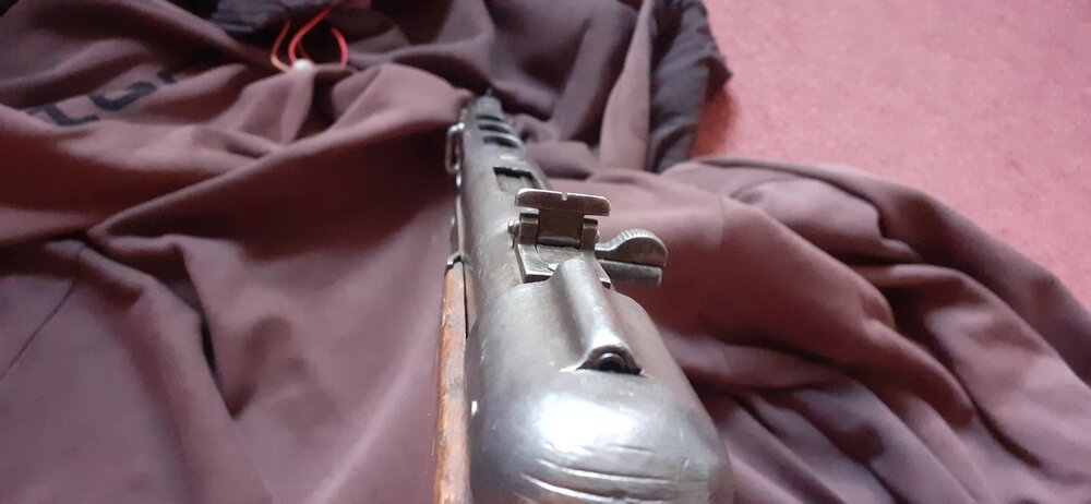

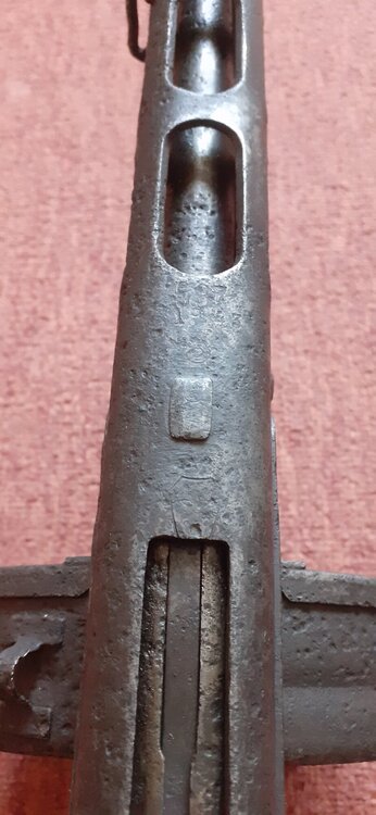

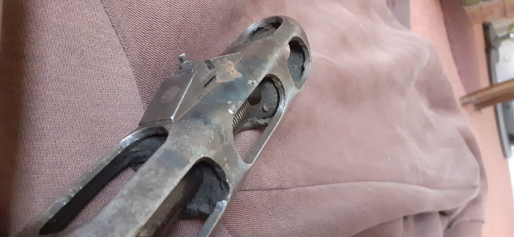

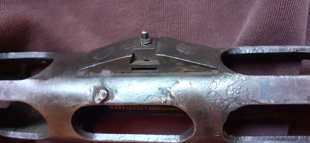

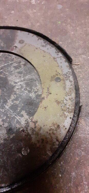

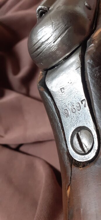

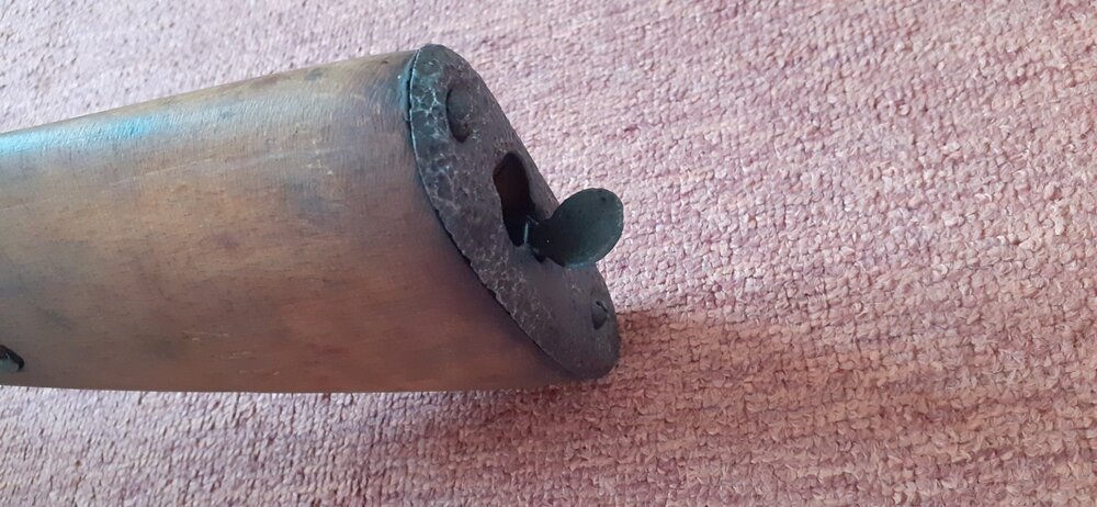

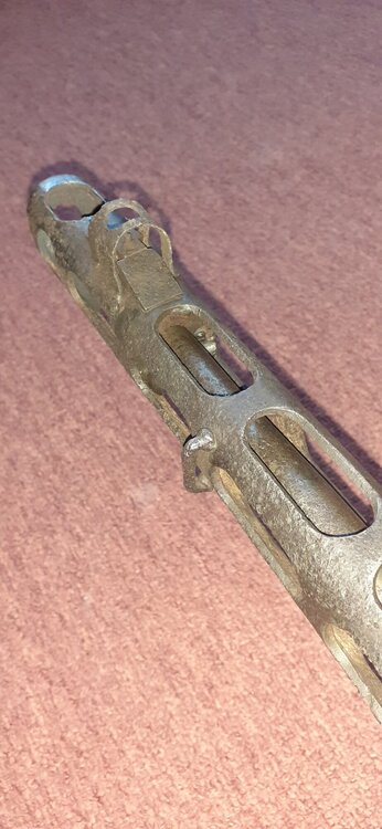

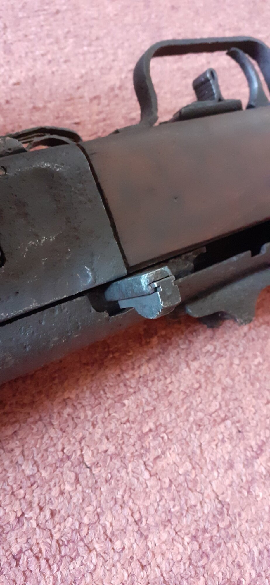

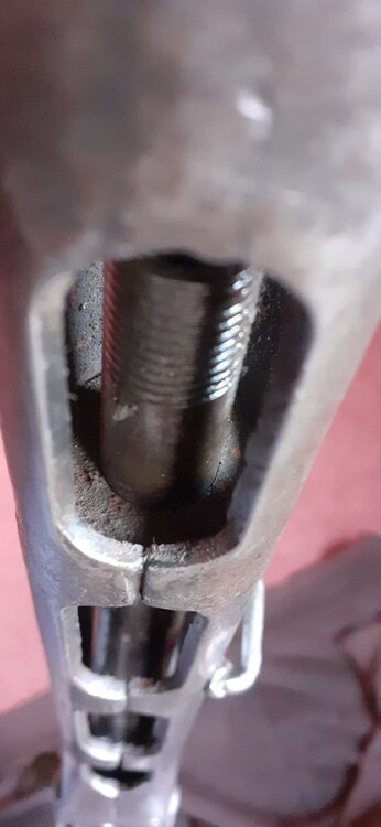

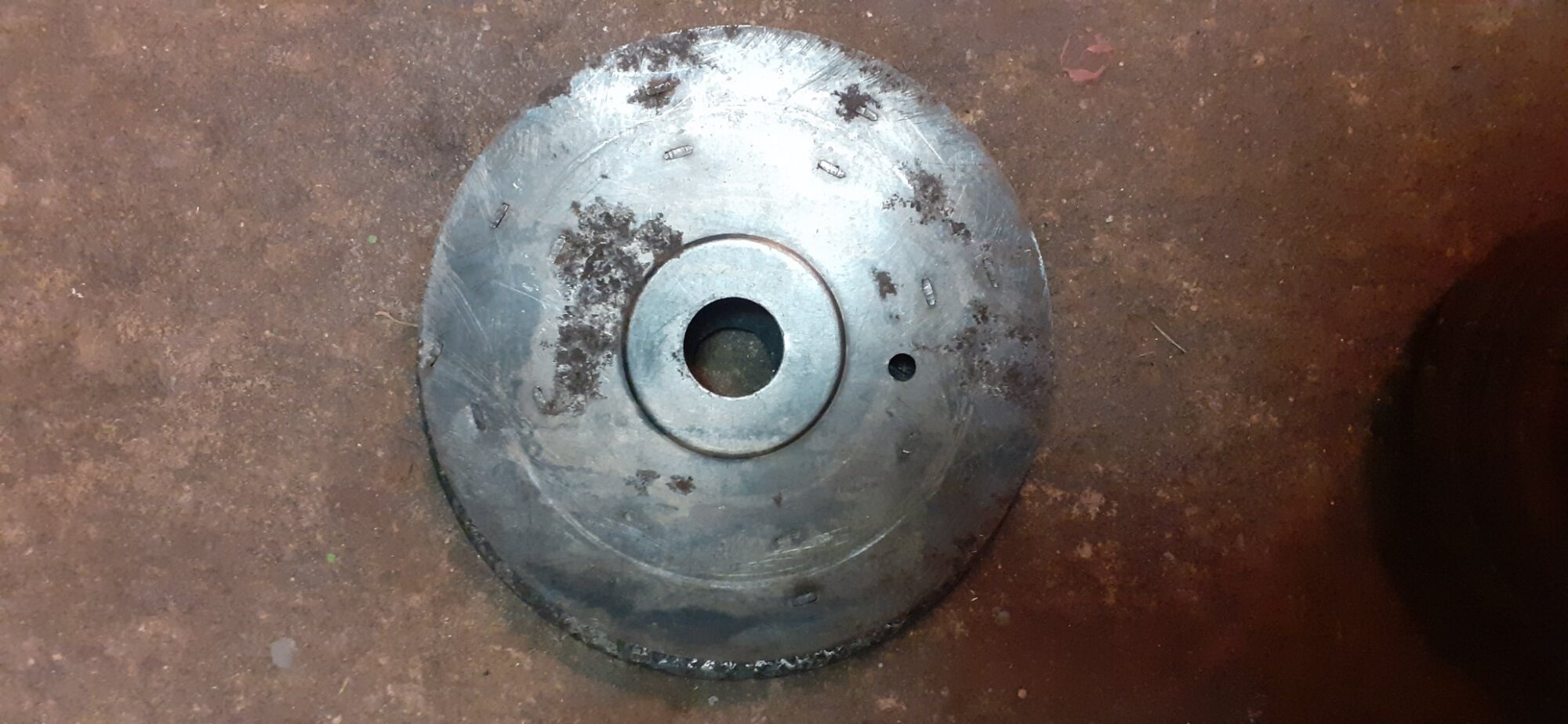

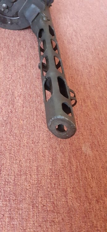

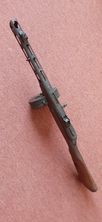

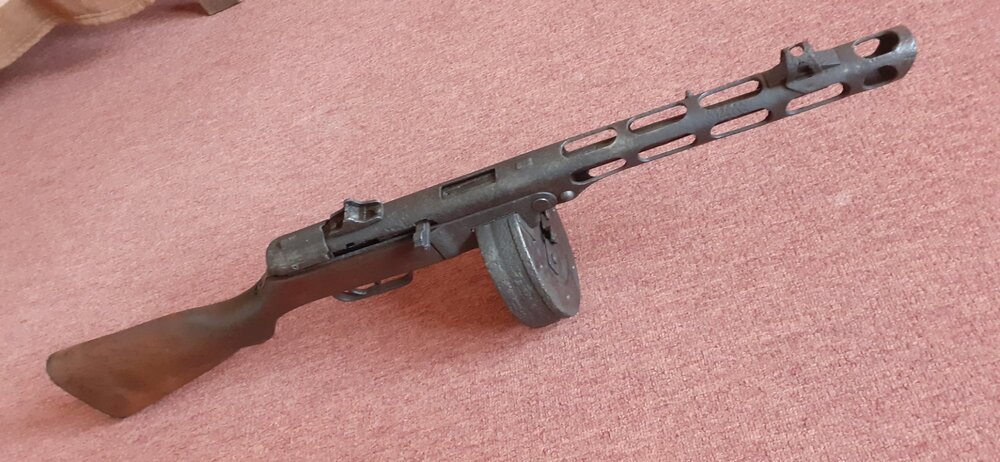

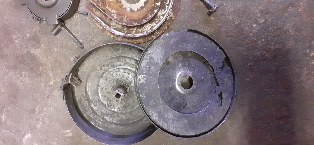

HeinrichM Posted June 20 Report Share Posted June 20 Hello to this great forum. I would like to share with you some interesting photos of the original M.P. 41(r) or perhaps M.P. 717(r)? The German document with the designation of this type is somewhat confusing. The relic in the photos comes from a war find, which contained a total of 20 pieces of MP 41r including original drum magazine conversions - some of them in unfinished condition. Among those 20 pieces of converted MP 41r were almost all production versions of Soviet PPSh from 41 with tangential sight to models 44 with frame with ears. All conversions were marked "D", had the original Soviet S/N defaced and the new S/N stamped in a much larger number font. Unfortunately, not a single adapter for the MP 40 magazine was present, but the conversion of the original drum magazines brings new light to the knowledge... Link to comment Share on other sites More sharing options...

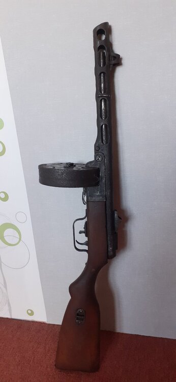

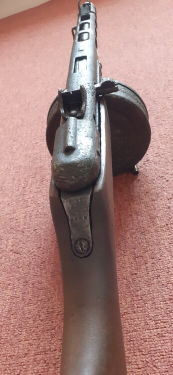

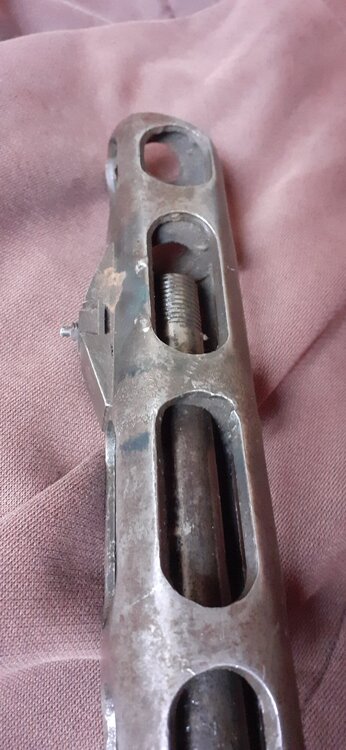

HeinrichM Posted June 20 Report Share Posted June 20 A relic from a war find... Link to comment Share on other sites More sharing options...

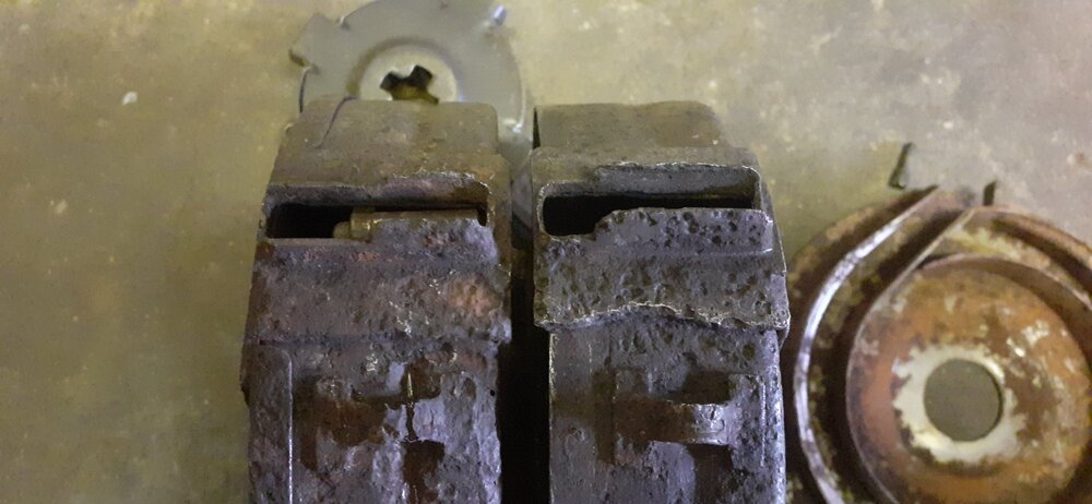

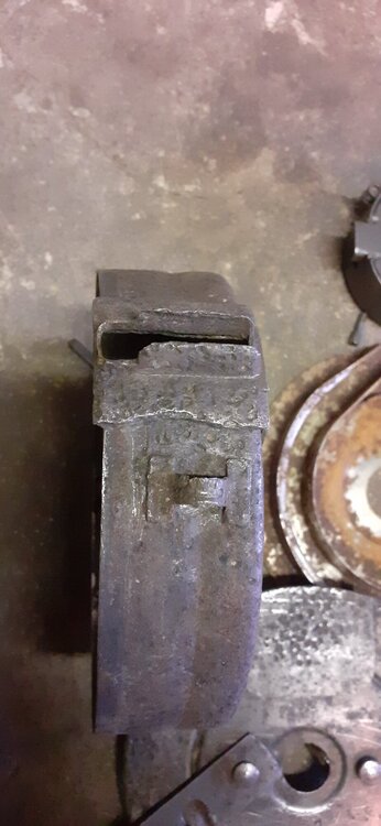

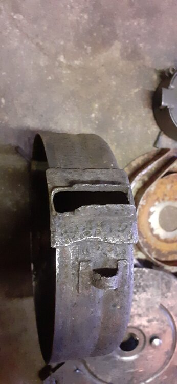

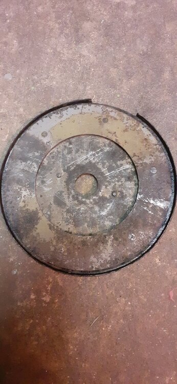

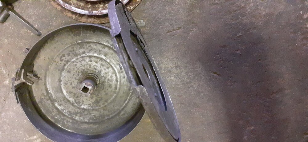

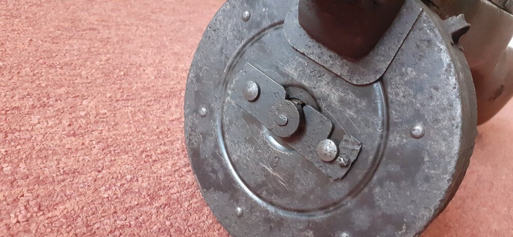

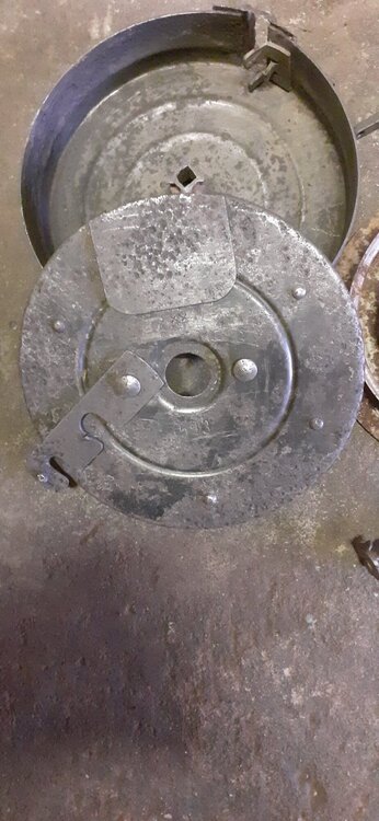

HeinrichM Posted June 20 Report Share Posted June 20 Original drum magazine conversion from a war find... Link to comment Share on other sites More sharing options...

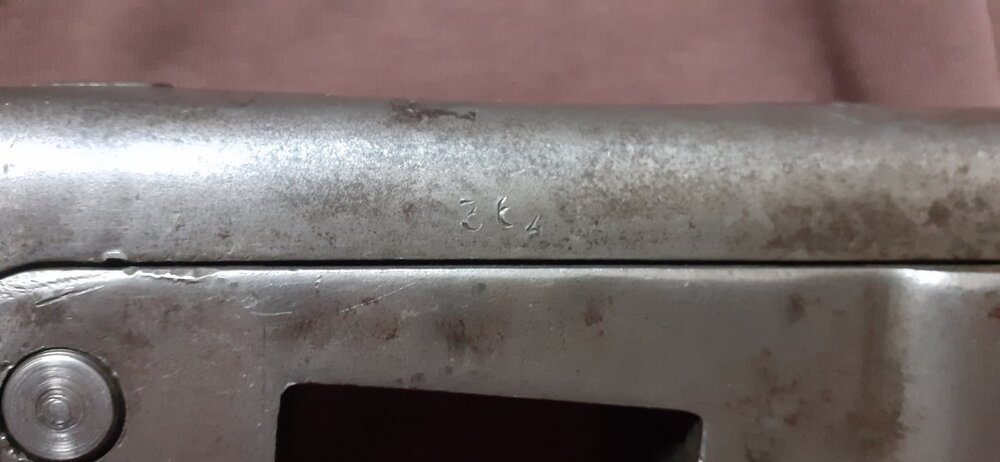

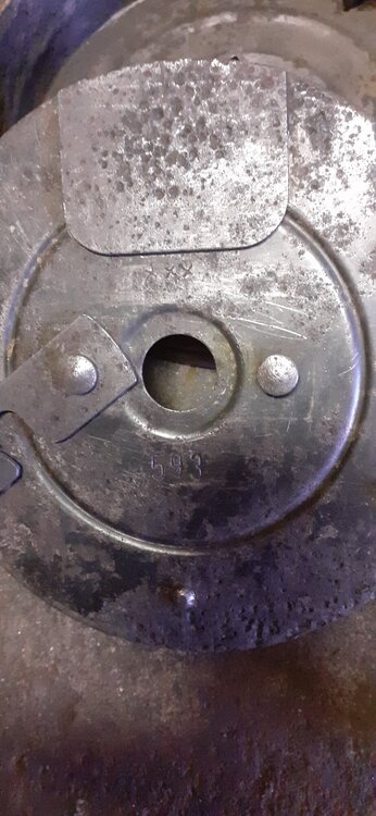

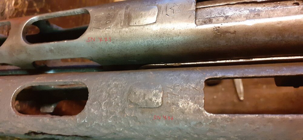

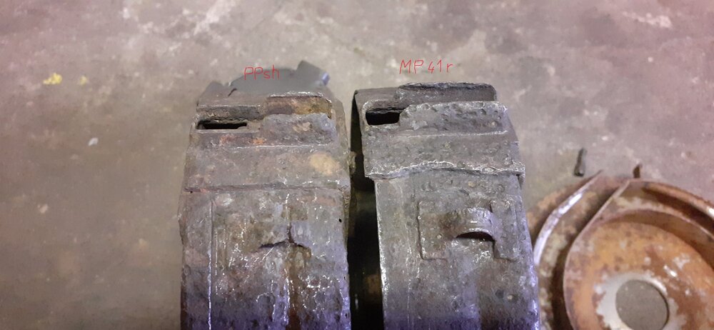

HeinrichM Posted June 20 Report Share Posted June 20 And here's one interesting thing......both pieces, despite their different fates, are separated by only a few numbers from the production line. Same number die font... Above originally No.367 NKV (Zagorsk /Vyatskie Polyany) Down originally "Iskra" factory of the Moscow city council Link to comment Share on other sites More sharing options...
Roland the Thompsongunner Posted June 22 Report Share Posted June 22 Those pictures are great and I had no idea that drum magazines were modified to make them more reliable. Longer feed lips and inside spacer. Thanks for sharing I think I’m going to have to make a modified drum at some point. Good winter project! Link to comment Share on other sites More sharing options...
