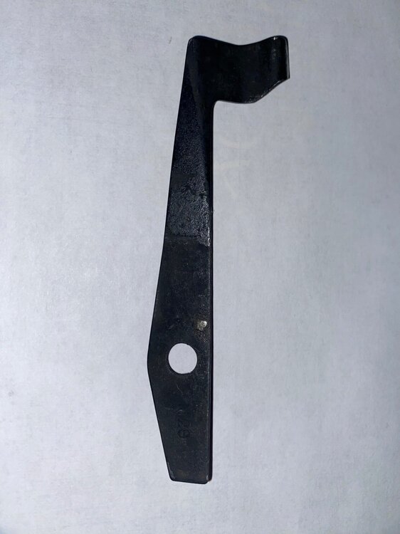

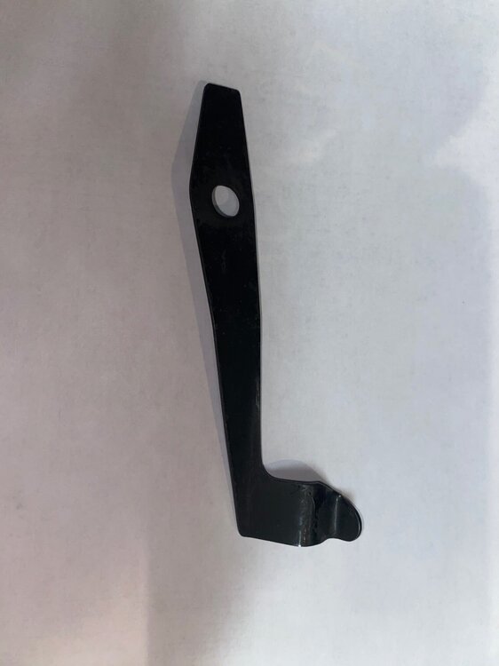

Babyface Nelson Posted December 6, 2022 Report Share Posted December 6, 2022 6 hours ago, Rekraps said: How interesting. I just happened to have an extra Lanchester stock in my gun room with this exact cutout. I was wondering what it was. There does not appear to be a fitting on the stock, nor a pre-drilled hole for the sheet metal "blocking" piece so I wonder how and where it was attached? I switched out the stocks and it fits my gun just fine, albeit with the carve out section. Does anyone out there have the blocking piece? Sir, I may have one. Wil have to check and see.... "BF" Link to comment Share on other sites More sharing options...
StrangeRanger Posted December 7, 2022 Author Report Share Posted December 7, 2022 Pictures please Link to comment Share on other sites More sharing options...

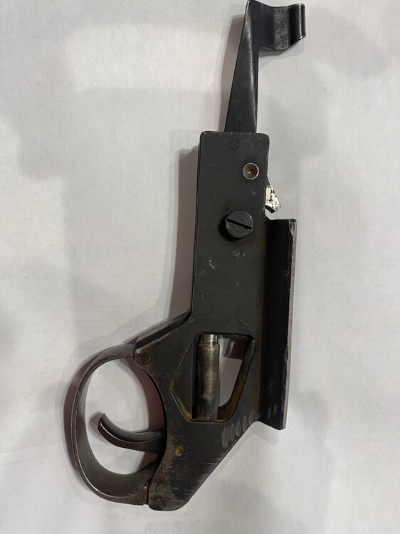

Babyface Nelson Posted December 7, 2022 Report Share Posted December 7, 2022 As requested Link to comment Share on other sites More sharing options...
Rekraps Posted December 7, 2022 Report Share Posted December 7, 2022 17 hours ago, Babyface Nelson said: Sir, I may have one. Wil have to check and see.... "BF" Ah ha! Mystery cleared up. I have several trigger groups and one has the "nut" on the side while the other does not. It is here that the blocking bar is attached. Link to comment Share on other sites More sharing options...
