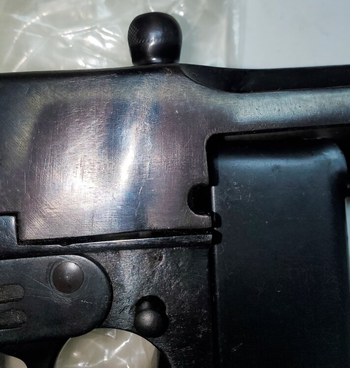

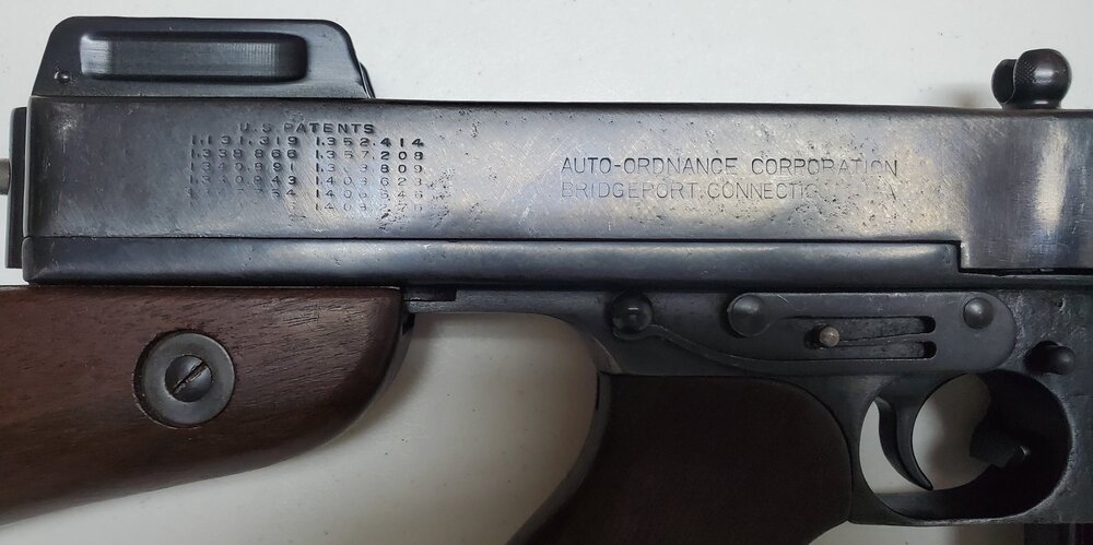

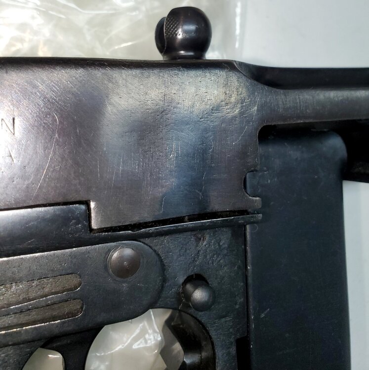

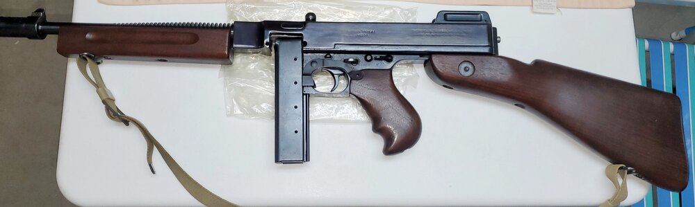

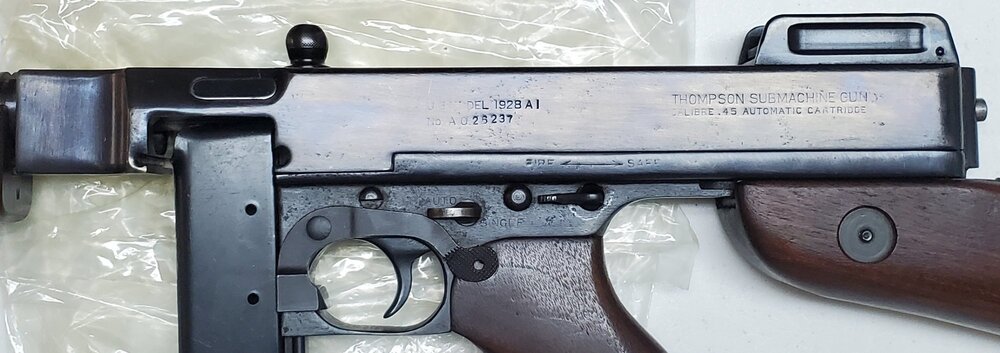

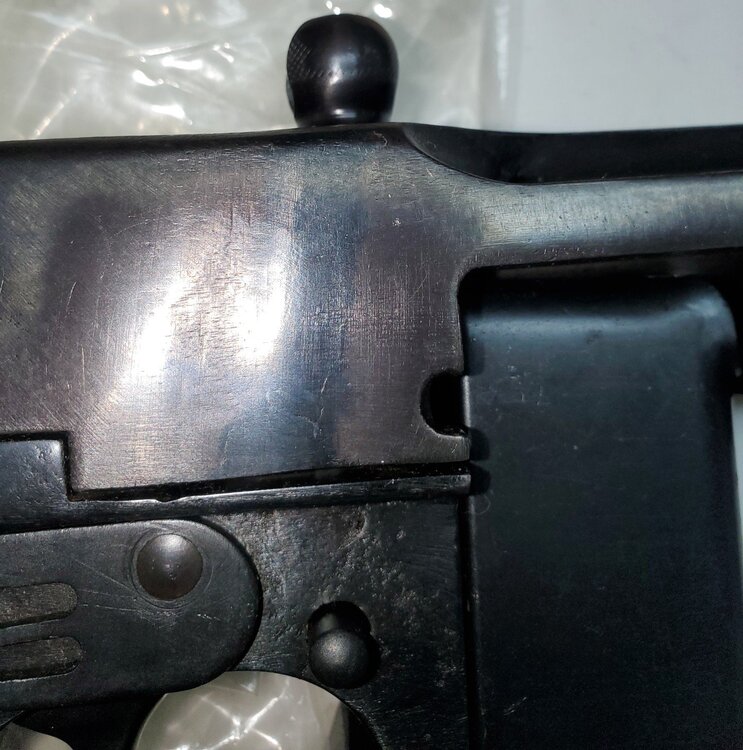

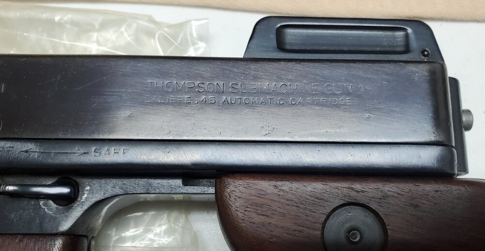

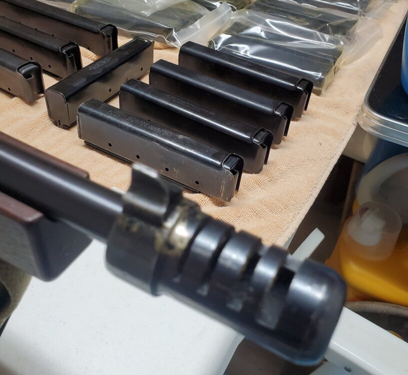

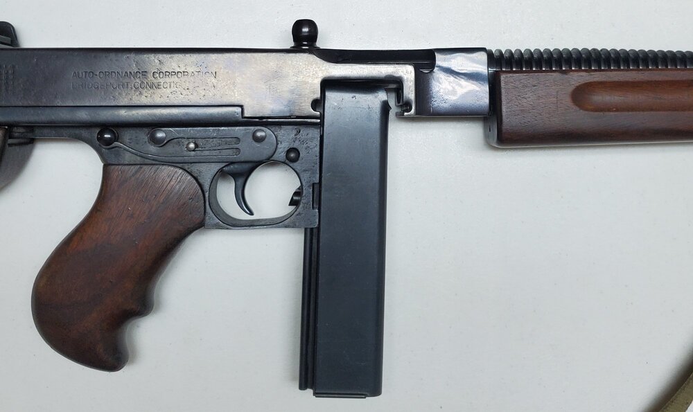

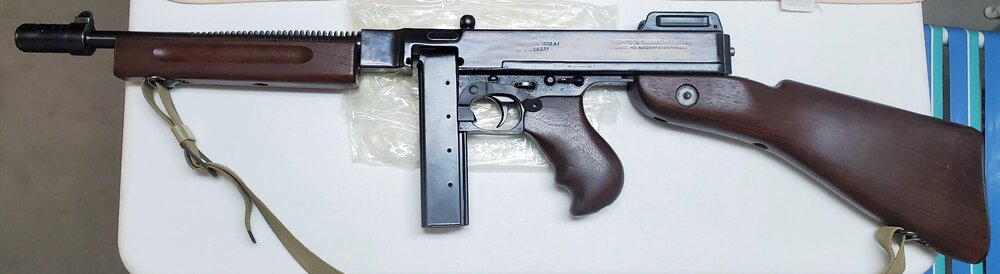

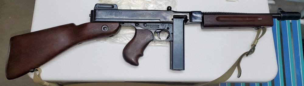

SP Sarge Posted December 7, 2022 Report Share Posted December 7, 2022 (edited) (Posted with dalberts permission) I recently flew from Pennsylvania to Arizona to meet a retiree and his wife who have a WW2 era 1928 Thompson they are parting with. The photos I had seen prior were only enough to tell it was a 1928 Thompson, but without much further detail. They were not really tech savvy with taking photos and transferring them to email so I decided to go see it in person. I wound up not purchasing the weapon because it is a re-weld (to use the common term for a receiver that was de-commissioned by cutting and then welded back together for the amnesty registration). They we’re not aware it had been welded, and I couldn’t tell from photos until I saw it in person. Sad to say for both parties, a re-weld was just not what I was looking for. However, the sellers are really nice people and I told them I’d try to at least get the word out for them that the gun is on the market. The seller was originally asking $25,000.00 for the weapon, and extra for the accessories, but I’m sure he would be open to other reasonable offers. It’s been on a Form 4 with the current owner since 2003, and the form 4 lists the manufacturer as Auto Ordnance Bridgeport, Conn. For accessories there are about 26 twenty round WW2 era mags of assorted manufacture, around 15 thirty round WW2 era mags of assorted manufacturer, some GI canvass pouches and web belt, and a “U” stamped WW2 era 50 round drum. It is in the early serial number range for Bridgeports’ (26237) and does have a finned barrel and flip up Lyman rear sight being correct for that period. The rifling of the barrel appeared good. The weapon does not have its original finish, and instead has been polished and blued. I’d say most of the usual proof marks you look for on a WW2 era Thompson have been buffed out when it was polished or fell victim to the welds. I was able to see a faint “WB” proof mark on the left side of the receiver. The lower receiver has some pitting that was cleaned and blued over. The cutts compensator appears to have been braised on rather than pinned. In the below attached photos the weld areas are depicted, which are the nose piece and the area just behind the magazine well. Again, they are really nice folks, so I’d like to help them find a buyer. If you would be interested in making an offer, please PM me and I will put you in contact with the seller. Edited December 7, 2022 by SP Sarge Link to comment Share on other sites More sharing options...

StrangeRanger Posted December 7, 2022 Report Share Posted December 7, 2022 Maybe the worst re-weld in history It's worth its value in parts which assuming that it's complete is substantial but nowhere near what they aspire to Link to comment Share on other sites More sharing options...

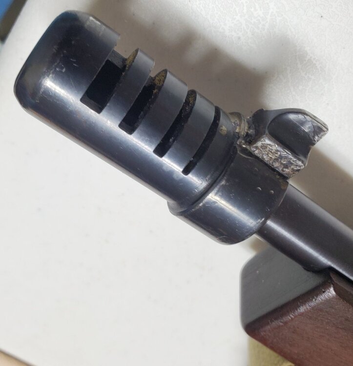

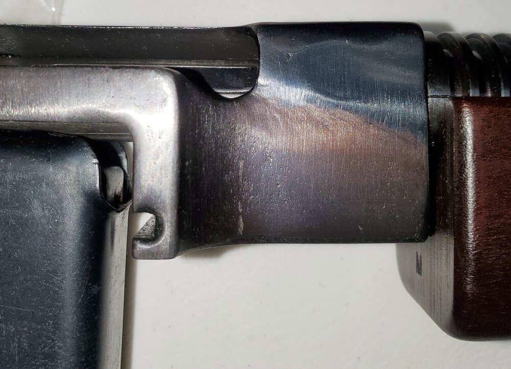

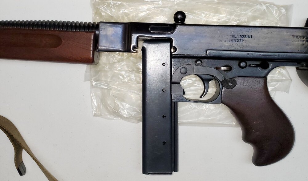

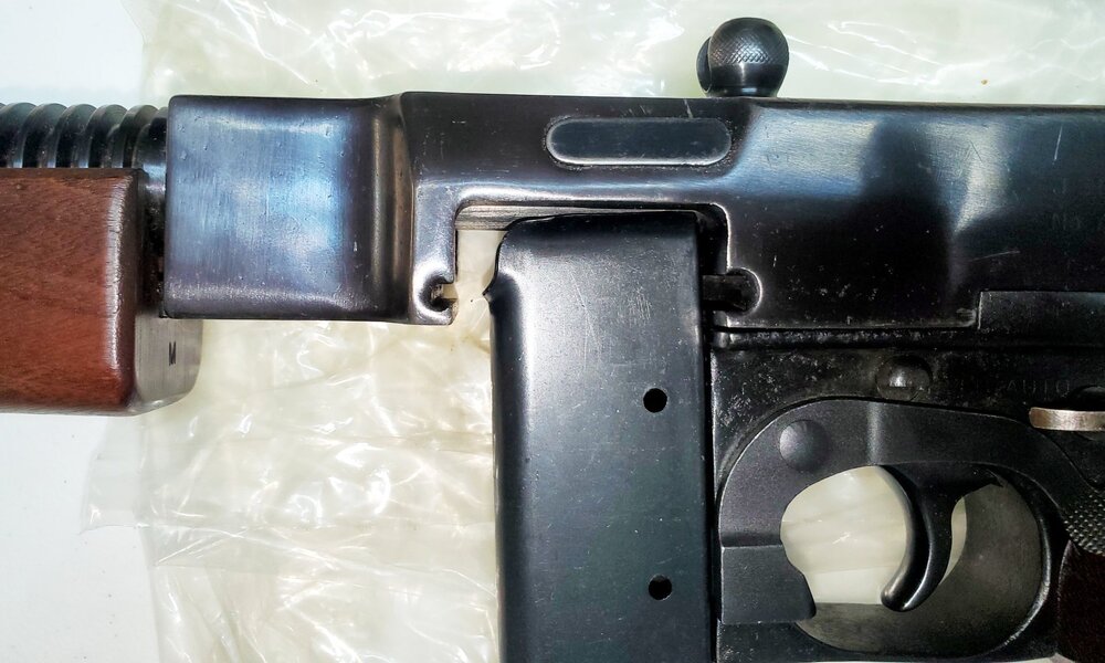

Mike Hammer Posted December 8, 2022 Report Share Posted December 8, 2022 I don’t know if you could call that poor gun even a shooter. It doesn’t even look like a square reweld, look at the angle of the upper with the magazine installed,it doesn’t look like a 45 degrees angle. I wouldn’t touch this one with the proverbial 10 footer. Link to comment Share on other sites More sharing options...

mgvince Posted December 8, 2022 Report Share Posted December 8, 2022 The only thing you could say good about that gun, is that it's on the registry. I wonder how it functions. That receiver is definitely out of square. Looks like it has a twist also. Would need some serious work to get it right. Everything about it is bad. The buffing, pitting, comp. Wow. The list just goes on. Thats quite the interesting safety lever. Amazing what you can do with a file. Look at the hole in the right side of the frame for the mag catch. I think $15k would be Too much. But someone uninformed will buy it. Link to comment Share on other sites More sharing options...

Varminter Posted December 8, 2022 Report Share Posted December 8, 2022 The upper looks too long, jacking the upper part of the magazine forward. Is one allowed to cut the rearward (NFA keeper portion) off and do a reweld with a straight front portion? Or does demilling require the upper to be cut into three pieces, putting you back somewhat at square one? SP Sarge should be able to find an M1 or M1A1 for low 20's. Mine was 20K and shoots well. I built a home range just to shoot it often. I have no idea how public, private , and indoor ranges treat such firearms. Wish the sellers luck. Link to comment Share on other sites More sharing options...

Doug Quaid Posted December 22, 2022 Report Share Posted December 22, 2022 (edited) The problem with this gun isn't that it's a reweld, the problem is that it's AWFUL. This gun represents the very bottom of the Thompson collecting totem pole. The only way to go lower is to find an even more pitted and out-of-spec reweld. Even the front sight was peened out of shape by the meathead who built it. $25,000 is possible only if they get lucky and come across a buyer who is completely clueless and has no idea at all how to price a Thompson. Which describes the current owners. They bought the thing, even though it's horrendous, and they think that $25k is a good price for it. Edited December 22, 2022 by Doug Quaid Link to comment Share on other sites More sharing options...
Doug Quaid Posted December 22, 2022 Report Share Posted December 22, 2022 On 12/7/2022 at 11:51 AM, brveagle said: I've not been in the game long enough to know how much a reweld drops in value but i imagine it'd be a large distractor for a lot of people. Rewelds are priced as shooters, if they shoot good and the gunsmithing was done well. The big problem with this gun is the pitting and the obvious dimensional problems. The receiver is grossly out of spec. If the NFA registry was still open to new guns, this reweld would be stripped of good parts and then on to a landfill somewhere. As it is, the registration of it makes it worth maybe $10 or $12k. A $50 gun with a $10,000 piece of paper. Link to comment Share on other sites More sharing options...

Rimcrew Posted December 22, 2022 Report Share Posted December 22, 2022 They even ruined the knurling on the actuator knob. How the heck do you do that? That whole gun is a train-wreck. Link to comment Share on other sites More sharing options...
