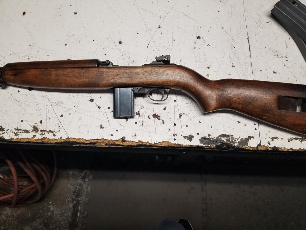

dismed Posted April 9, 2024 Report Share Posted April 9, 2024 I got a registered parts kit (trigger housing) a few years ago. Sunday I finally found some local who sold me a postal meter carbine for a host. Being unfamiliar with the gun disassembly and installation of the extra parts was a little frustrating. I ordered some KCI 30rd mags and ammo so hopefully it arrives by weekend to test fire. The hardest part for me was getting the slide off and the trip lever under the dis connector. Here she is done. Link to comment Share on other sites More sharing options...
68coupe Posted April 9, 2024 Report Share Posted April 9, 2024 "The hardest part for me was getting the slide off and the trip lever under the dis connector." Even when you know the trick and are used to removing/installing the slide, it can be somewhat tricky at times. LOL As to the trip lever, "rock" it under the disconnector, then install the switch. YMMV V/R Karl, 68coupe Link to comment Share on other sites More sharing options...

Frank I. Posted April 12, 2024 Report Share Posted April 12, 2024 Hard to control? Not really 1 Link to comment Share on other sites More sharing options...
ranger1385 Posted April 13, 2024 Report Share Posted April 13, 2024 Runs nice! Link to comment Share on other sites More sharing options...
dismed Posted April 13, 2024 Report Share Posted April 13, 2024 By the way anyone looking for .30 ammo cheaper than dirt has it for $29.95 @ box. Armscor got it in 3 days. Link to comment Share on other sites More sharing options...
texasguns67 Posted April 19, 2024 Report Share Posted April 19, 2024 Great looking BAR! Link to comment Share on other sites More sharing options...
Austringer Posted May 15, 2024 Report Share Posted May 15, 2024 (edited) Nice Mini-14, I ment M2 carbine Edited May 15, 2024 by Austringer Link to comment Share on other sites More sharing options...
