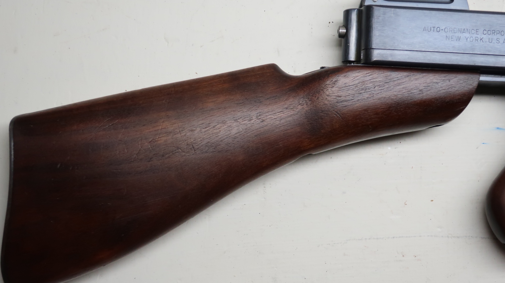

texasguns67 Posted May 20 Author Report Share Posted May 20 Here are some pictures David sent me awhile back. Thank you to all who have commented so far, I've learned a lot! Link to comment Share on other sites More sharing options...
texasguns67 Posted May 20 Author Report Share Posted May 20 More pics Link to comment Share on other sites More sharing options...

colt21a Posted May 20 Report Share Posted May 20 Looks like a Craig Jordan with a barrel job. and he never touched the stock. see how nice the grip screws are and of course flip up the lyman sites and check the four rivets. every Colt was blued under and the site added and riveted after.{was told to me by a line worker at colt who retired in 1945,} who worked on the 21 Colts. if anybody has proof otherwise that they blued them with sites on produce it please.RON K Link to comment Share on other sites More sharing options...

colt21a Posted May 21 Report Share Posted May 21 He was a master restorer in Pa. and worked for Landies under contract for a long time in his own shop in Pa not in Ohio, A real nice guy.He did #894 for me which came from Reed Knight decades ago a gangster used gun in Florida. and later on Jordan was contacted from N.R.A. TO do a duplicate 21a for display, he used #894 as a model gun for it. I am sure somebody from the display has seen it or pictured it over the years.He did many MP-40'S AND MP-38'S AND THOMPSONS,BARS AND OTHER FINE GERMAN GUNS and many a belt feed.He did my "Wild Bunch" watercool. I know many others which i won't mention here.And he also did mags and drums also, Superior Workmanship. Just as i know Doug Turnbull personally and his work besides having sold a number of Doug's guns, Another nicer guy YOU WON'T FIND IN THE INDUSTRY. more involved with the master Technique & History of the gun than the $$$ Earl had a guy also who he used who i never did meet.since i probably ran across over a 100 or so redone Thompsons. I retired in 2010.But still keep up with all the info.Like yourself you wrote a book to help the masses out there. I am a keeper of over 50 years of travels and people. and firearm deals....I know all the real well knowns .WHEN I THREW TOGETHER THAT BADLY WRITTEN JOBBLED TOGETHER THOMPSON QUEST for Tracies news letter. >Like this expose here<. and the SCARAMUZZO Thompsons.and the Chicago p.d. guns. it was not refined. It was all fun.I wish i had writing skill. And to put info down on paper Like in some book like yourself. Well it's freaking 1am I am out of chocolate milk and white castle burgers i am wearing sunglasses and Chicago is 2400 mile away. A few Colts! i like that line. You mean 1911's, Thompsons or M-16's.and many a nice AK. dozens of variants. Let's say Hundreds to keep the records correct.Have a good 2023. RON K. Link to comment Share on other sites More sharing options...
